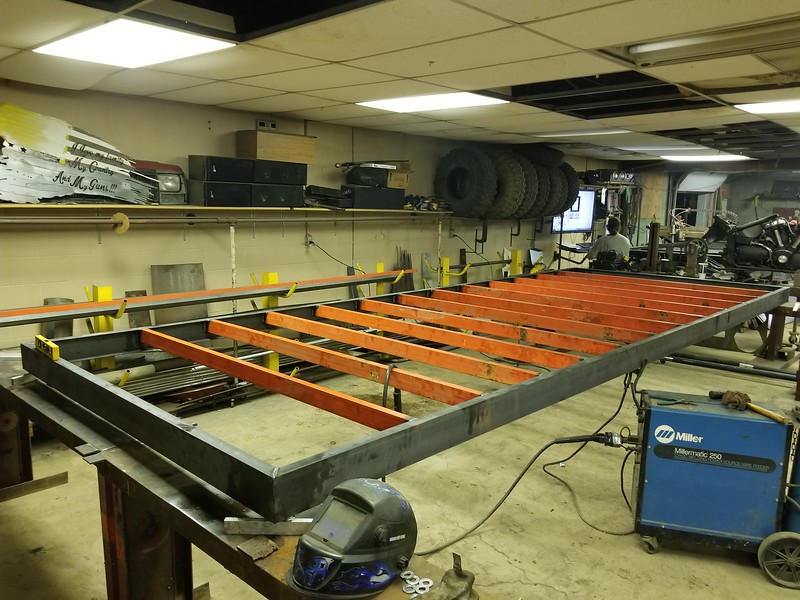

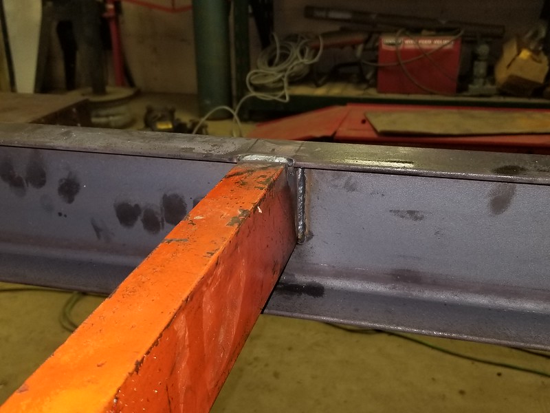

All of the crossmembers were cut and welded in last night.

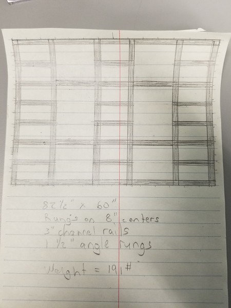

Design for the ramps/tailgate.
