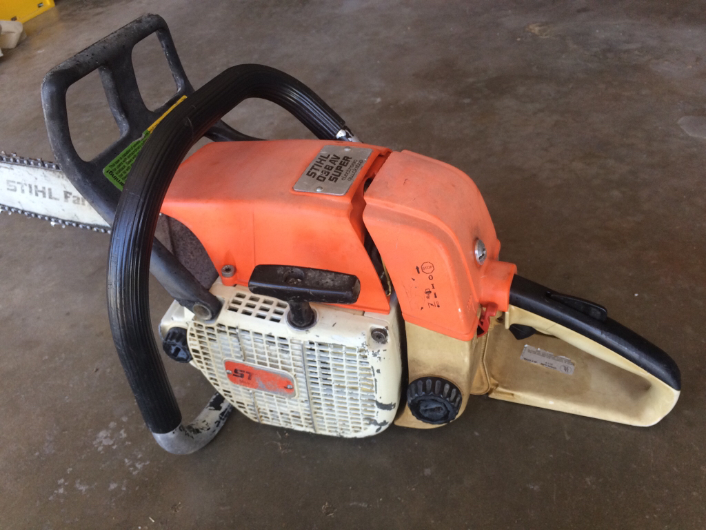

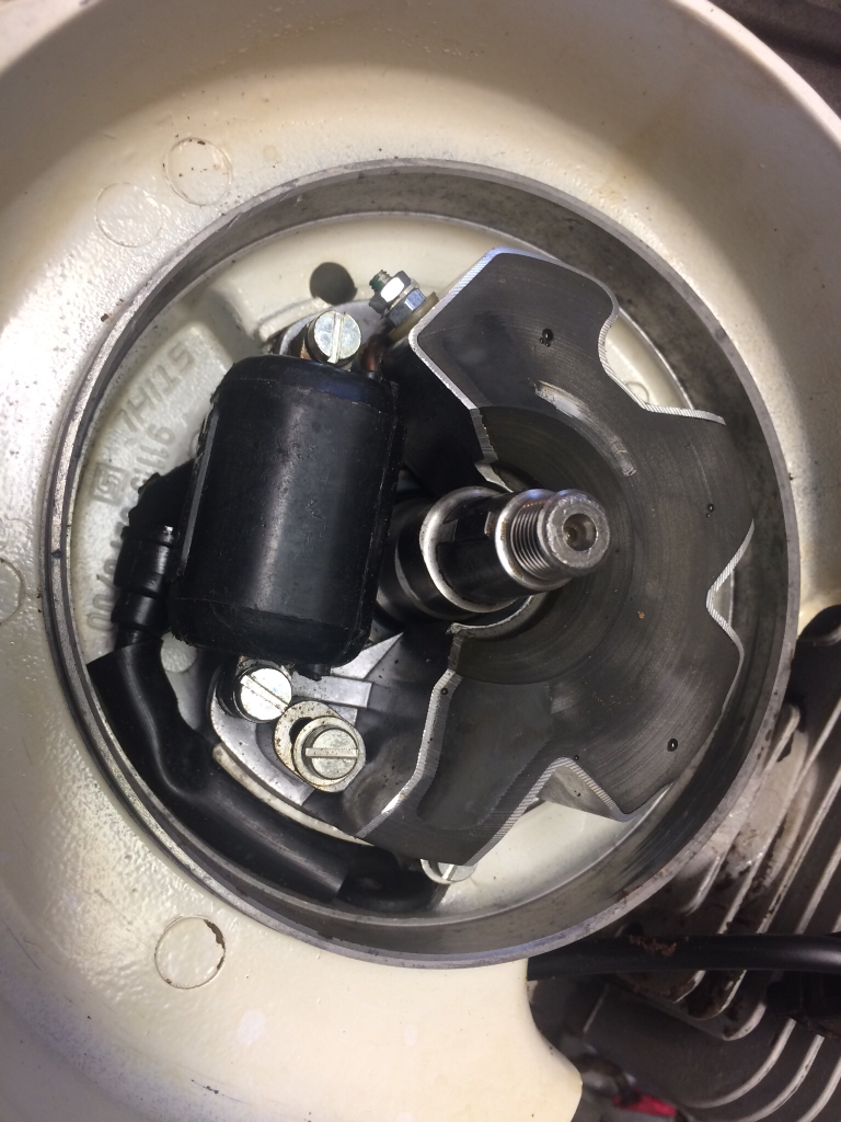

056 ave. Lost spark. Duh!!
Now on a worldwide search for 1108 400 0800.
Also used on TS350
