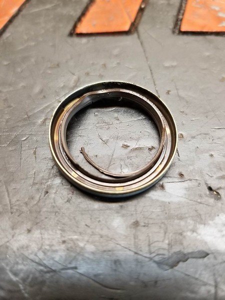

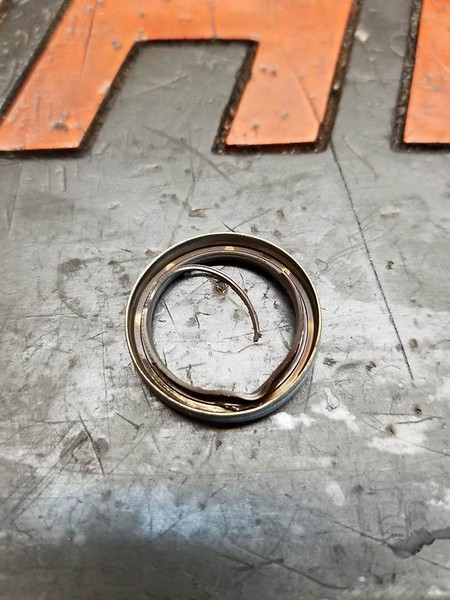

Can you say AIR LEAK!!! This is on a 346XP that I ported and has been in commercial use for several years now. I went through the saw entirely because it wasn't performing correctly. It turned out that it was no longer going to WOT as the plastic end of the throttle rod and worn off. This seal has simply worn out, and worn the sealing lip off. The P&C and ring still look like new with almost no wear at all. I didn't even replace the ring. Thankfully, the operator is very good at tuning a saw, knew something wasn't right, and quit running it before the topend was hurt!
The saw would not idle down with the leaking seal. This is demonstrating that it can now be idled down until it dies.
