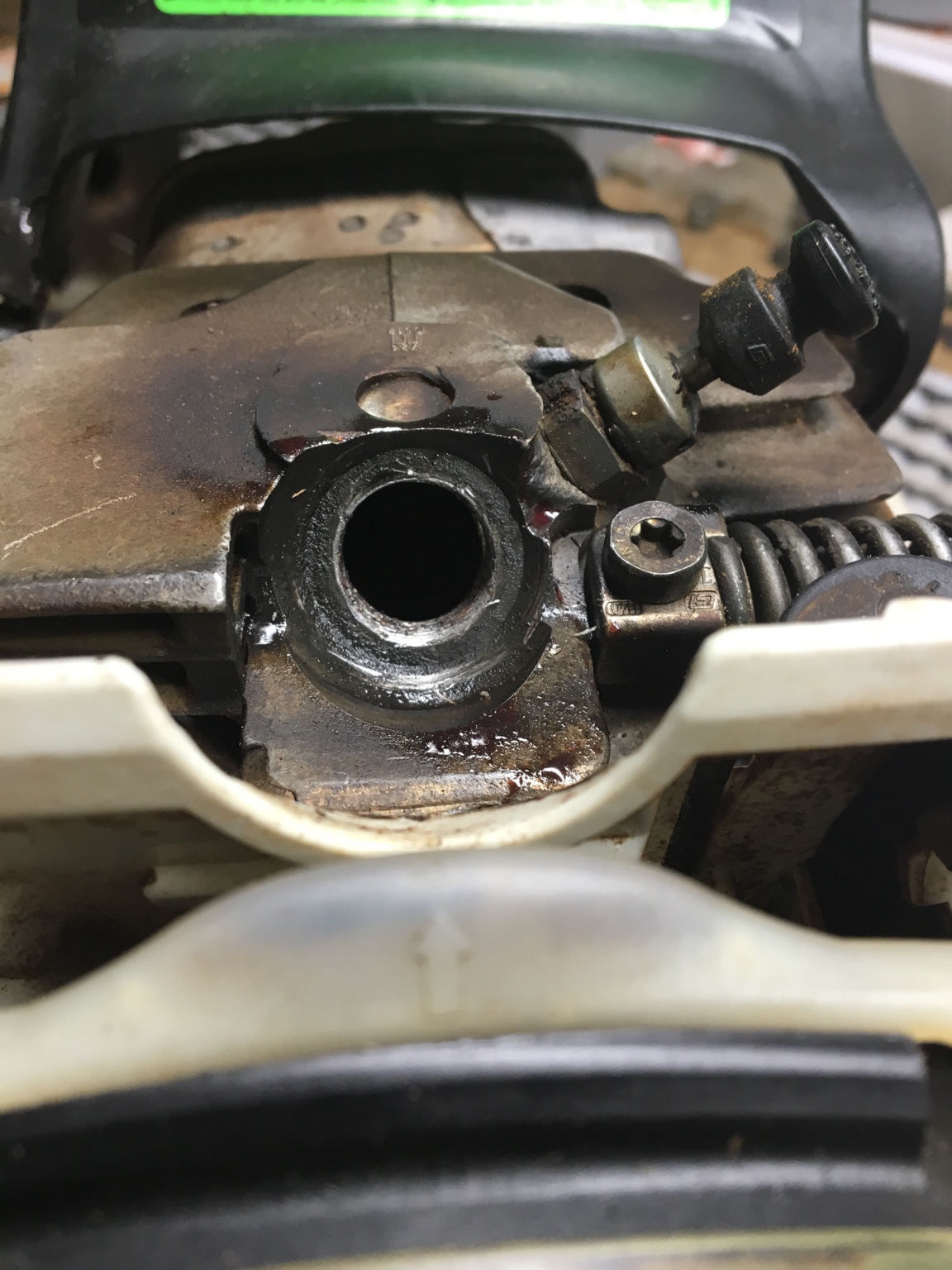

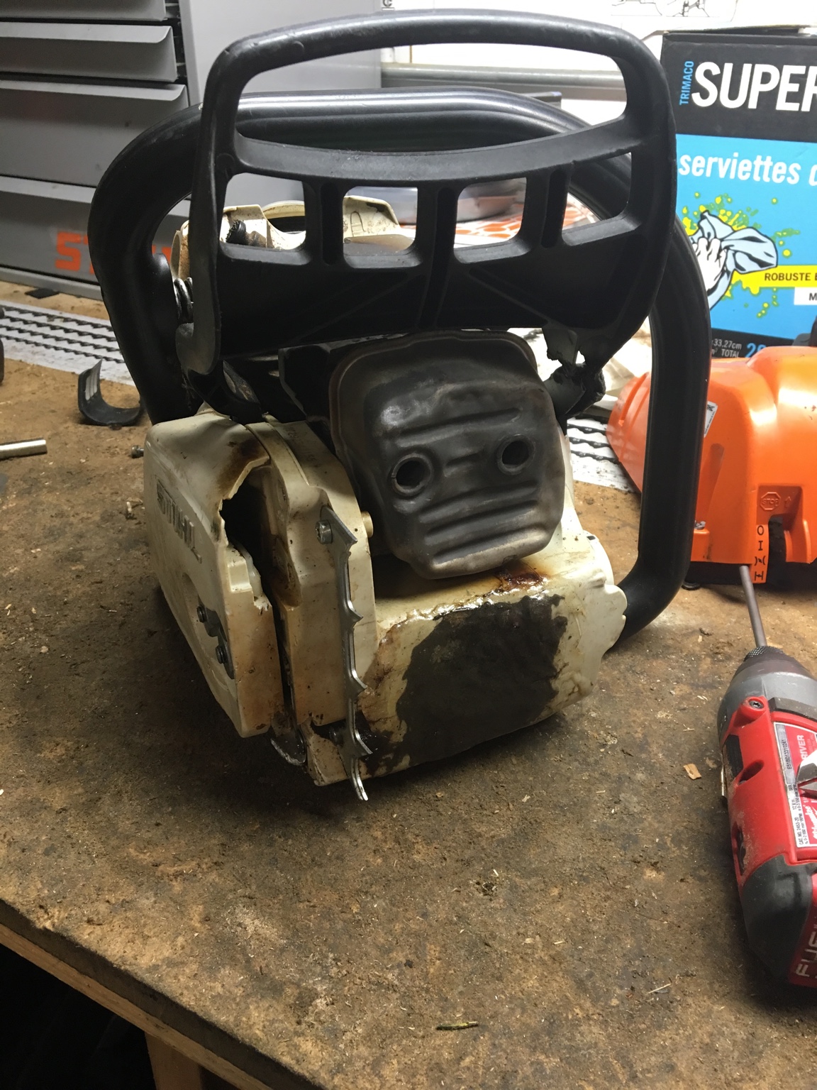

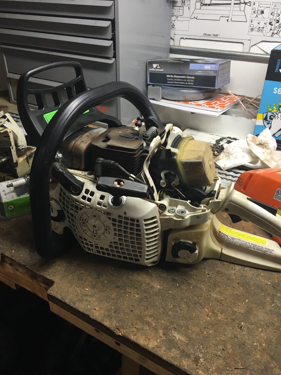

This Jem today; MS311 that has been through hell and back.
Cracked oil tank

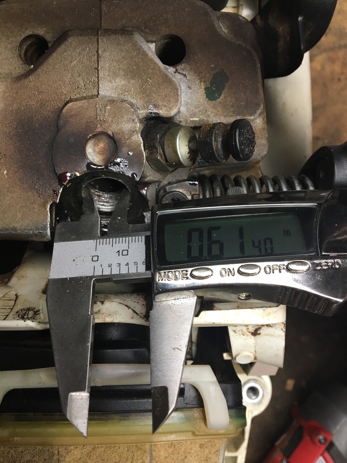

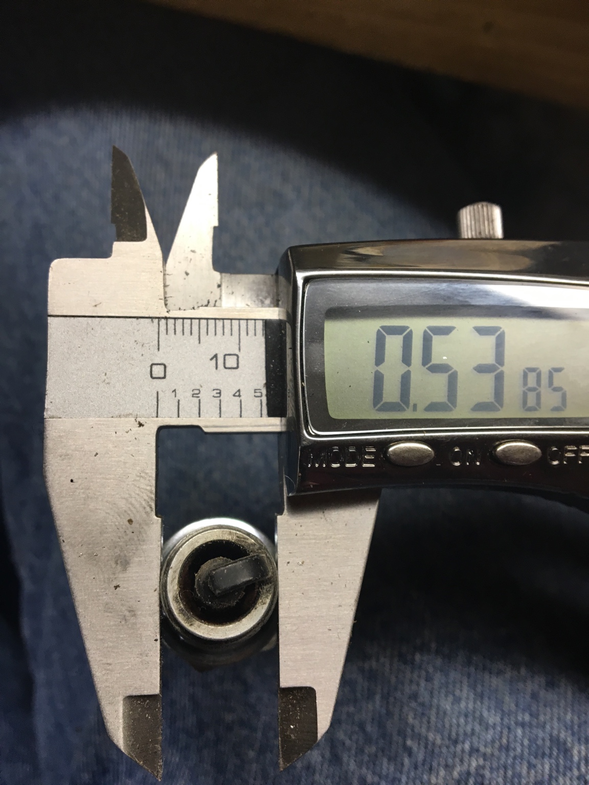

Spark plug was stripped, quoted to put a Timesert in. Guy tried to save money first and attempted two heli 's first with no success. I think I could fit a HEUI injector in there tho.
