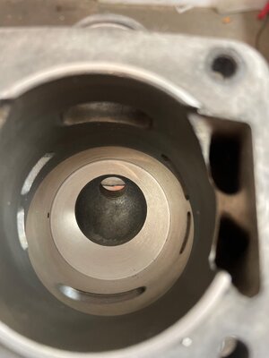

Now I’m trying to figure out why max rpms are so low…just under 13,7 @ 1 turn out each
Rebuilt carb, replacing fuel filter…might be fuel starved? Ring never seated? What should compression be?
They usually go up 10 lb after some use. Sometimes they'll get noticeably zippier just straightening out the curves and flattening bumps in all the ports, widening exhaust to the max. Can't remember where it was but @Ketchup shared some excellent thoughts on improving flow.
