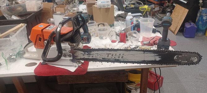

The flat top is alive :D
Runs and cuts like my old one...same motor but a RE...
Scary fast with a 28, 8t, full comp.
Oe topend, New cabers, oe 3-bolt coil, carb etc. Am muffler, modded and port matched.
Now, what to do with 2 of these, lol

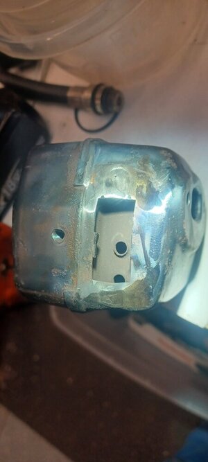

242xp muffler...
What were they thinking?
3 3/16" holes...that's it 😳
I had to cut off the entire deflector assembly to get this far. No way to remove the baffle without cutting the thing in two. I'll just drill holes, make a new deflector and call it good. Geeze...almost as bad as the 1/4" exhaust port on the 136-142 Huskys.

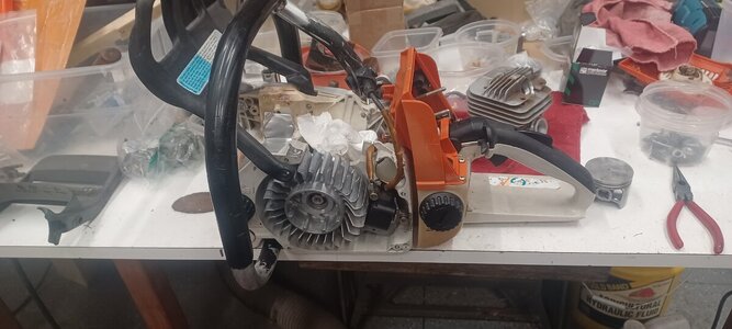

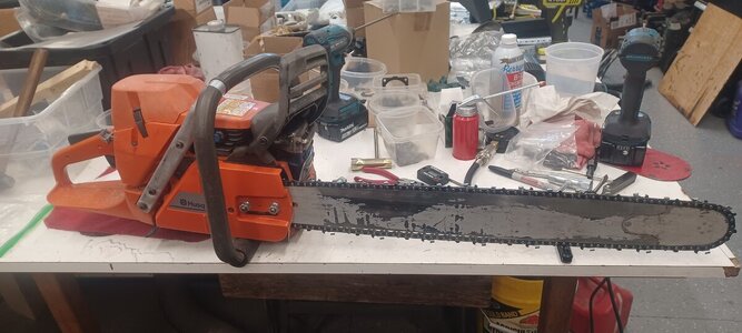

372xp build for a friend...ground-up. Runs and cuts great. Blue, limited coil, tachs to 13+.
But...comp is only 155. This was an experiment with the Duke's hard-chrome topend. Sq is .032 even with BGD so...
Minor porting consisted of widening the exhaust port, widening the transfers at the base and cleaning up casting imperfections including to the piston. No changes to port timing as I don’t have the tools or skills for that :p. Caber rings. Muffler modded, dual port, port matched.
Am hoping comp will increase with time…we’ll see…

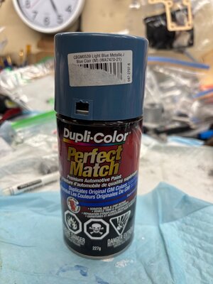

Did you use spray paint? If so, custom mixed or something close to Homelite blue?
I just used the light blue metallic, it’s a little bit bright and bold but it’s quite a beautiful colourIMG_9589.jpeg

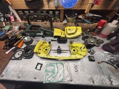

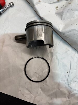

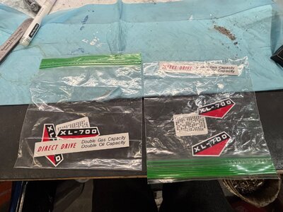

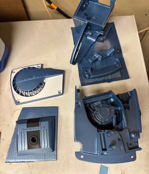

Just finished paint on the XL-700, next is the water slides, I bought stickers as well in case I screw up the slides. Thank god for Leon, he had a new piston and rings. Surprisingly the cylinder is in good shape. I’m glad I didn’t test fire before tear down
View attachment 477373View attachment 477374View attachment 477375
On your recoil.... Is that white on blue or blue on white? You got very crisp detail, ANY insight on how you detailed it or are you "JUST A NATURAL ARTIST"

Be glad you don't have the European muffler because then the entire muffler is filled with the pattern, a proper MM on them requires the muffler to be split.

Now I’m trying to figure out why max rpms are so low…just under 13,7 @ 1 turn out each
Rebuilt carb, replacing fuel filter…might be fuel starved? Ring never seated? What should compression be?

Years since I measured one, but over 150psi I think they were on.
H=1, unmodified it's rare you get particularly higher than 14k with H=1, usually I end up somewhere around 3/4 turn.
I feel they clean nicely around 15.2K.
