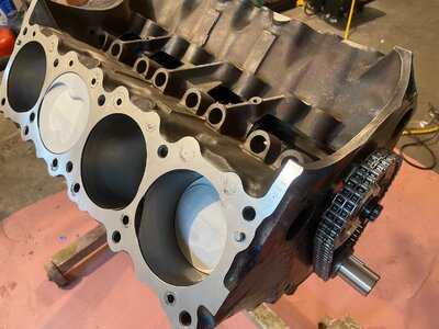

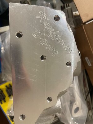

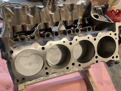

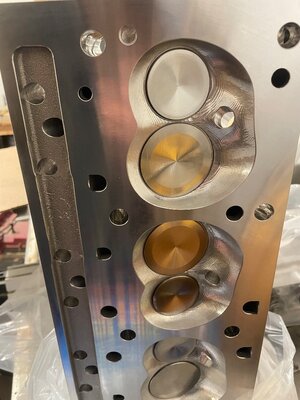

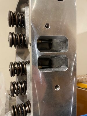

Here are some other pics. I just got the shortblock and heads back from the shop. The heads are cnc ported Kauffman D-port for Pontiac. They ended up only having to go from 4.150” (0.030 oversize for the 400) to 4.155” since the bores were like new. With the 4.25” stroke crank, I’m now at 461 cubes.IMG_0134.jpegIMG_0133.jpegIMG_0135.jpegIMG_0136.jpegIMG_0137.jpeg

How many of your family will fit in that (car)? What vehicle is it?

Are the combustion chambers also machined and if so, what is the benefit?
They are…I’m not sure it provides any real benefit over an as-cast chamber other than the chamber volume is more consistent. In this case, Kaufman’s as-cast chamber is 65cc. I needed 85cc to make this thing happy on 91, so their 85cc offering is cnc machined.
