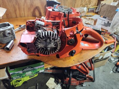

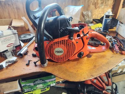

Made some more progress on the heated handle saw got the band cut enough so squish was enough with 2 gaskets and put some more of it together. Got to make a spacer and put the oil pump stuff together and a few odds and ends and should be about done until I swap the top ends. To conserve hardware for my other builds made this one all out of allen head screws only factory hardware so far is the recoil, av mounts and top handle screws

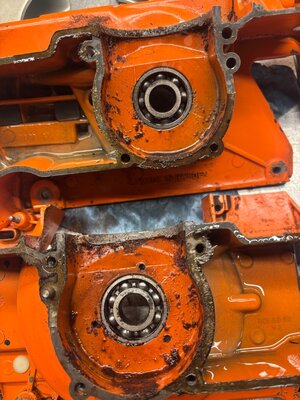

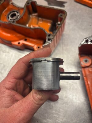

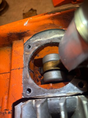

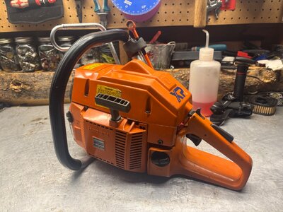

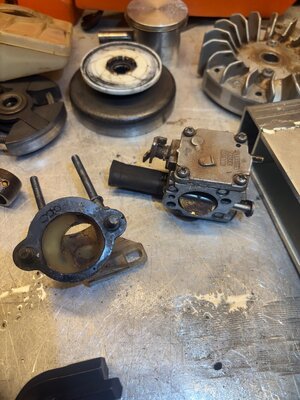

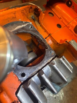

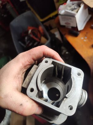

Well it has become very obvious to me that I somehow sabotaged my own saw. As soon as I started tearing it down, I removed the air filter and noticed that the screws were loose. I looked in the elbow and carb inlet and they were caked in sawdust. That’s not good…
Then when I got around to pulling the cylinder off, it became obvious that this was not a “fines getting through” situation. There was larger sawdust caked all up in the crankcase. I never imagined that a saw could get like this, let alone my own saw. Take a look at the pictures…
Now I know to ALWAYS make sure that the air filter is tightened down before I go cutting.

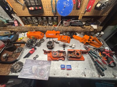

Piston and cylinder were fine. Crank was fine. I got lucky. Cases cleaned up, old bearings removed. Ready for reassembly tomorrow with new bearings and case gasket.
