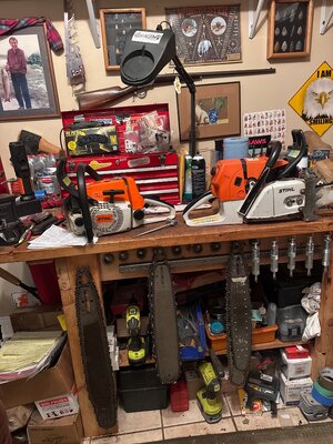

I try to leave the shop and museum open even when I am gone for a few hours in case someone stops by and wants to look around or leave something to be worked on.
I came back yesterday after having been out most of the morning to find this...
The owner did give me a call to let me know the back story. He says he's not planning on running them for a while so I can take my time going over them.
There are a bunch of chains that need attention in the big bucket.

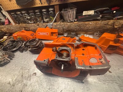

15,021
59,967
Well it has become very obvious to me that I somehow sabotaged my own saw. As soon as I started tearing it down, I removed the air filter and noticed that the screws were loose. I looked in the elbow and carb inlet and they were caked in sawdust. That’s not good…
Then when I got around to pulling the cylinder off, it became obvious that this was not a “fines getting through” situation. There was larger sawdust caked all up in the crankcase. I never imagined that a saw could get like this, let alone my own saw. Take a look at the pictures…
Now I know to ALWAYS make sure that the air filter is tightened down before I go cutting.
That is one way to stuff Your saws crankcase!
Now use proper oil to increase compression through carbon buildup.
From experience I can recommend mineral 15W40 (atmospheric diesel tractor engine oil) at 25:1 or higher, does wonders in so many ways. :thumbsup:

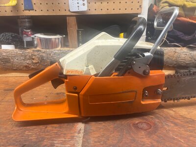

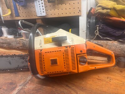

I also went through my new barn find white top 61 practica. I removed the muffler baffle, replaced the coil, rebuilt the carb, and replaced the fuel line and filter.
It was also missing a bar stud, so I modified a 272 bar stud to fit. That involved trimming the rectangular plate on the end of the stud into a square, grinding the shoulder that the bar rests on back, tapping the threads deeper, and trimming the overall length down about a quarter inch.
I didn’t do crank seals and seal carrier o-rings, but I will be doing them soon.
The saw fired up and idled nicely. No obvious evidence of any air leaks. It cleaned up pretty well, but I still have some work to do with removing hardened sap spots on it.
I coulda sent you a stud :p
