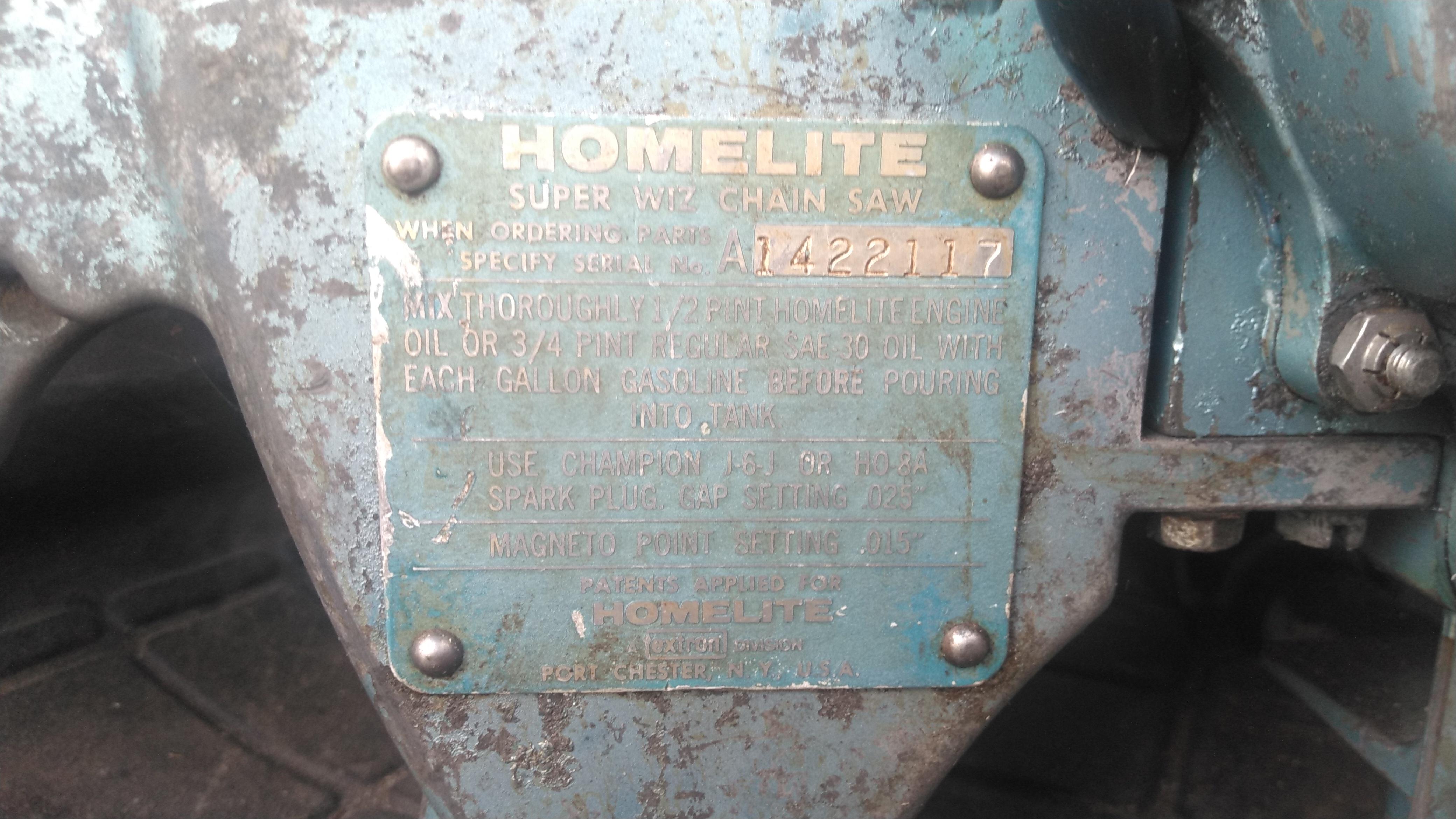

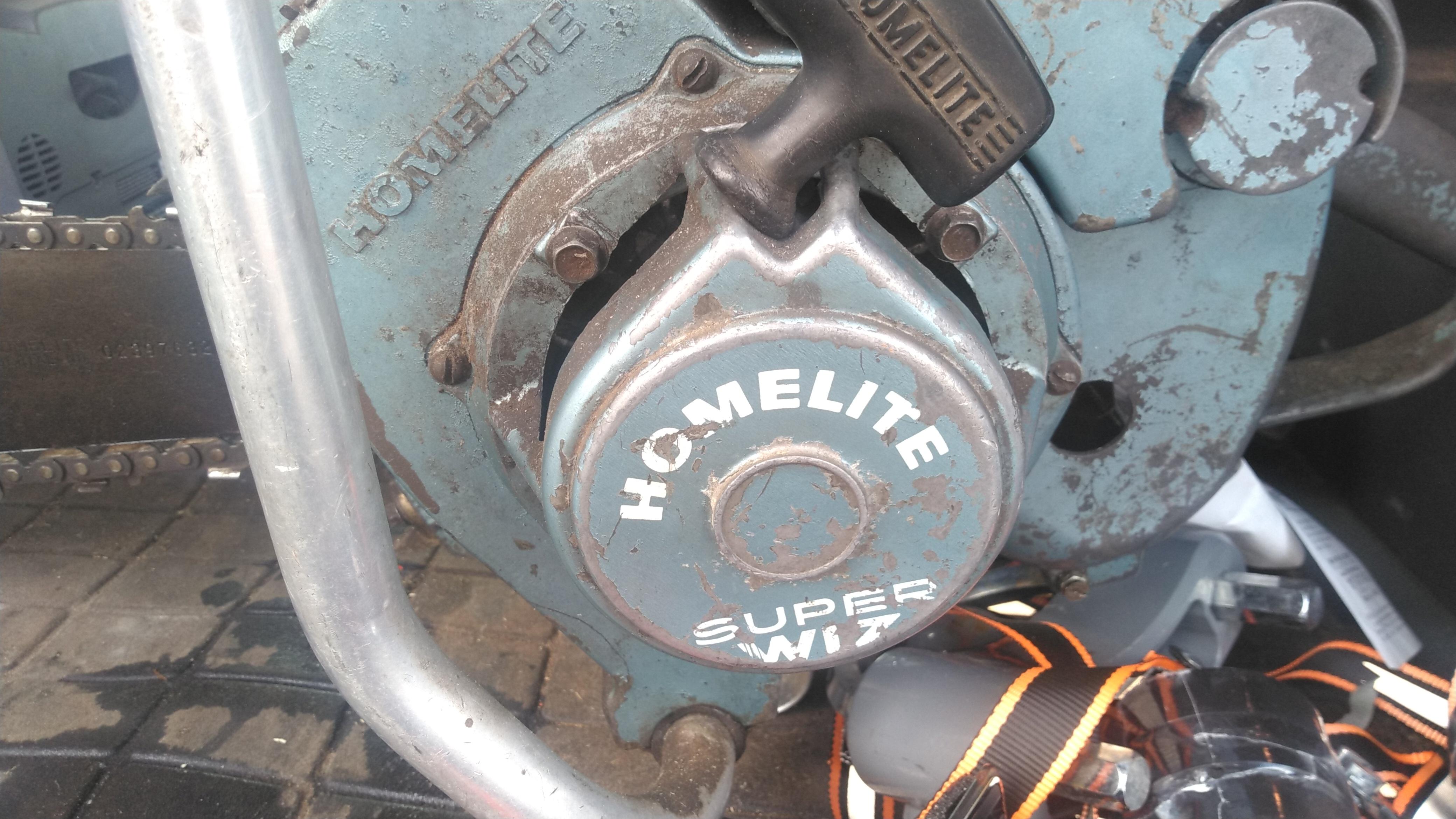

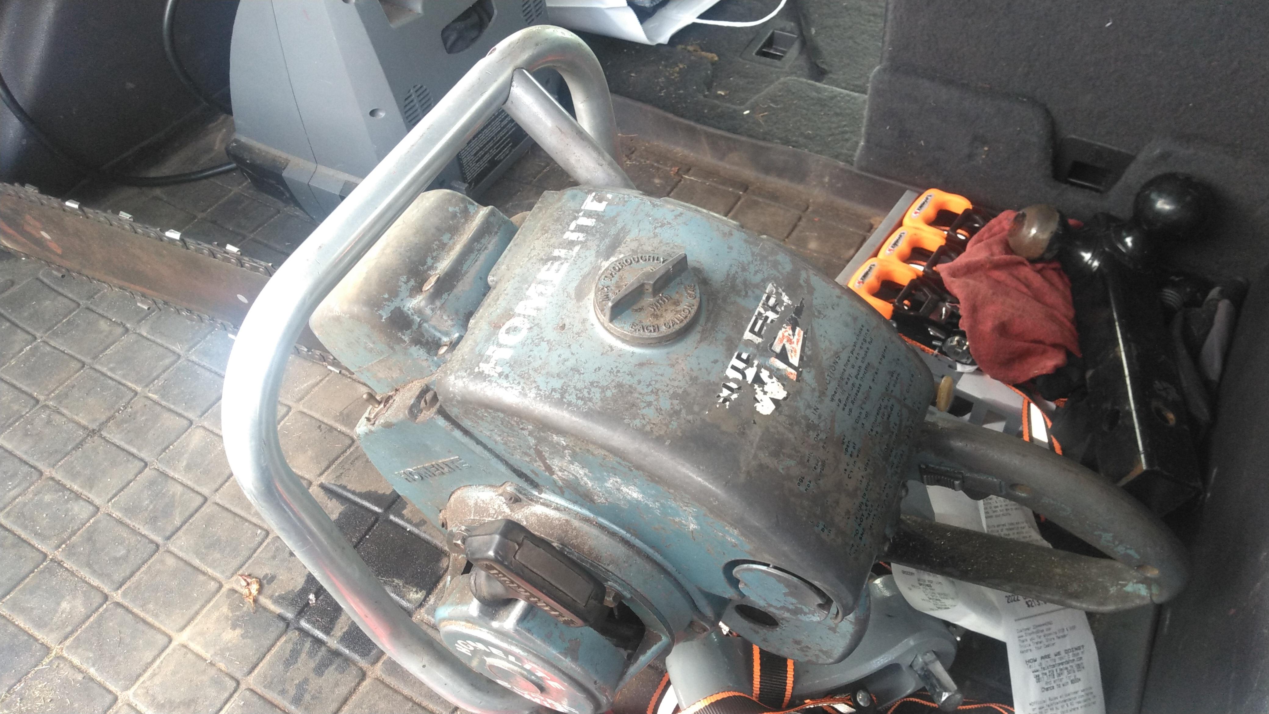

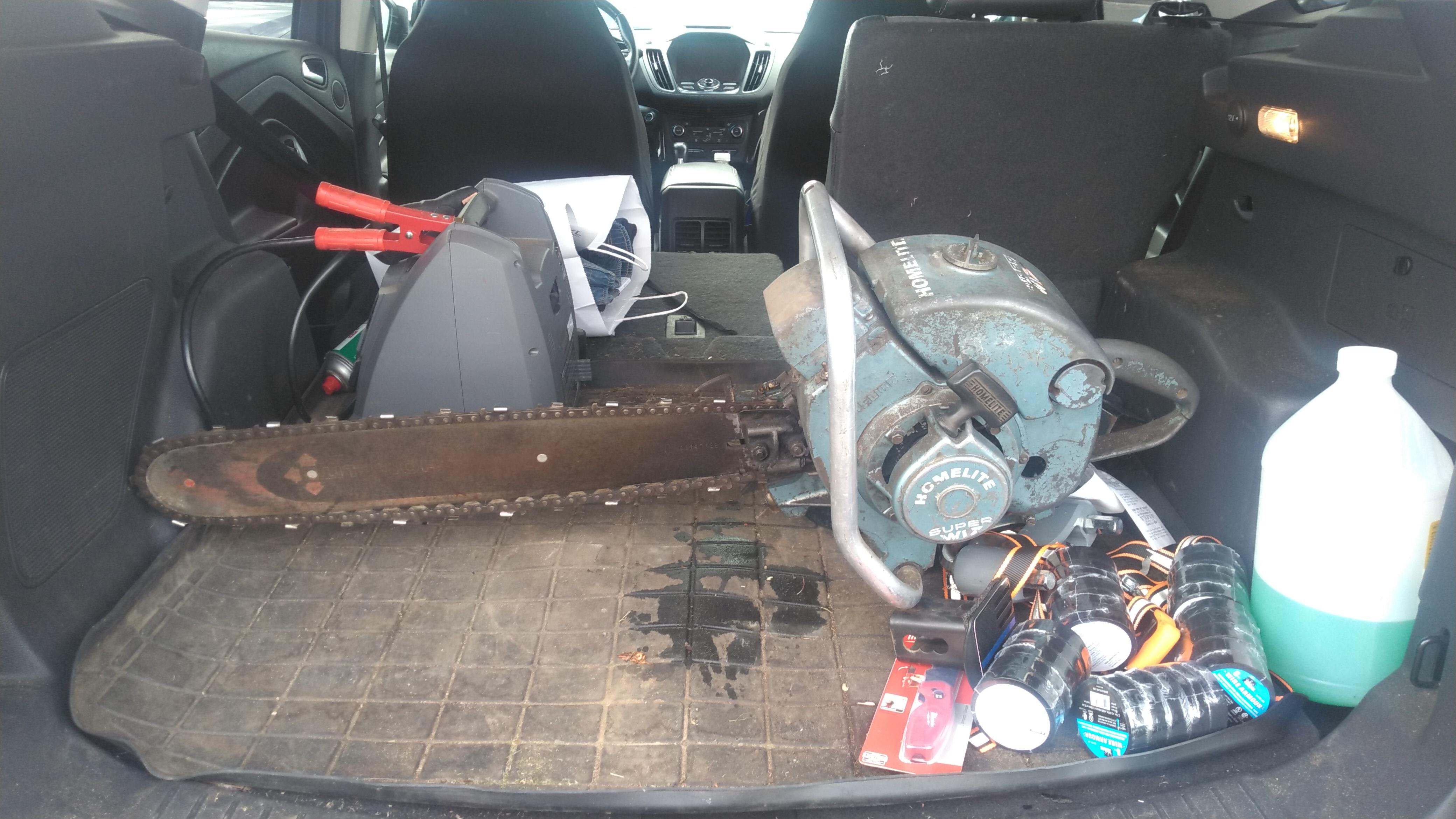

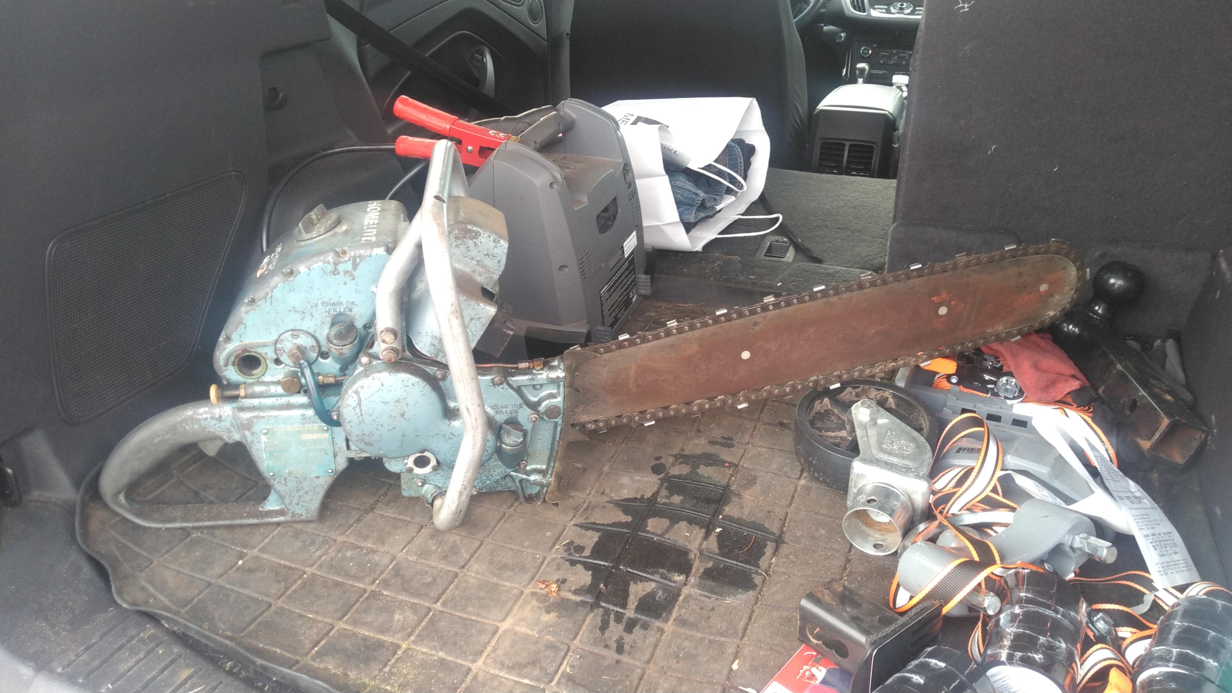

This old beast. 1963-64 Homelite Super Wiz. Traded my 051 for it yesterday. Has great compression and ignition. Waiting on friction washers and pawls for the recoil as well as a carb kit and fuel outlet gasket. Popped on brake cleaner. Fuel system overhaul and cleaning next along with repairing the recoil and replacing the rope.
She's a 77cc gear drive beast sporting a 24" hard-nose bar pulling 1/2" pitch chain
