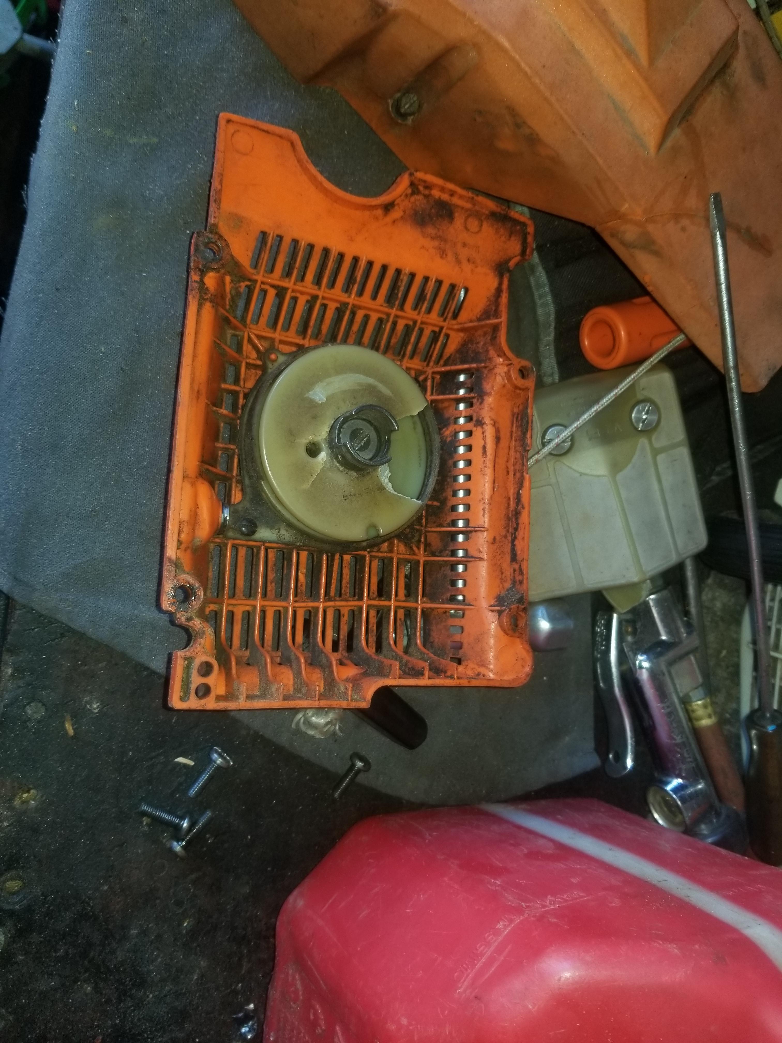

I've got a 192T a buddy sent my way that "only runs at half throttle and it's a bi-atch to start", a PM6 that has an air leak, an 026 that I've put a new fuel line and carb screen in so I'm assuming all it needs now is for me to sharpen the chain, and my 056 Super. The 192 got a carb kit and a new muffler bolt, I also had a buddy weld up some holes in it from a tossed chain, all I'm waiting on is a new a/v spring and it should be ready to go. Who knew saws don't like getting tossed out of trees when they don't start? (I'd probably do the same thing with it, though).
The 056 is "done", but I need to address some stuff. Namely, it ripped the pull handles off both recoils I had! I did a BGD like the p.o. did as well as a slight timing advance, the jug was already ported and the carb was already bored/smoothed so I left it that way. The saw ripped the first cord through when I tried to start it and it ripped the second cord when I tried to get a comp reading. It was over 180psi and steadily climbing when the rope pulled through the handle. I see the dual-pawl mod and maybe a D-handle and a decomp in it's future.
