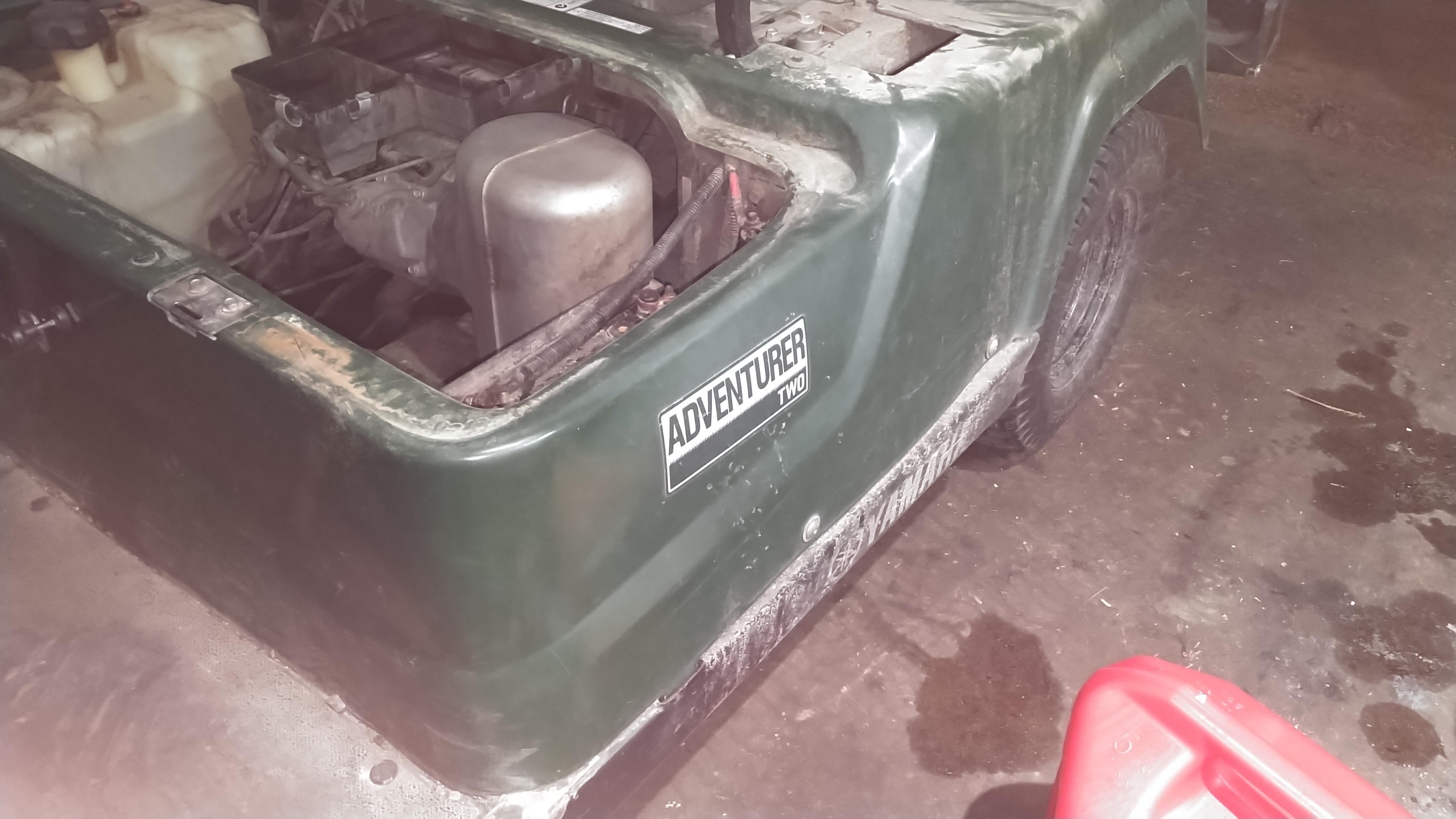

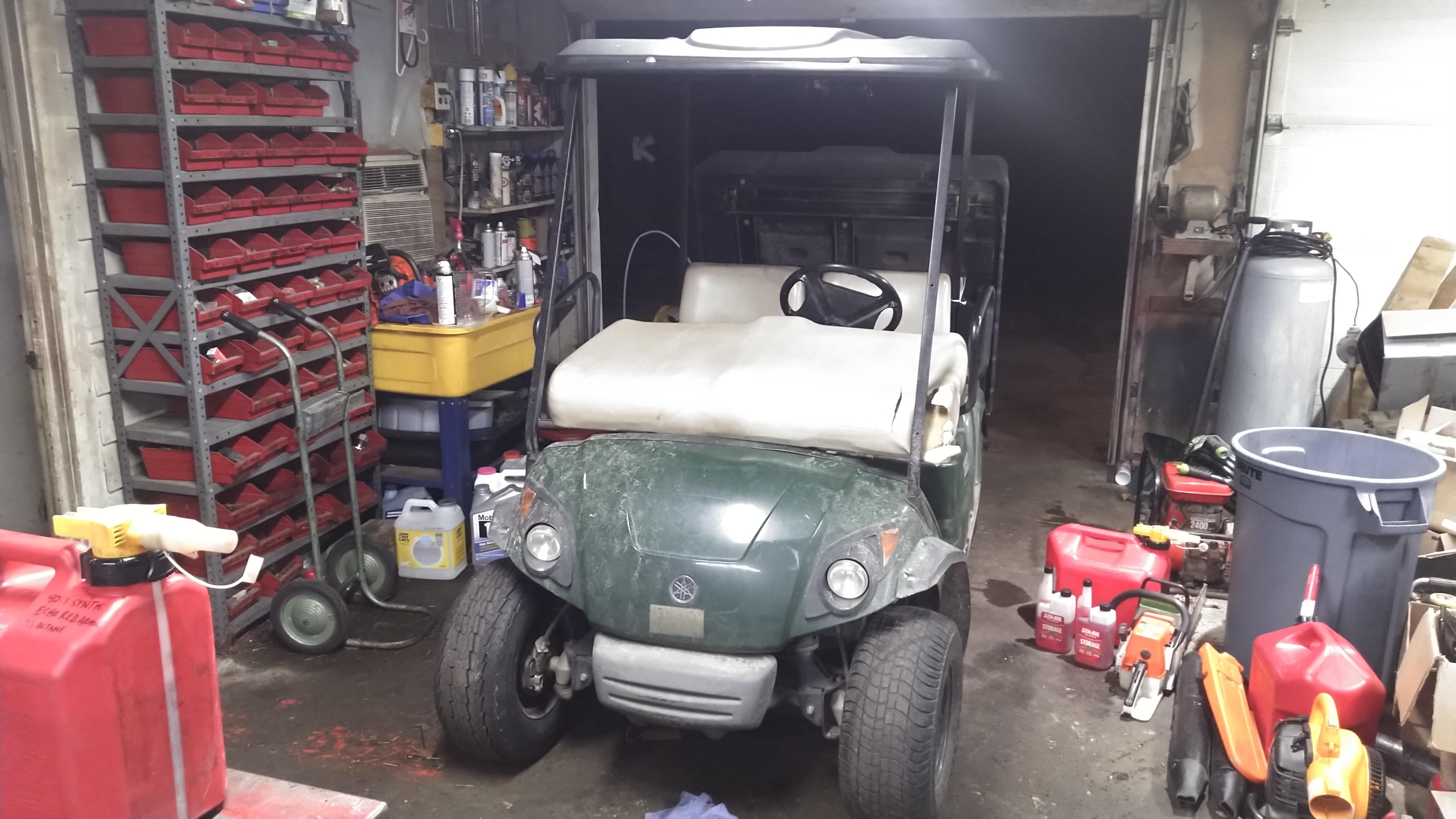

Had this dropped off for a get running and service. Runs like dog poo. Choke cable is frozen in the on position. A new choke cable and carb rebuild should have her going. Once shes running I'll toss in a new plug, fuel filter and change the oil. It's going to be my Thursday snow day project.

Sounds like you have about all the work you can keep up with. That means you probably have a good reputation.
