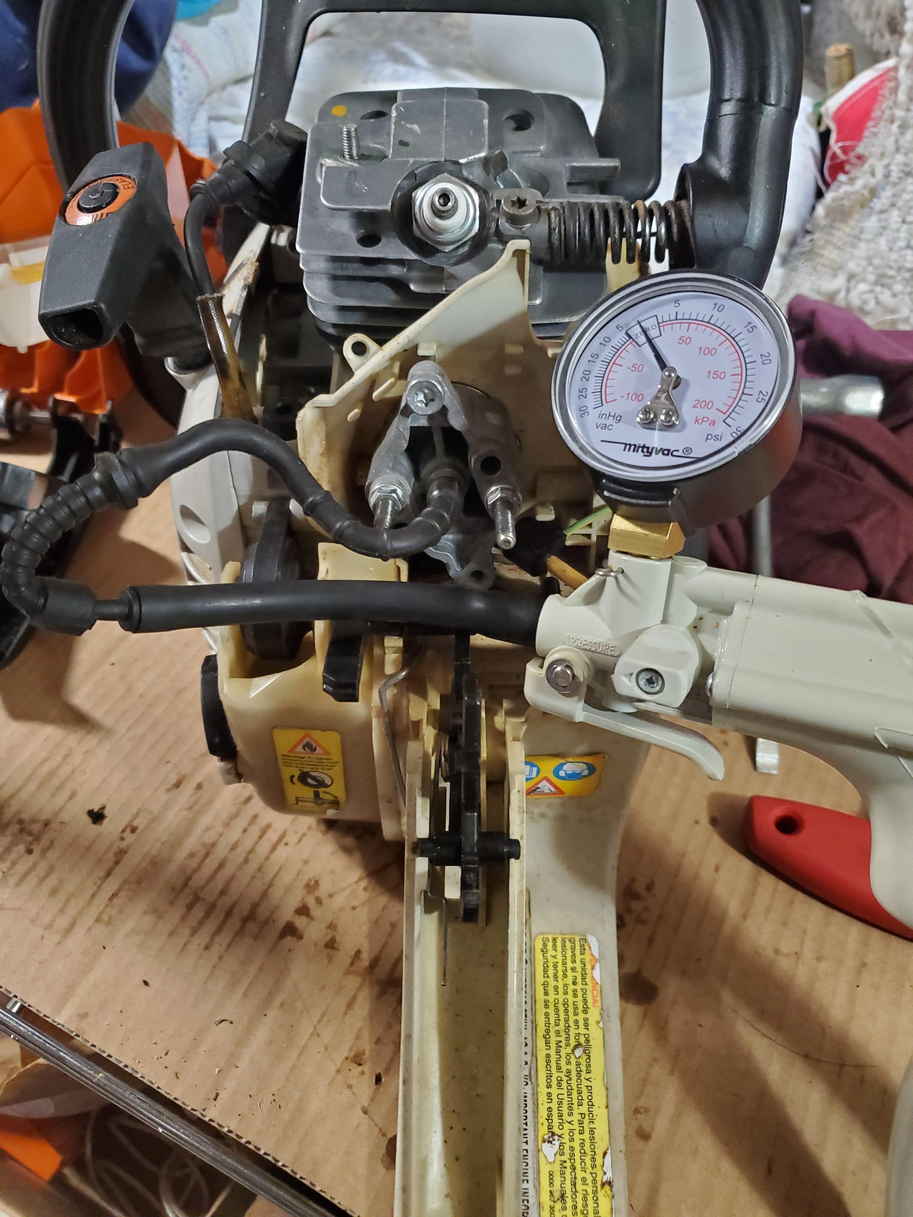

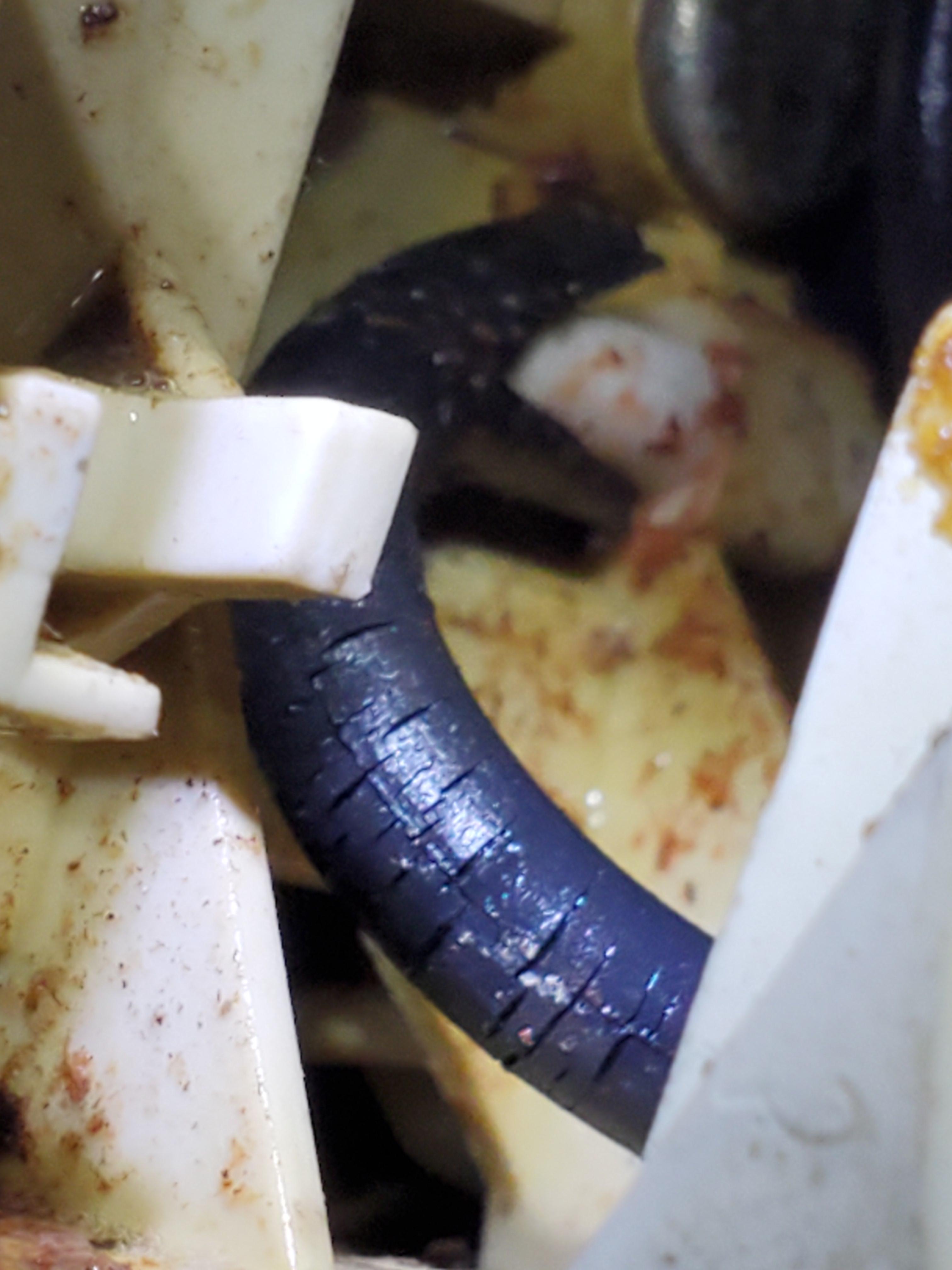

My 361 hit the bench for a pressure and vac test. She went nuts while limbing a pine I dropped in my yard. Glad it is an easy fix! I suspect a aftermarket impulse line was used before I got it.

Yes I'm sure it is a AM line. Was installed before I got the saw. It looked fine when I put the ported cylinder on it August of 19. Saw only has a tank or two on it since then.
I used an aftermarket fuel line once and the saw came back shortly after. The rubber was disintegrated and in pieces in the tank. Last time I used an aftermarket line
