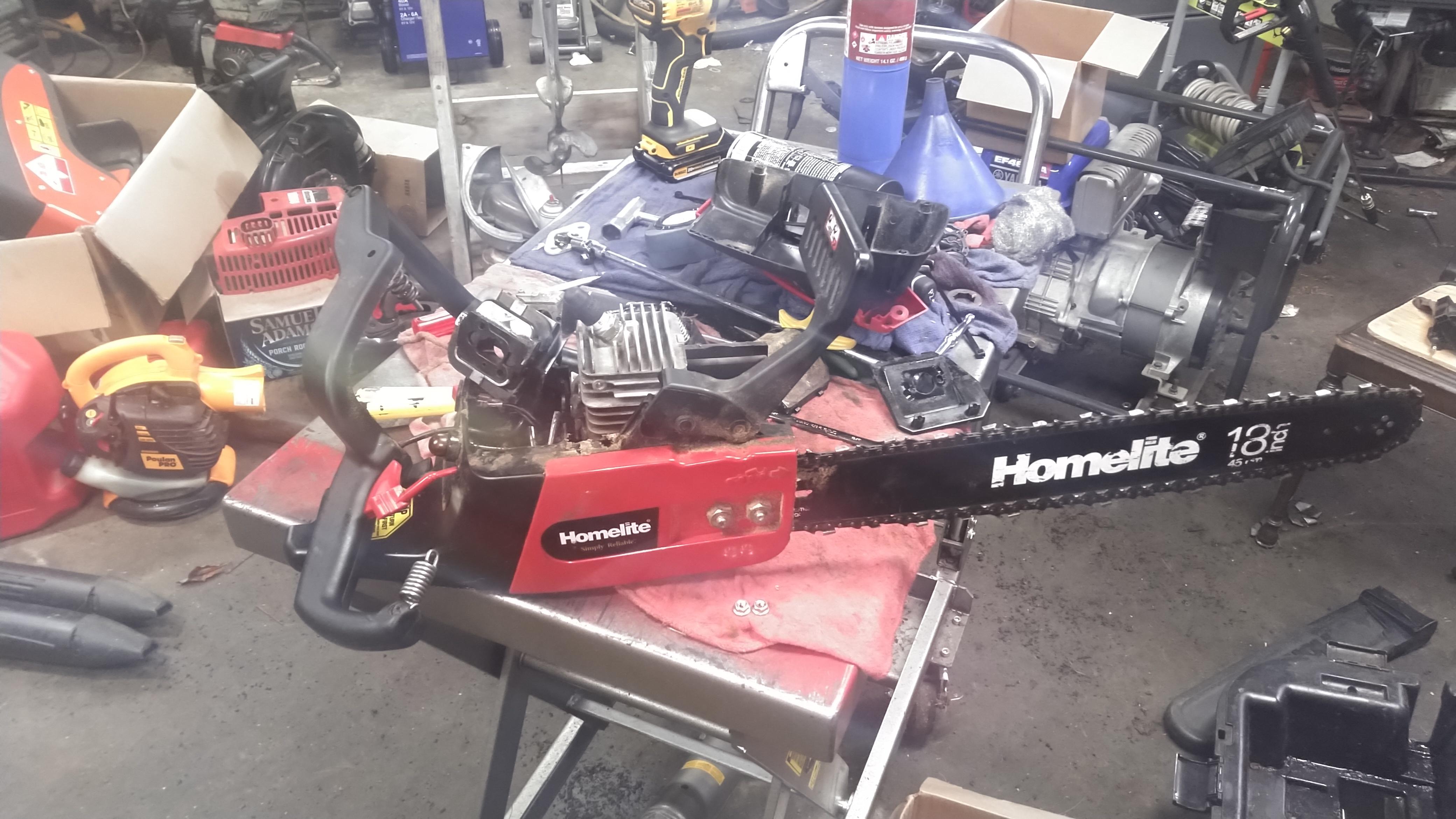

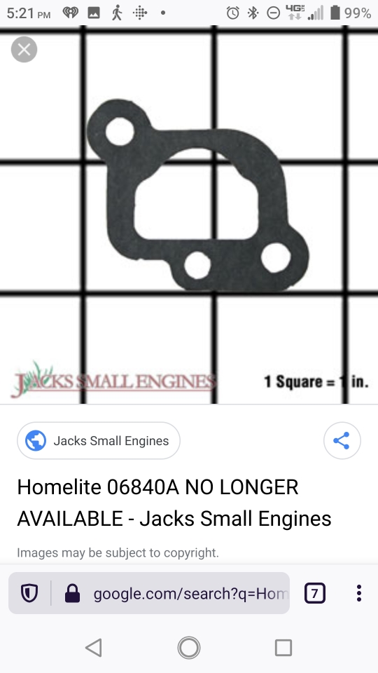

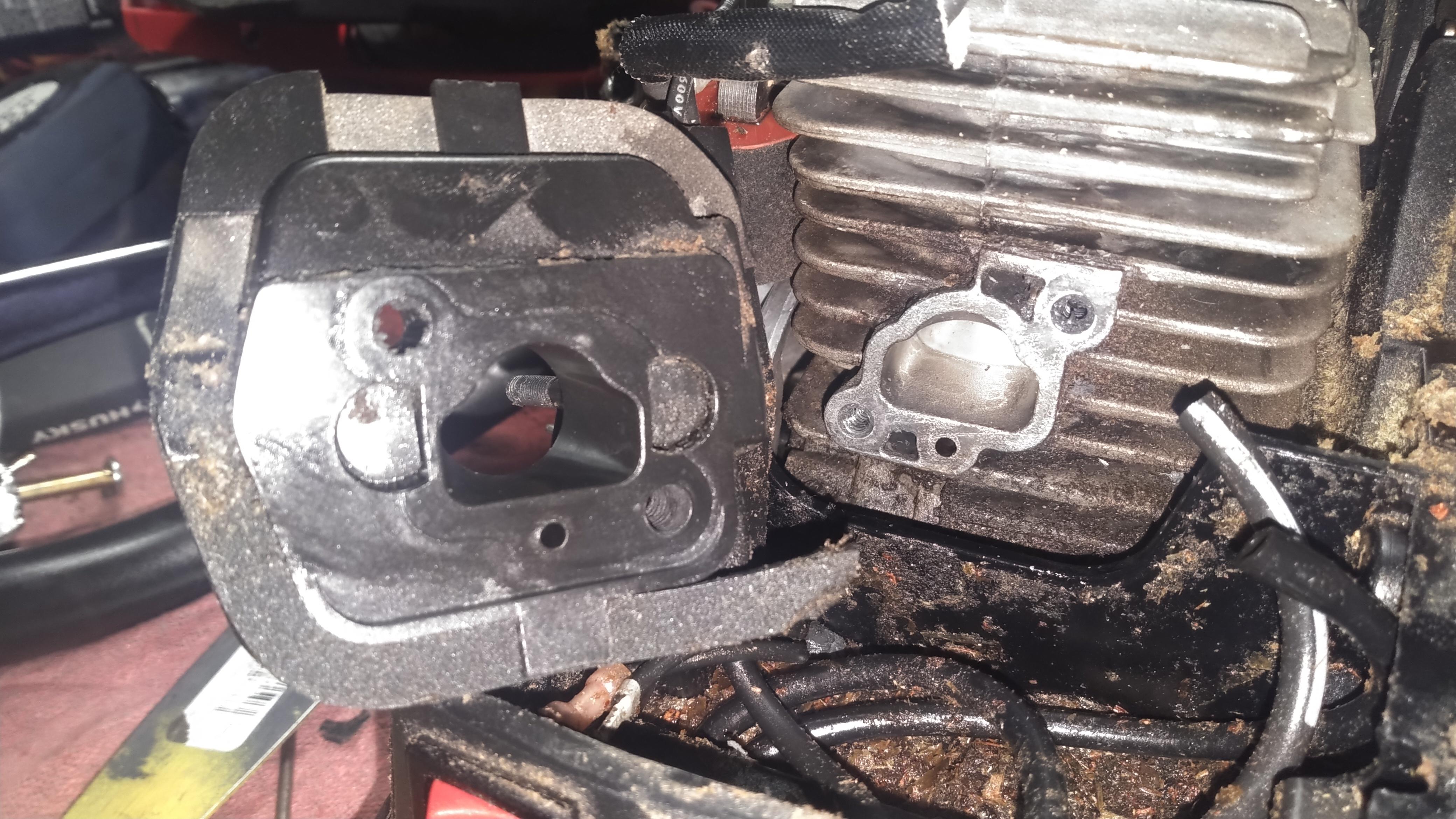

POS plastic Homelite for one of my mom's friends. His complaint was hard starting. Did the basic checks and all okay. Found carb base loose and gasket blown out, looked up gasket and it's NLA. Thinking about using a skim coat of motoseal to seal it up. Gonna mull it over over an Alec Bradley Magic Toast robusto.

After mulling it over, I've decided to make the gasket myself. Going to pick up a set of gasket punches this week and steal a piece of cereal box from the kitchen.
