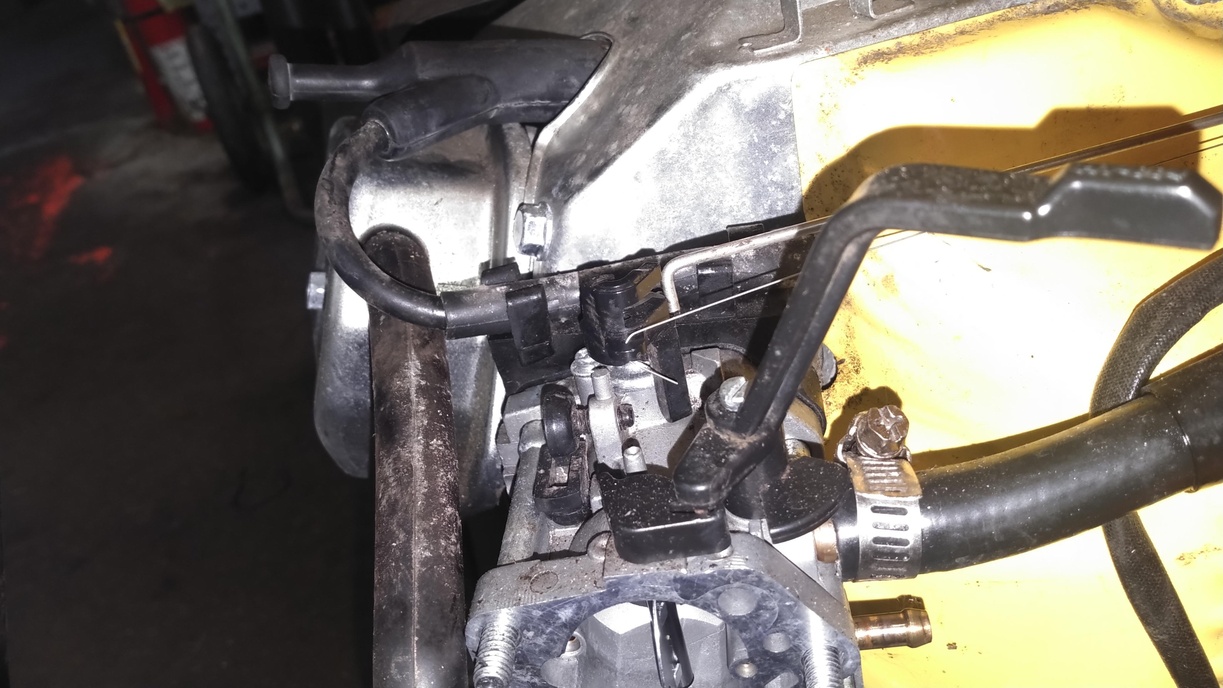

"My generator won't start, I even cleaned the carb." More ethanol fuel making me money. Should be just cleaning the carb, tank, and flushing the fuel line. Governor link wasn't even connected to the throttle shaft.

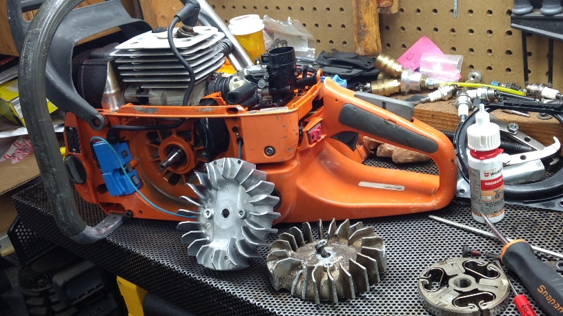

As expected the bolt came from the carb floor... The other three were also loose.
Blue loctited all four.
Actually had a flywheel for the 390!
It got a cleaning and quick service.
Cyl looks smooth and piston is well worn.
It's a tee service saw so...
