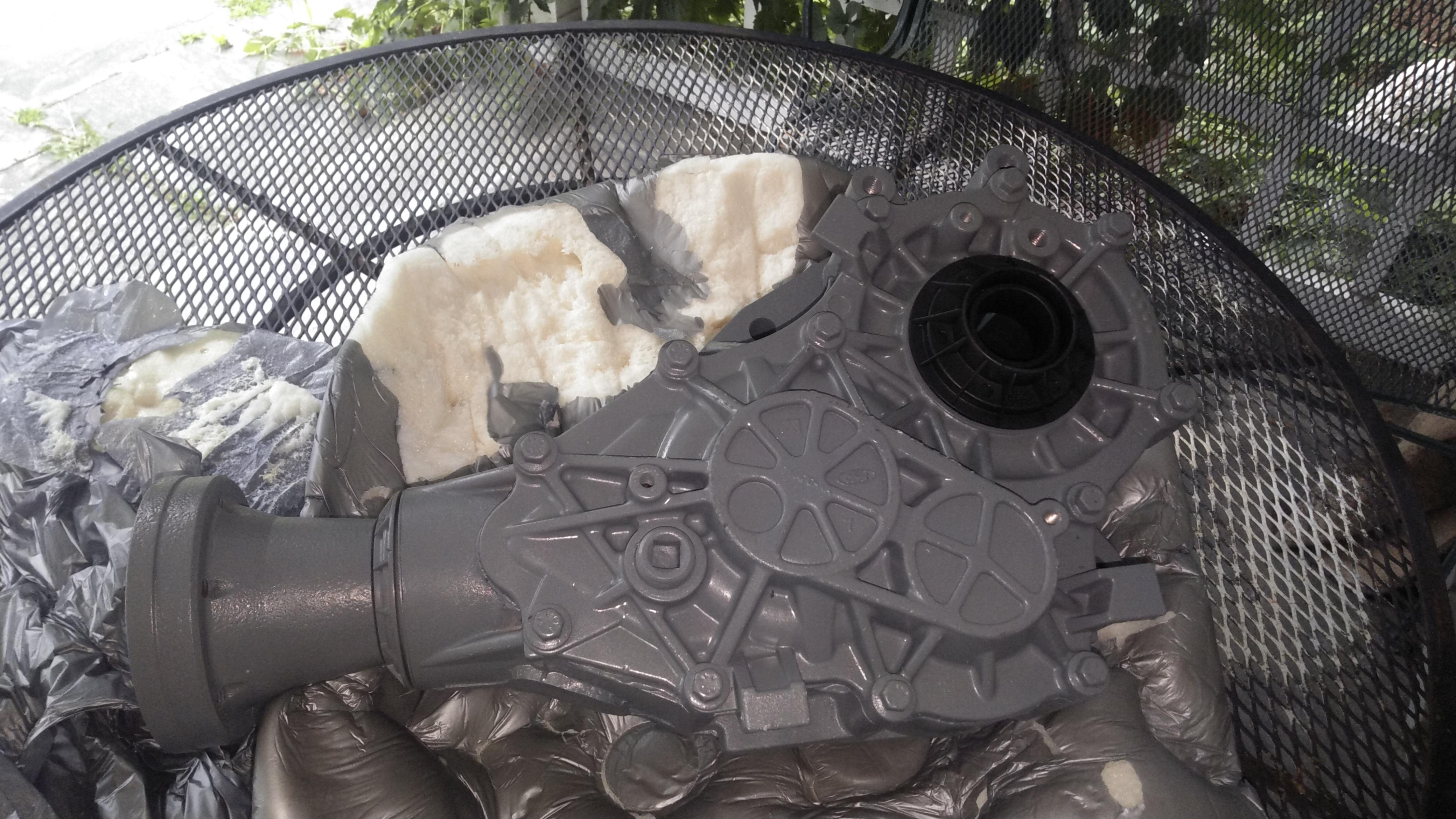

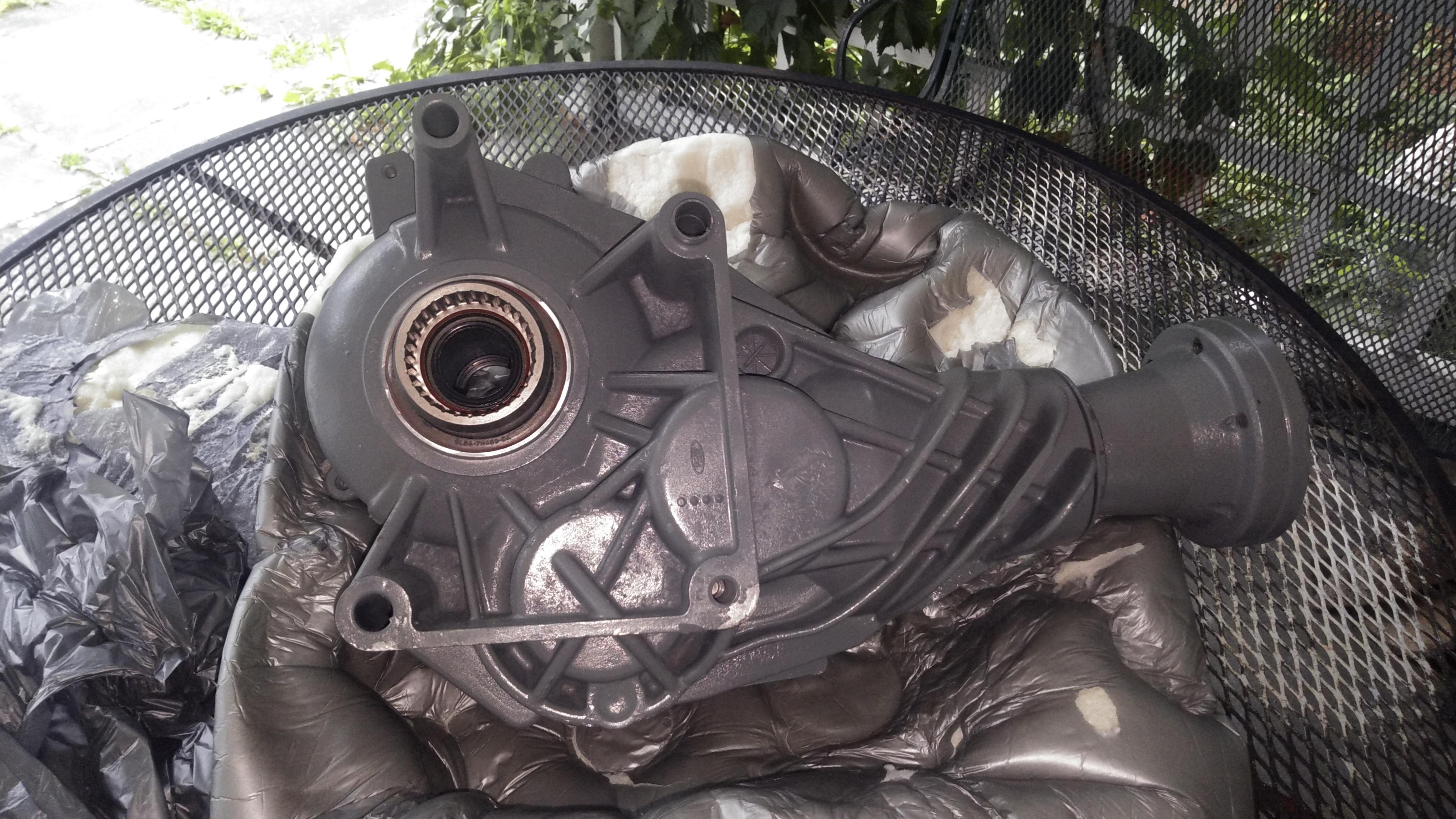

Remanufactured PTU arrived today for my Escape Hybrid. Calling local shop in the morning to setup an appointment for installation. Honestly I don't do much to my vehicle other than little stuff like oil changes and brakes, I just don't have the time to do so.

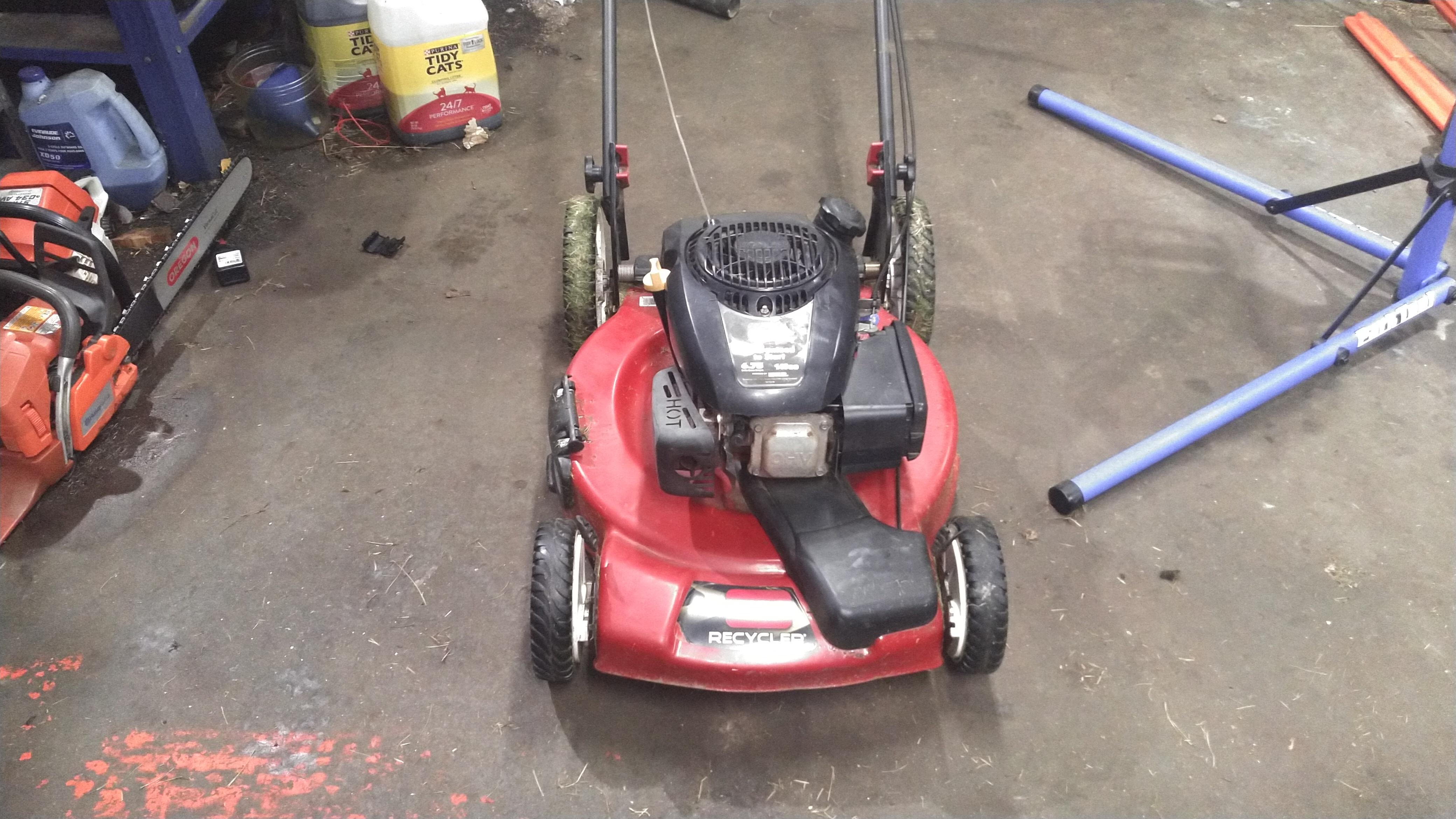

Worked on a Kohler powered Toro Recycler push mower last night, cleaned the carb in the ultrasonic cleaner and it's still not running properly and I definitely poked all the holes etc. It'll get a replacement carb.
