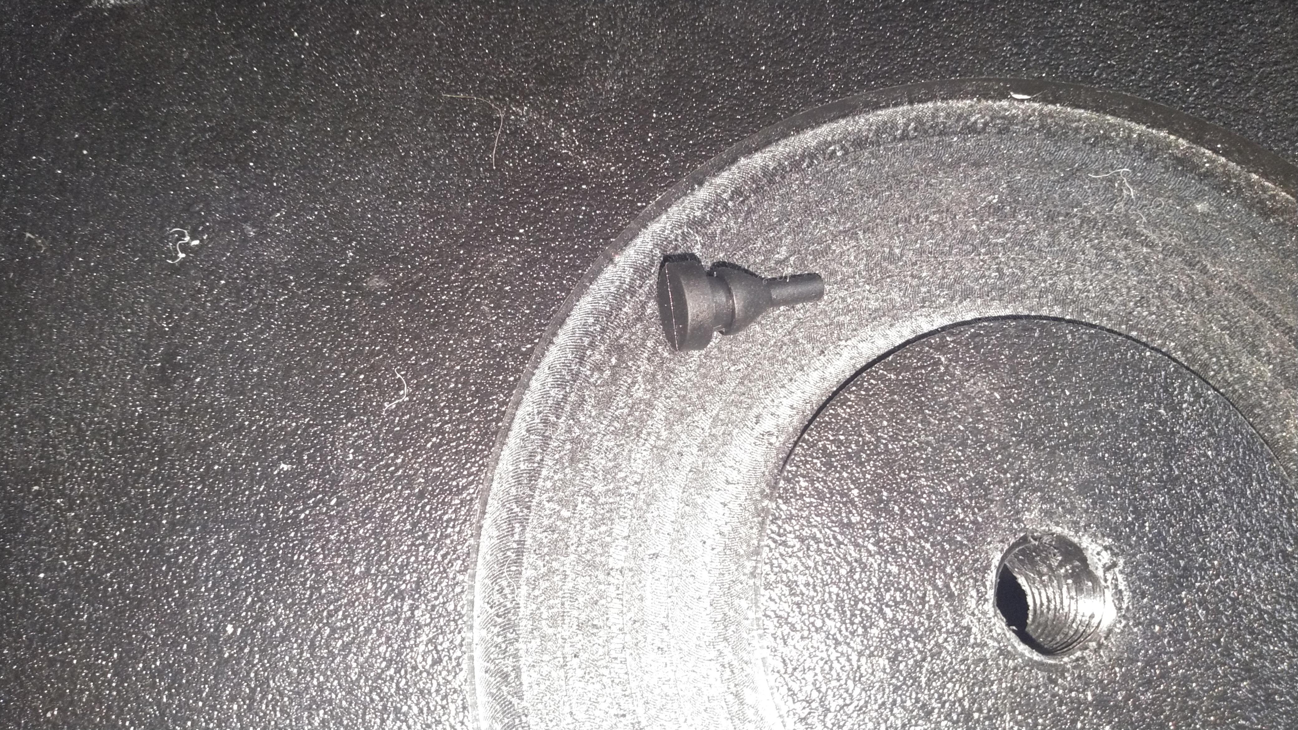

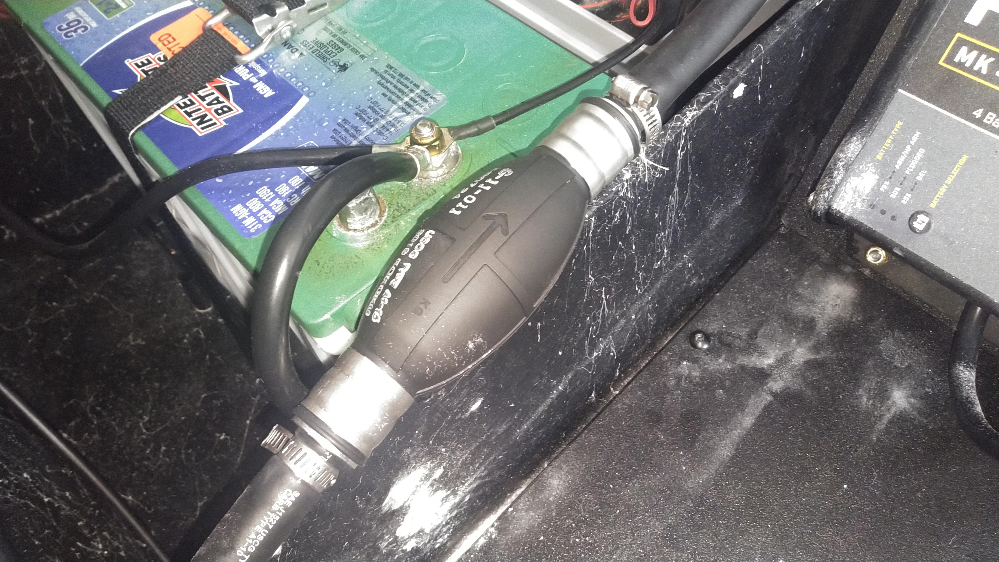

Prepping a new Ranger Z521L bass boat for delivery and while getting ready to run the engine, I couldn't get the primer ball to pull fuel, definitely a fuel restriction somewhere, checked water separator, was okay, pulled primer ball off and found this rubber plug in the fuel line... removed, primed up okay, and the engine started right up!
