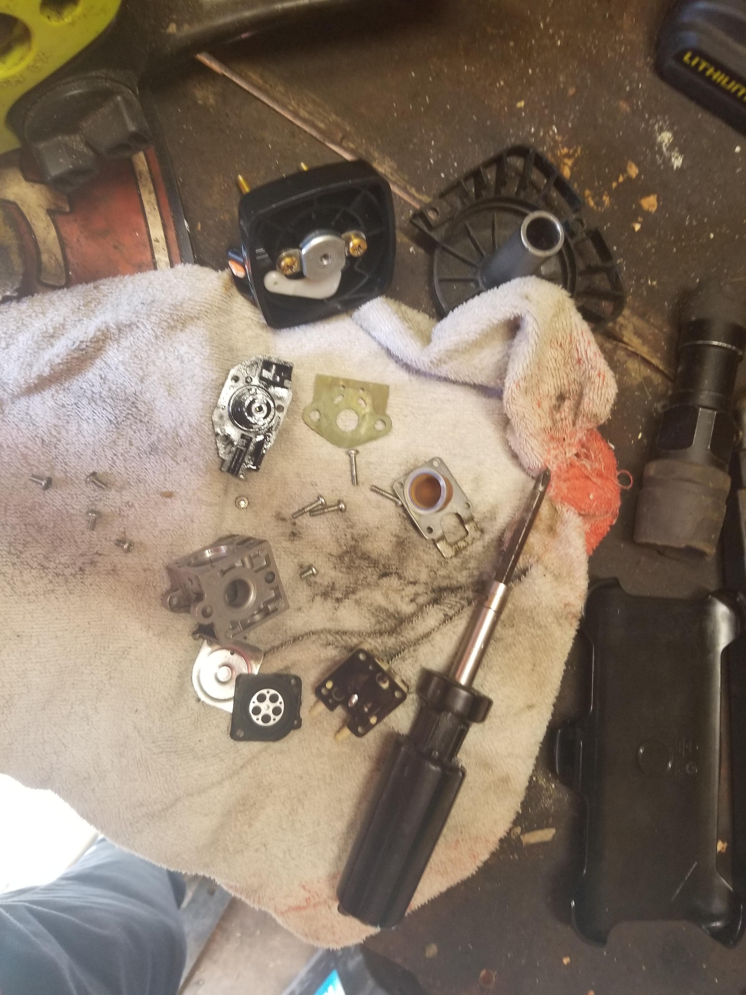

Working on the carb for the echo weedeater. Also replacing the fuel gromet and air filter.

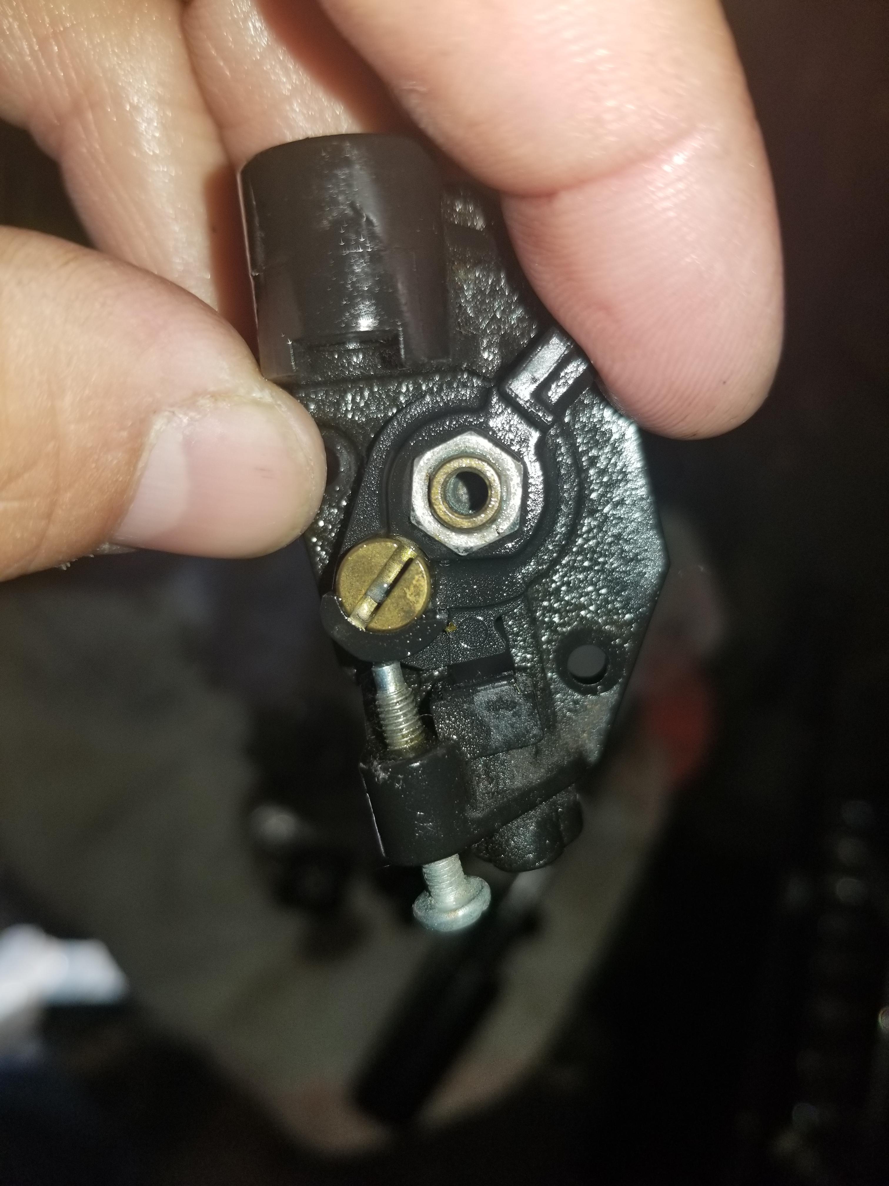

Hey @WillG or anyone who knows, you have any idea how to adjust the low needle on the echo trimmers? I cant tell if its a special tool or if i have to remove a plug like the high side.
There is a black plastic plug covering the low speed mixture screw on the top. Remove it and it takes a TINY flat head.

Ok thanks. Will try that tomorrow. How do you remove that? Small scew?
It is a plastic push in plug, I heat up the end of a paperclip and push it into the plug. The plastic will melt around it and you can let it cool then pull it out.
