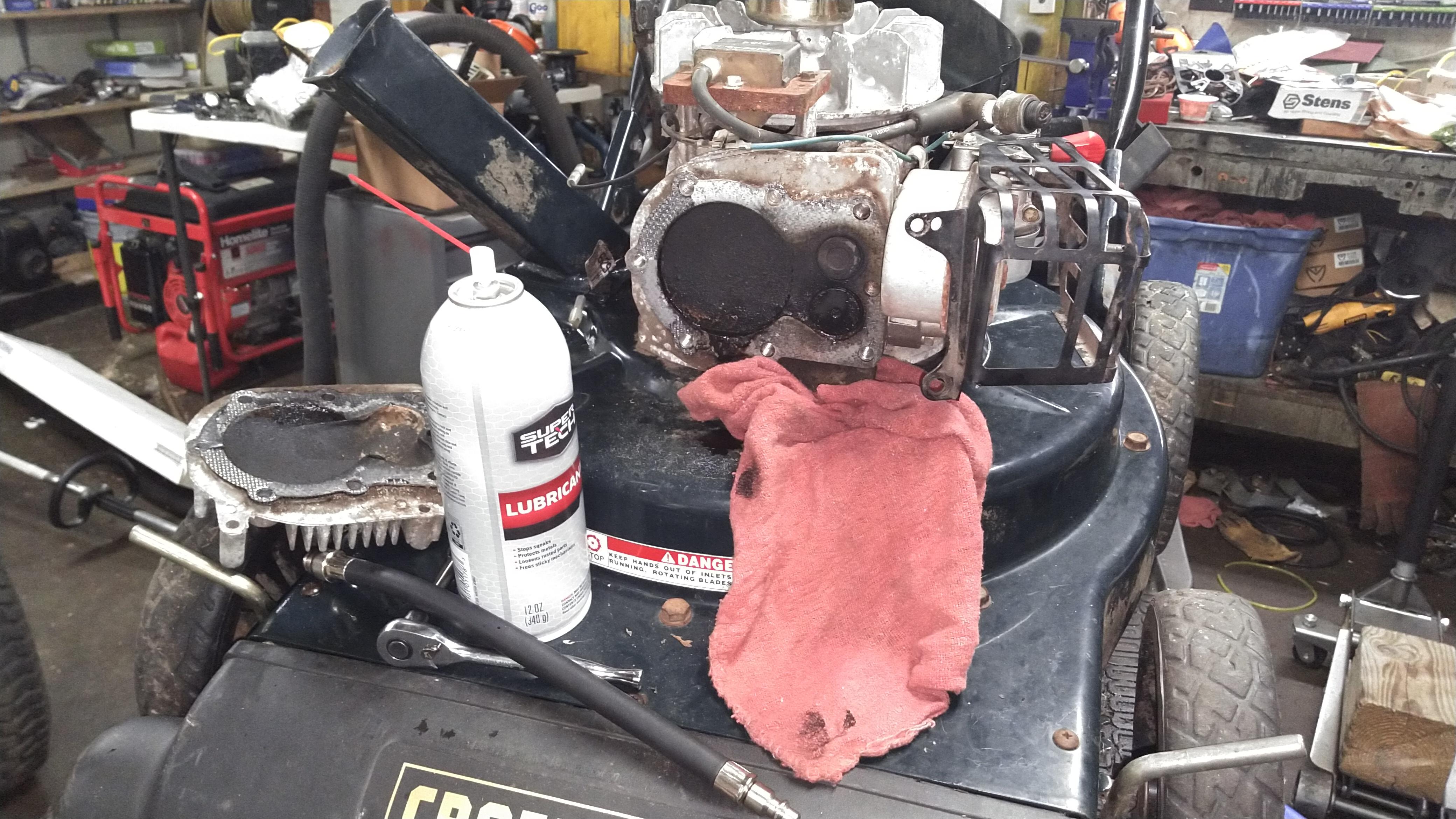

Poor bastard wouldn't hold pressure....
Leaked badly, new orings and good as new.
Second pic helped me through. Lol

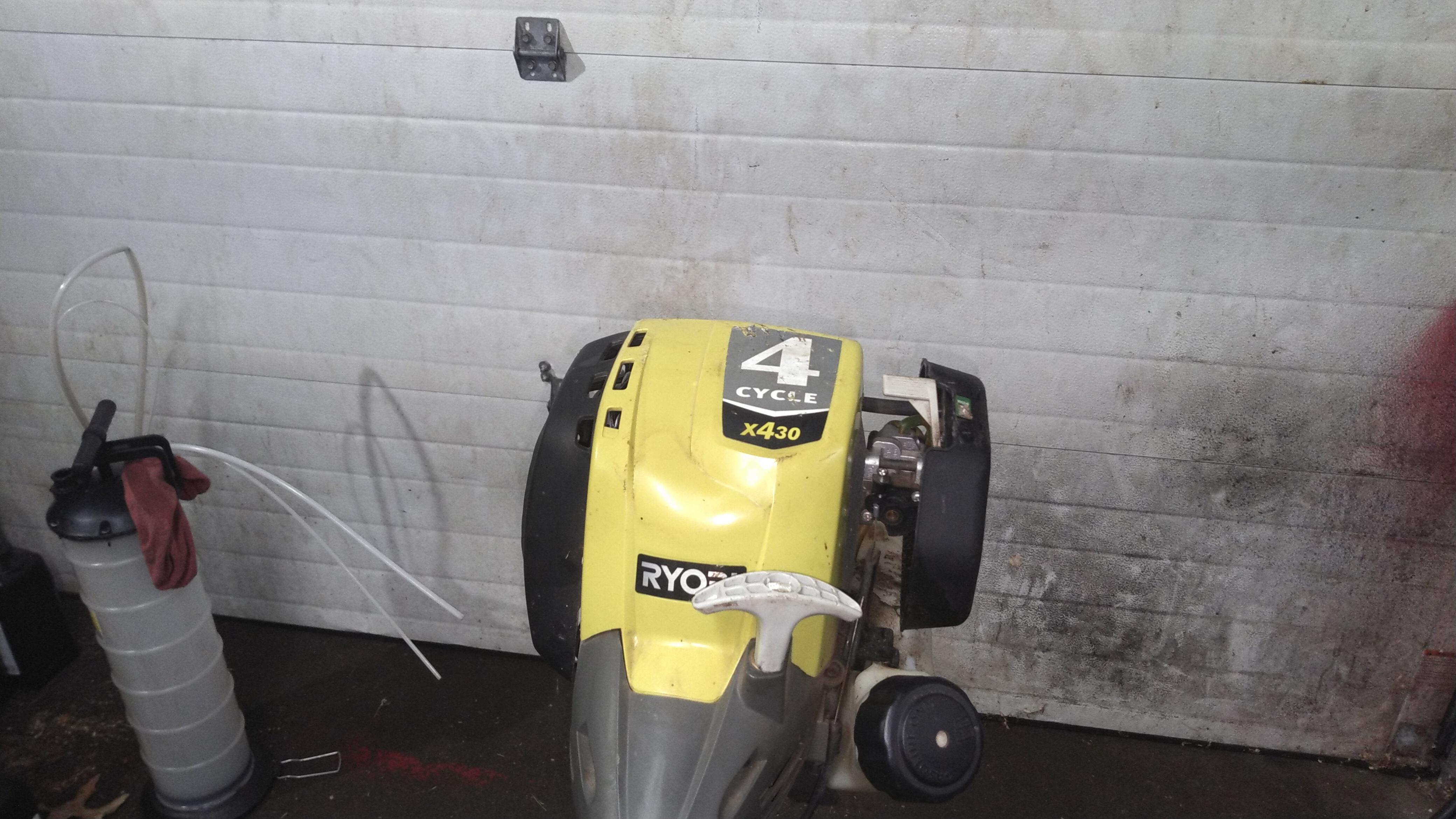

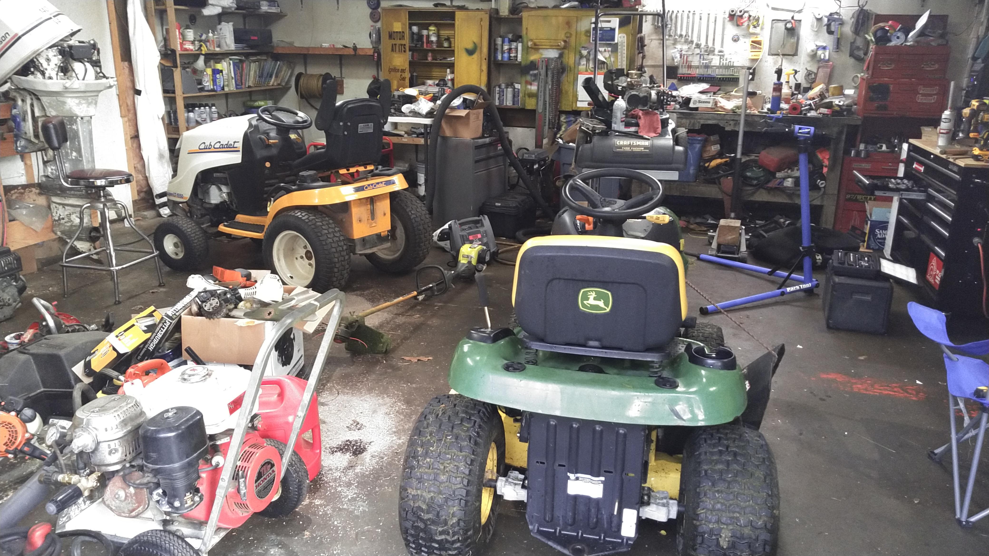

Ryobi 4 cycle trimmer that came in the other day. Complaint was wouldn't stay running/tune up. Seems to run pretty good, let it idle while I checked out a Craftsman yard vacuum that came in this evening. Trimmer ran okay for a while so I serviced it with new plug, air filter, fuel filter and oil change. Will run it again to do some trimming with it to see how it does under load.
The Craftsman yard vacuum came in for a no start, even after he cleaned the carb and put fresh fuel in it. Wouldn't fire on carb cleaner, compression felt weak so I put my gauge on it and big ol goose egg for compression! No spark either, coil is dead. Gonna call him in the next day or two and see if wants me to go any further with diagnosis. Seems to have lots of air coming back thru intake, suspecting a possible stuck intake valve.

Yanked the head off the little Tecumseh and found a stuck intake valve. Freed up valve. Parts on order. Carb kit on order for the ryobi 4 cycle trimmer. Had a John Deere rider dropped off for a carb rebuild and service. Finally got a haircut after 12 weeks!
