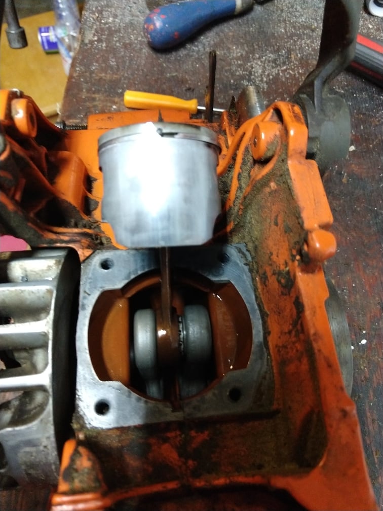

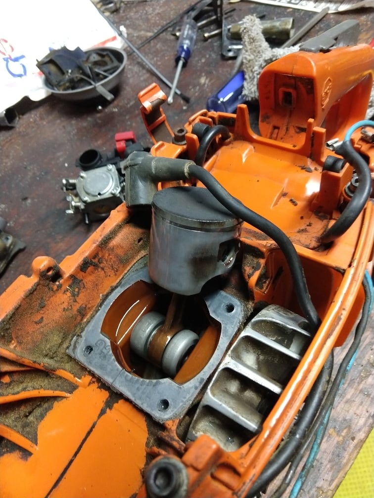

359 update. Going together and decided to share a lil mod. Used a 350 dog for the bracket. (The cut up one and stock to show what was done. Sorry i threw a piece away but u get the jist.)
372 dog with roller catcher was installed on the 359. Had to do some modding to that dog as well. Bottom hole was oblonged and relief cut for the bottom of case. Top hole was slotted. Bracket was made as an extra strengthener prob overkill but wanted to share.
Also makes the Hooskie kickstand most importantly:D
And with the extra width thre is still ton of thread on bolts.View attachment 241843View attachment 241844View attachment 241846View attachment 241847 View attachment 241849

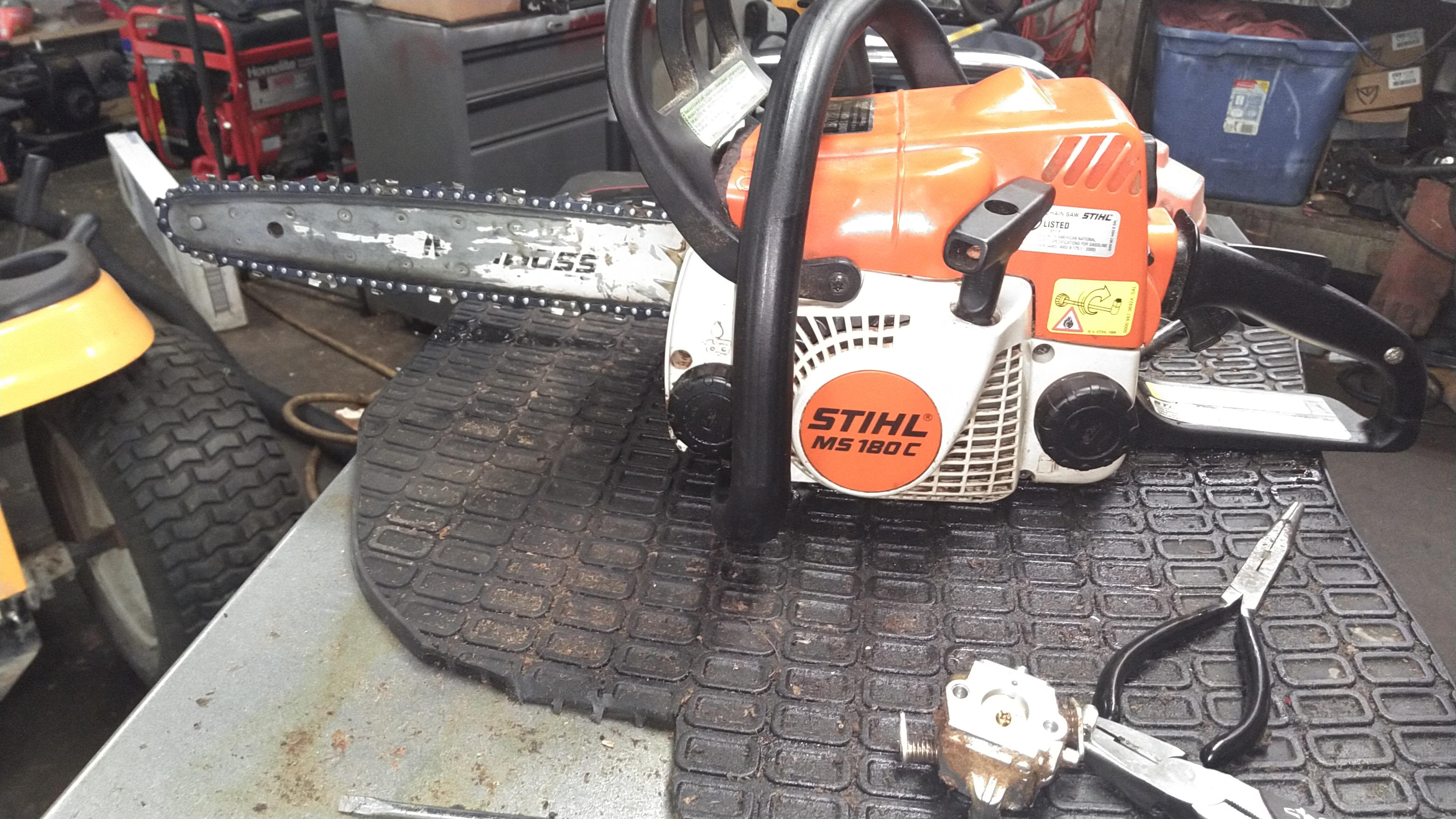

MS180C got a new carb. Runs excellent! Couldn't put the supplied chain on as it's running a narrow kerf (0.043) chain and the one he got was a .050. Kinda cute almost looks like a real saw lol.

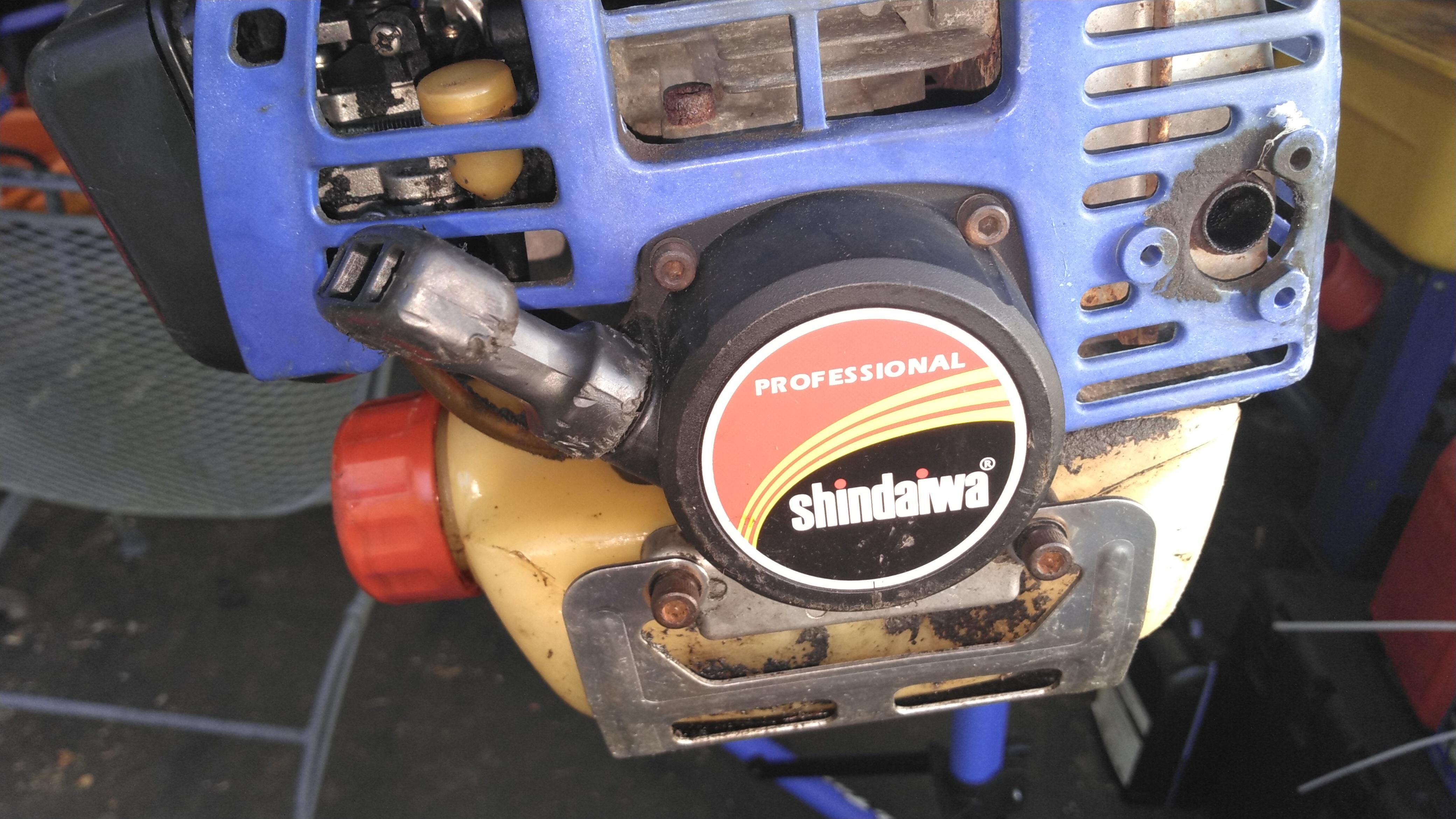

Shindaiwa trimmer got a new coil. Runs great.
