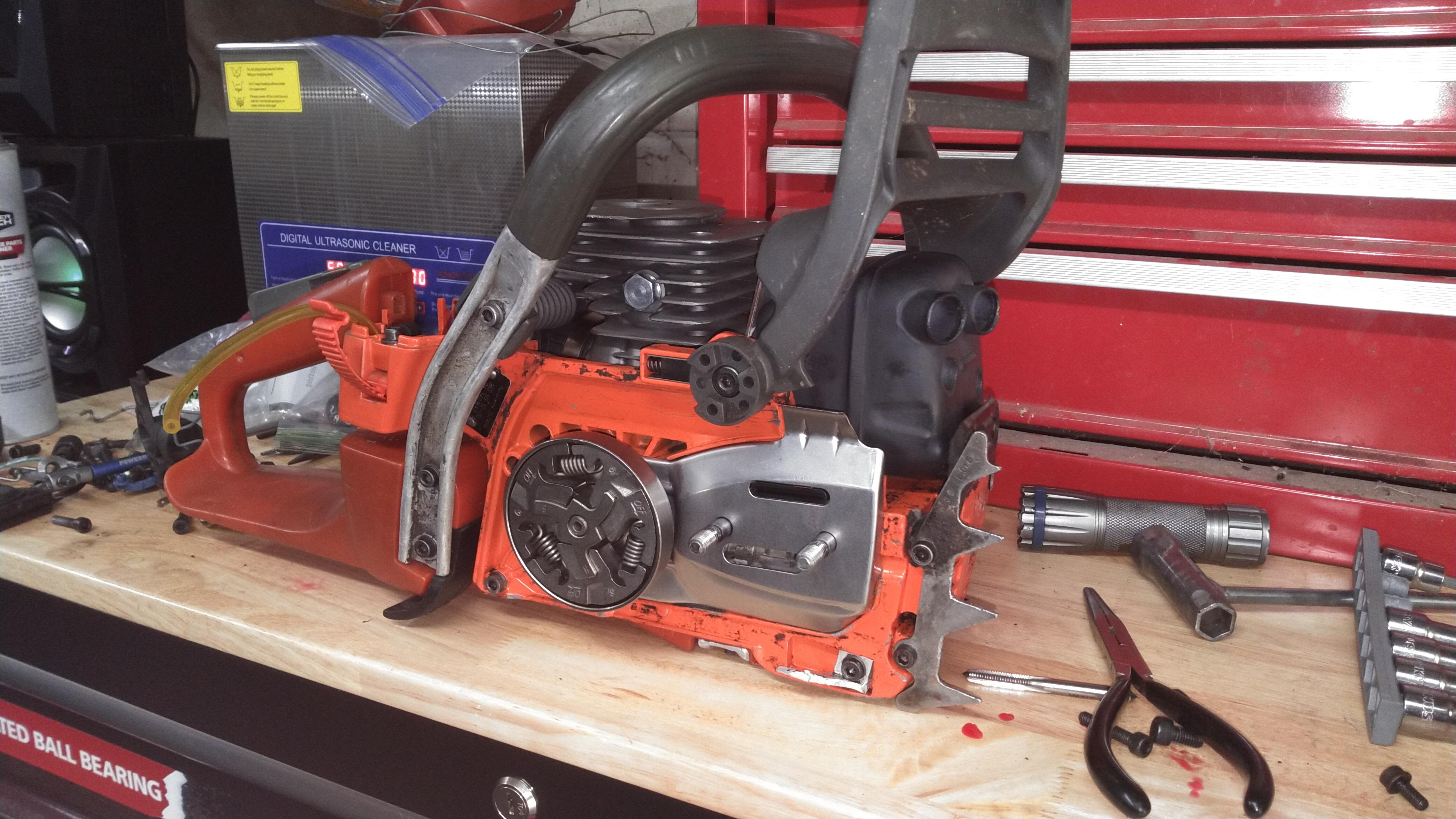

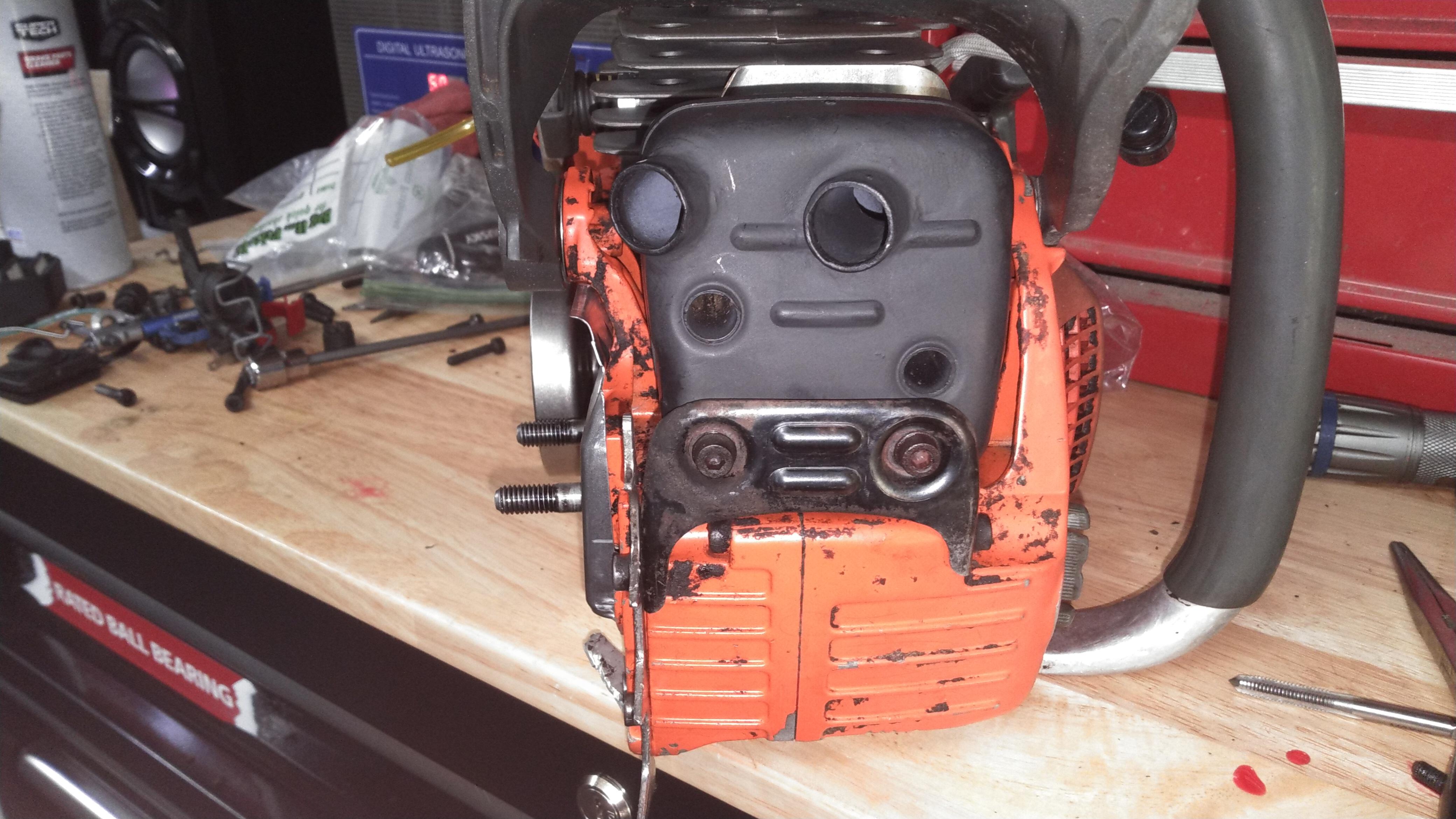

Clean up night here, organized tools, etc.
Stripped the 435 down, cleaned it, ordered a new carb for it (Amazon carb) and found I had a 16" bar for it. Hopefully in a week or so she'll be up and running! Found that someone was in it who really didn't know what they were doing.. double gasketed carb, etc..
