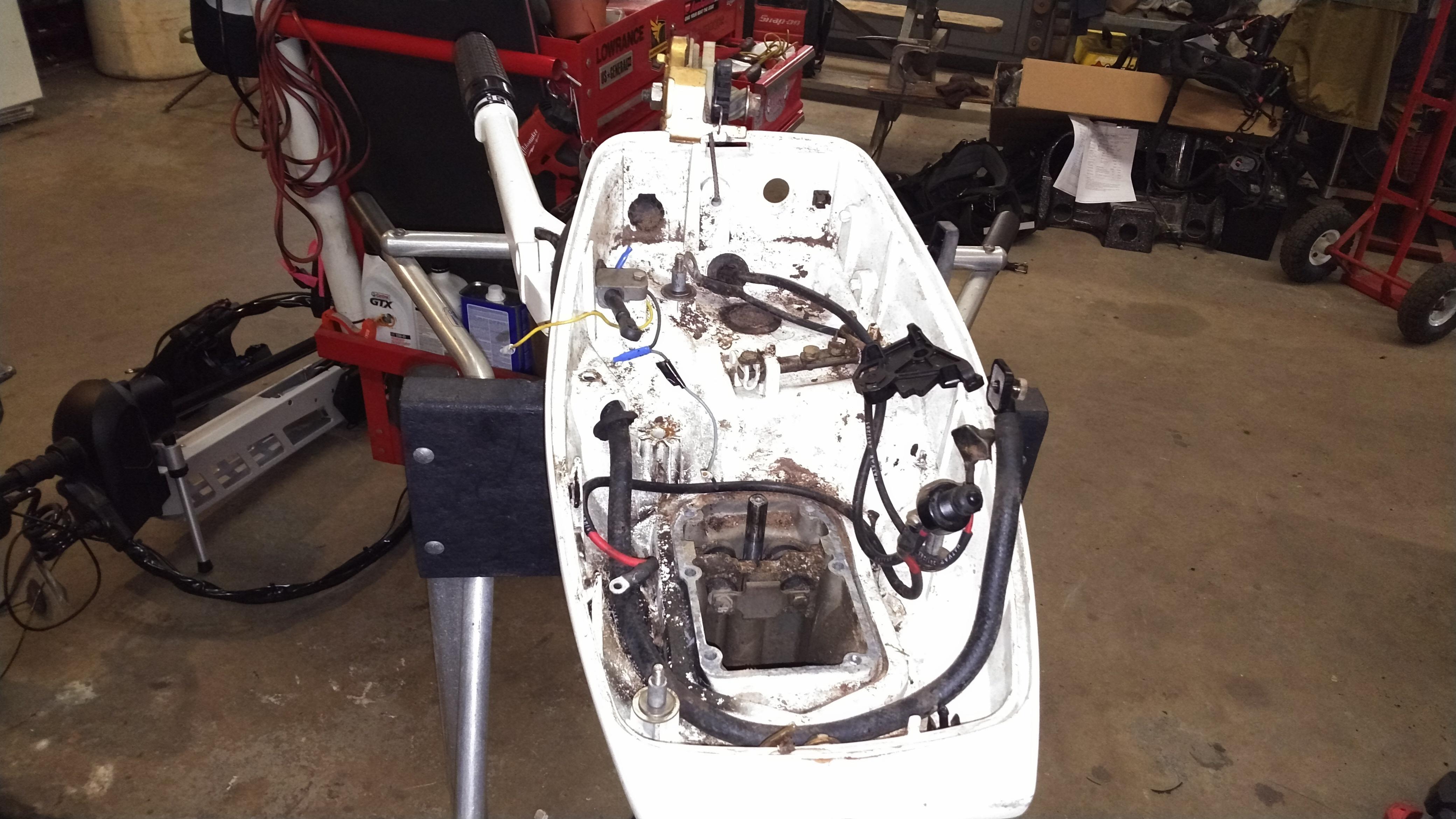

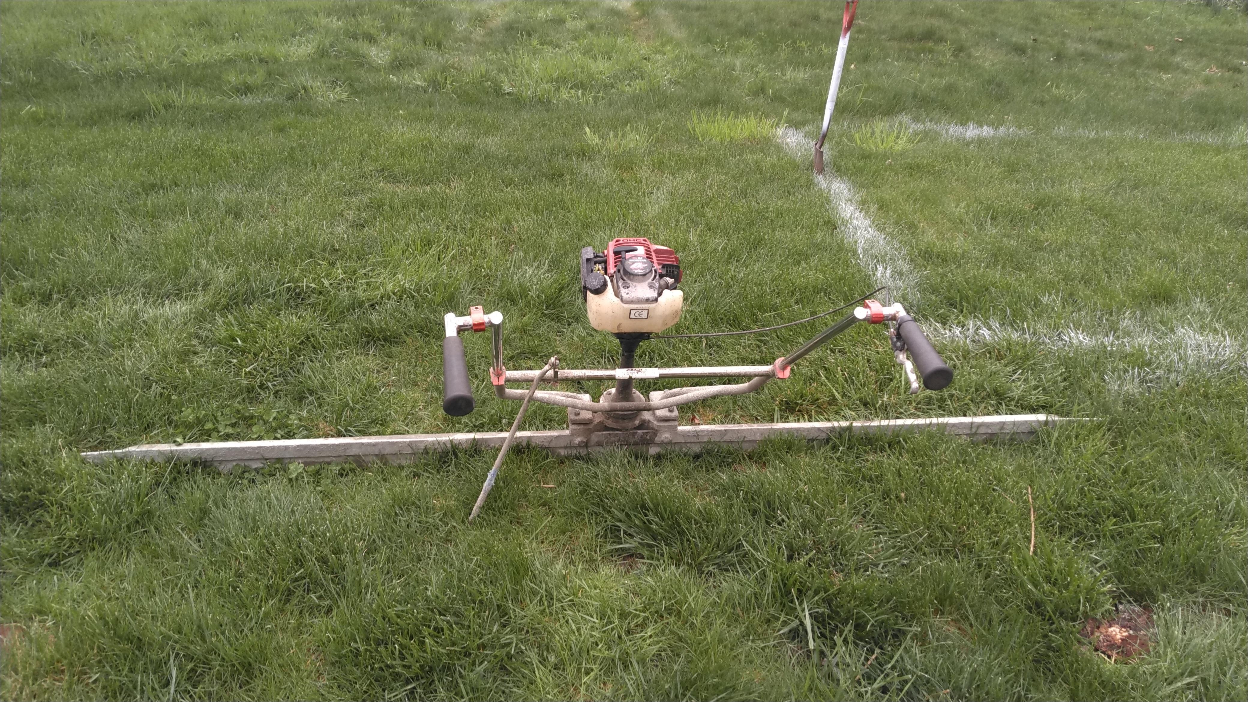

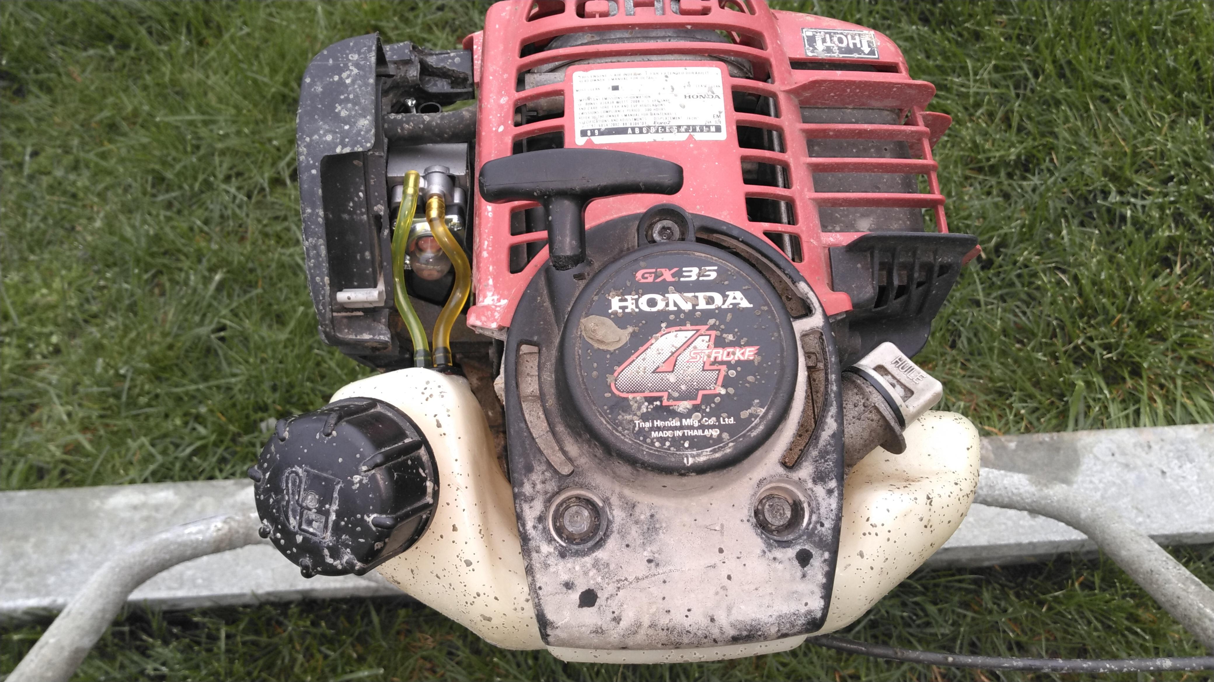

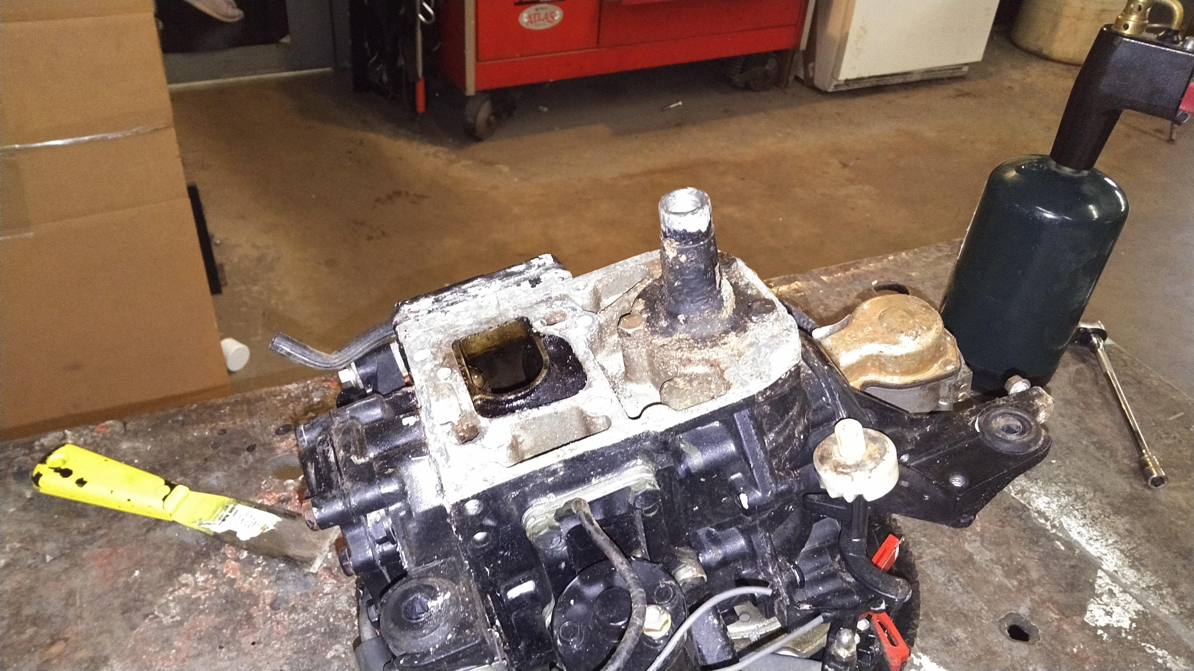

This was today.. Johnson 15 hp that wasn't pumping water. Water tube grommets were swelled up restricting water flow. Thermostat packed with gunk.. getting new grommets, thermostat, water pump kit, etc and the electric start is getting repaired. After work I put the new carb, fuel lines, filter and a new plug in the Honda powered power screed. Runs excellent just want to run it again tomorrow evening.
