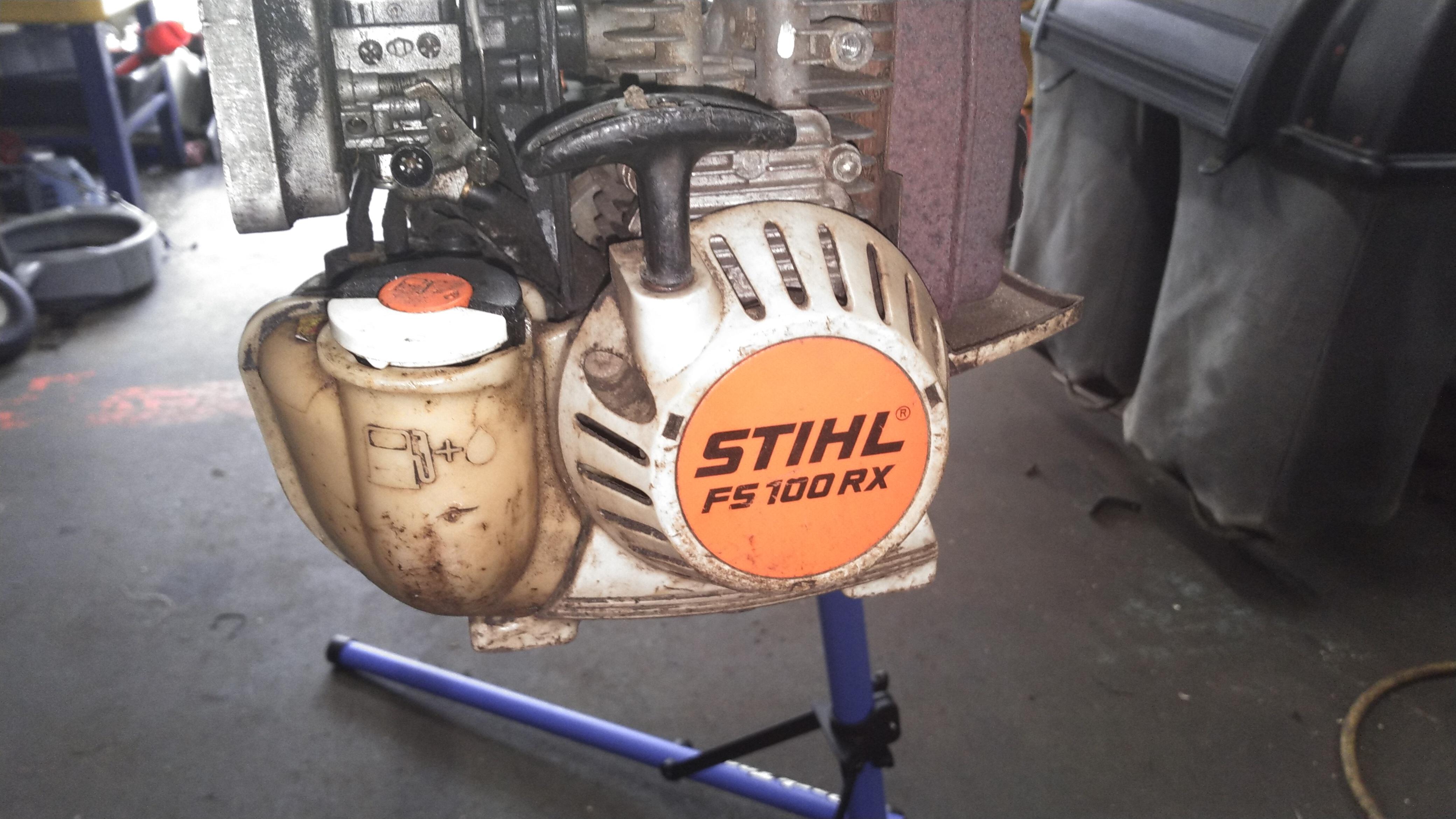

FS100RX with a suspected faulty coil. Any ideas guys?
could be coil, also...
check valve adjustment.
check muffler make sure not clogged up.
the 4 mix engine is bad to carbon up when not used at full throttle. little sea foam throttle body cleaner will help, 3 sprays at full throttle to it almost dies and then one good spray till engine shuts off, let it set for about
10 mins and then hold at full throttle, seeing fireworks coming out of muffler is normal lol .
check for cam lobe wear .
check came lode and rocker guide holes for wear seen a many wore out .
check for valve guide wear
i think the shaft tune is wore out
does the trimmer have the guard on it?
feeler gauges going out monday. ill send a good used coil too
WillG
9:21 AM
10686
Oct 10, 2019
1,730
9,060
Norwich CT
Checked valves, ok
Muffler isn't carboned up
Confirmed faulty coil this morning. Ran same way as last night with stop switch wires disconnected. Good spark at dead idle but as rpm increases spark becomes erratic. Seems like stuck at idle timing or rev limiter portion of module faulty and engaging rev limiter too early. Started on second pull this morning.
No guard on it, machine is used commercially, I know it's not good to run without guard but that's his choice. I did have it running okay last night. I'm 99 percent sure that the coil will solve the issue. Once coil is on I will load test in the yard.
