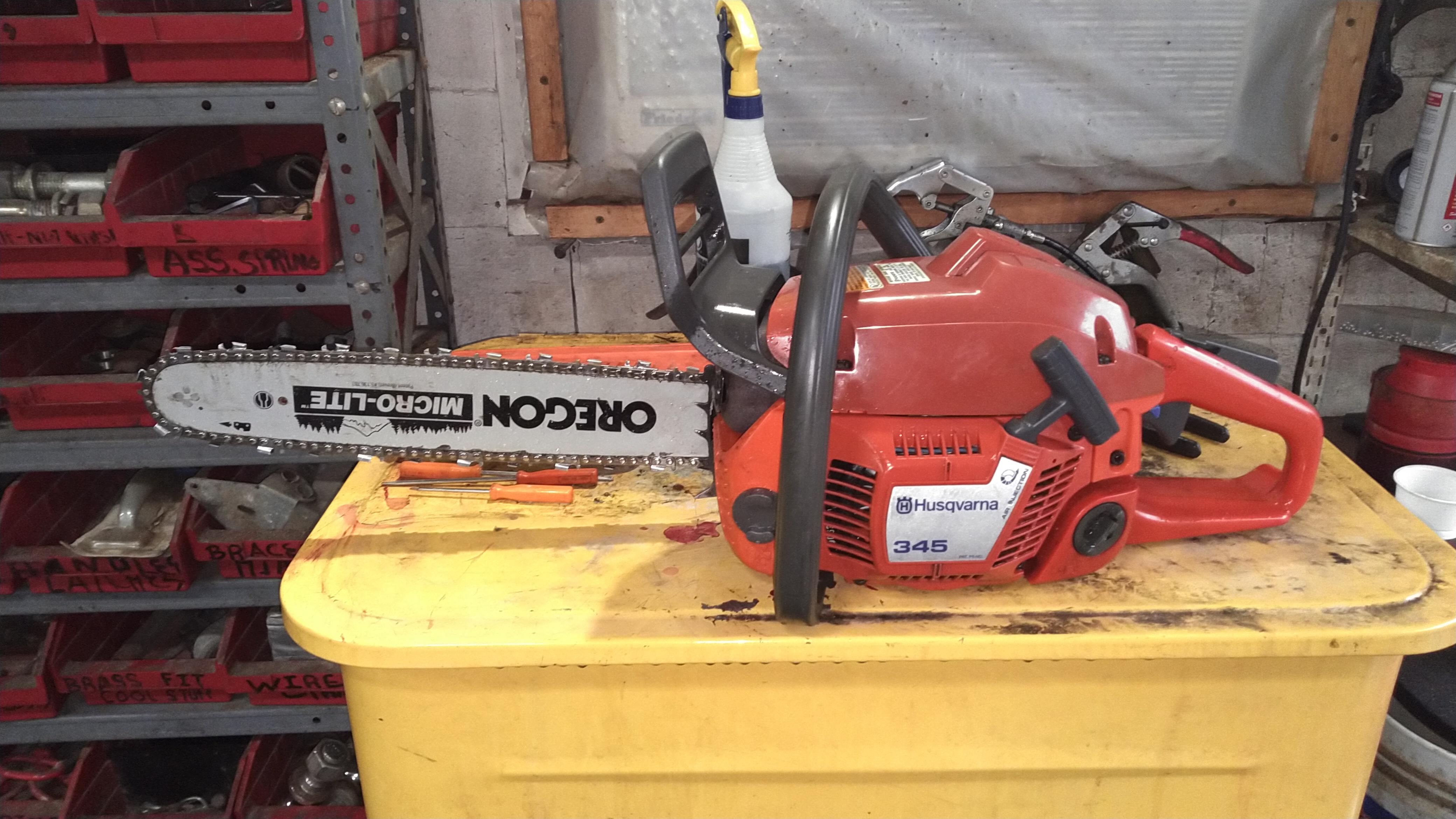

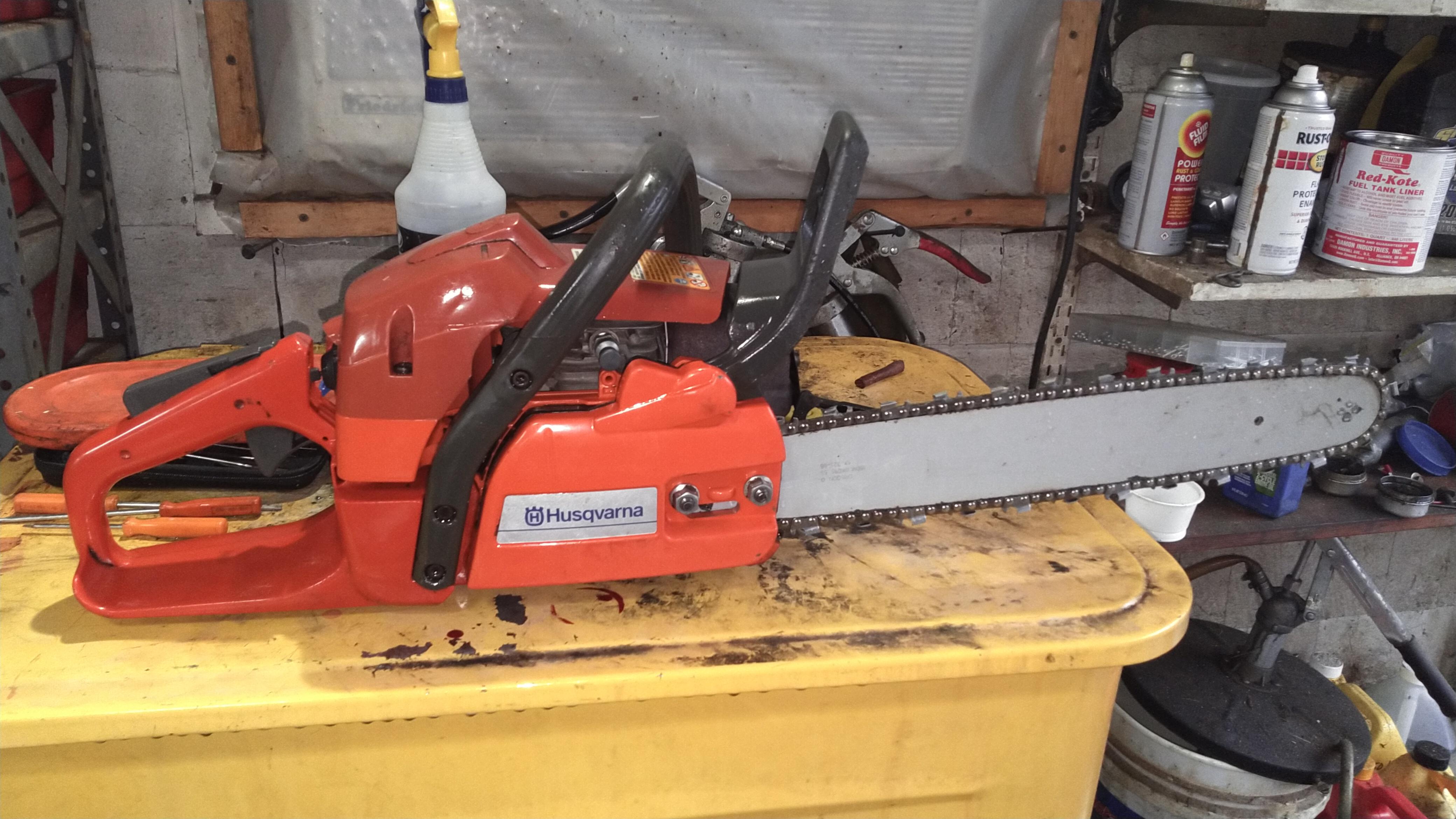

Final test run/tweak/cleanup on the 345. Turned out awesome. Doing some cleaning in the garage later.
