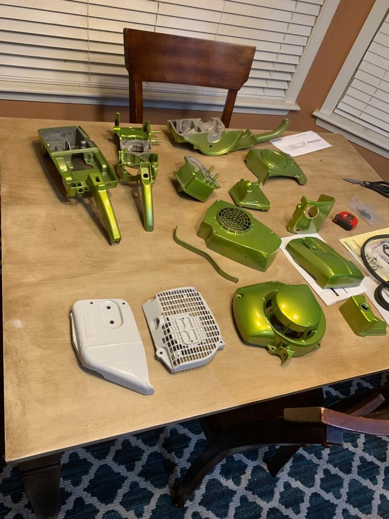

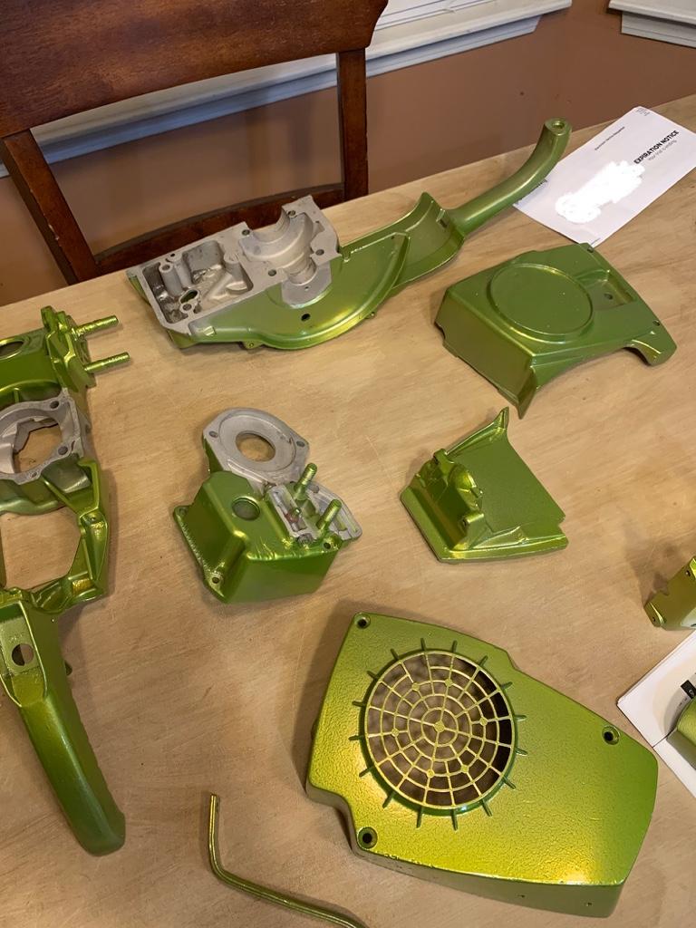

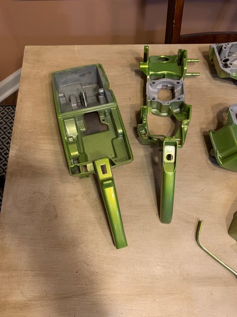

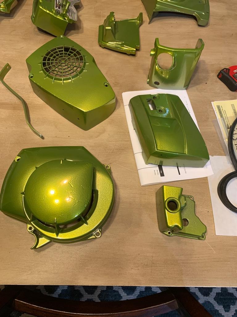

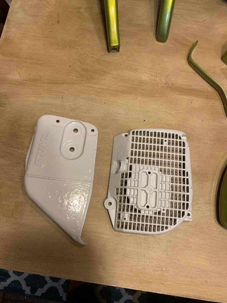

I did a lot of powder coating over the last 2 days in between working on weedeaters and doing some landscaping around the house. Pretty time consuming with only a toaster oven to heat parts in.
Looks great Brandon, I like that green!

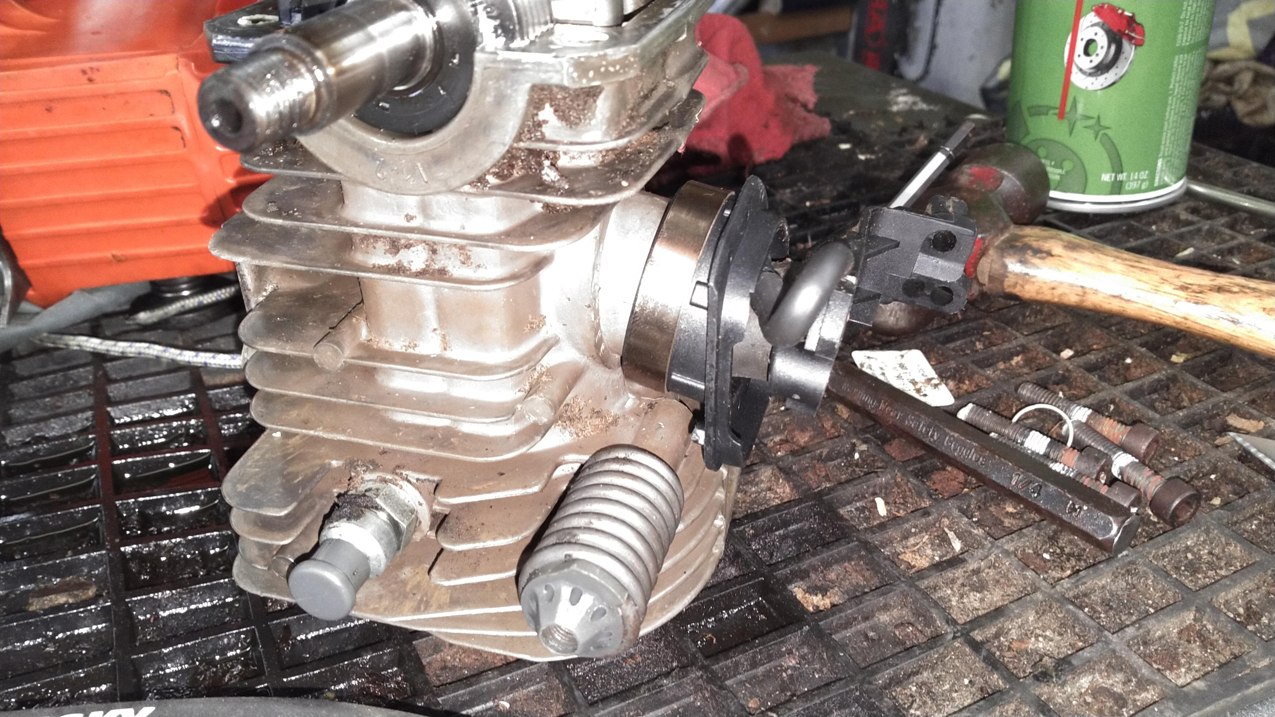

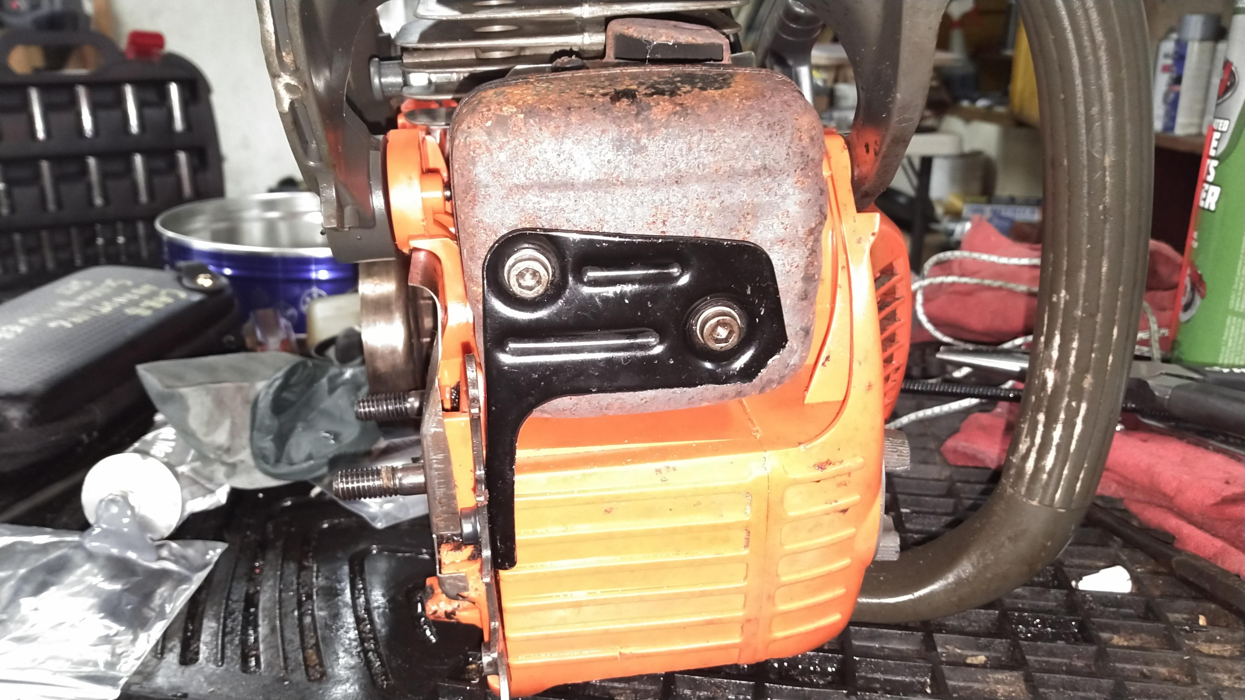

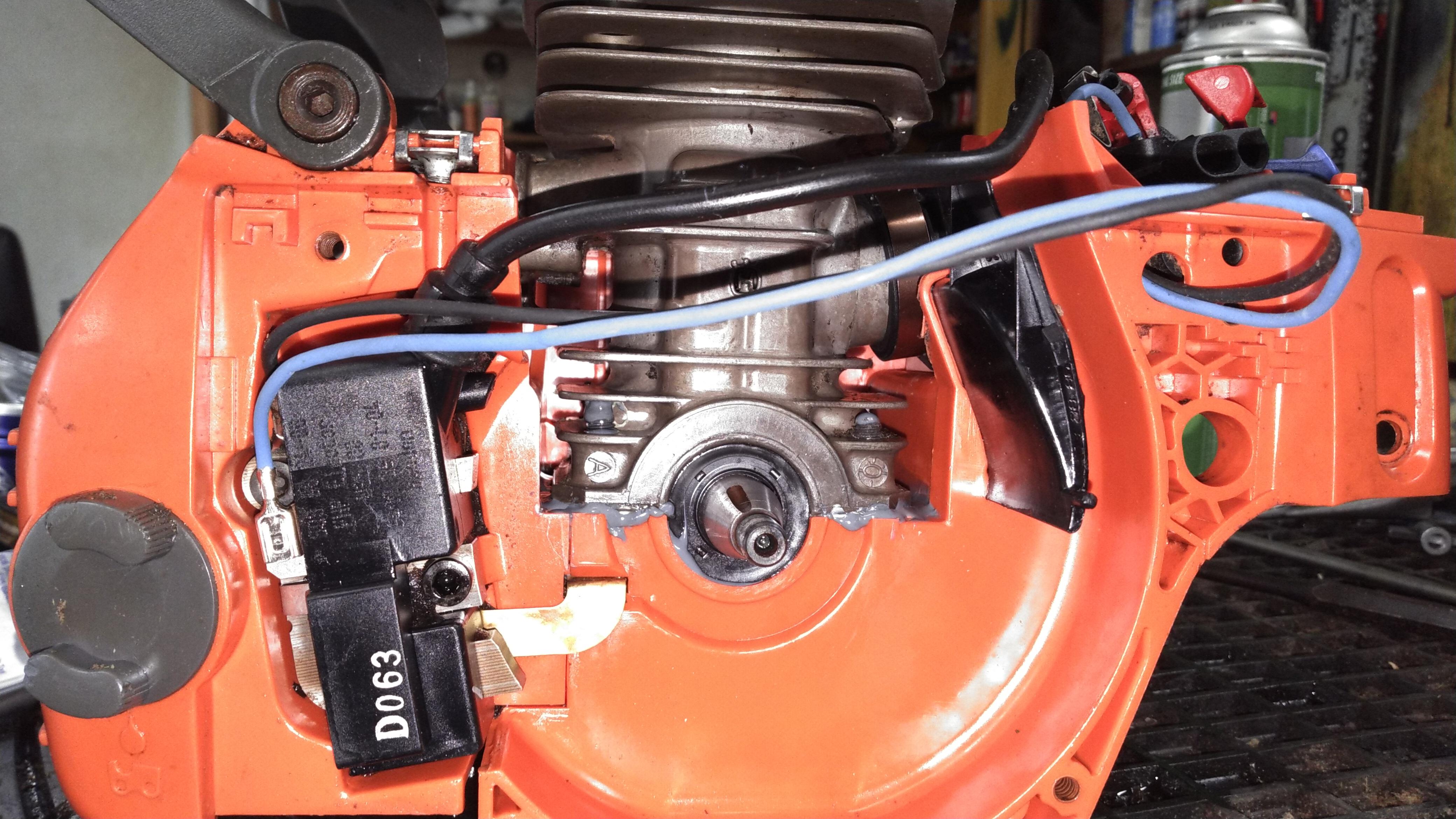

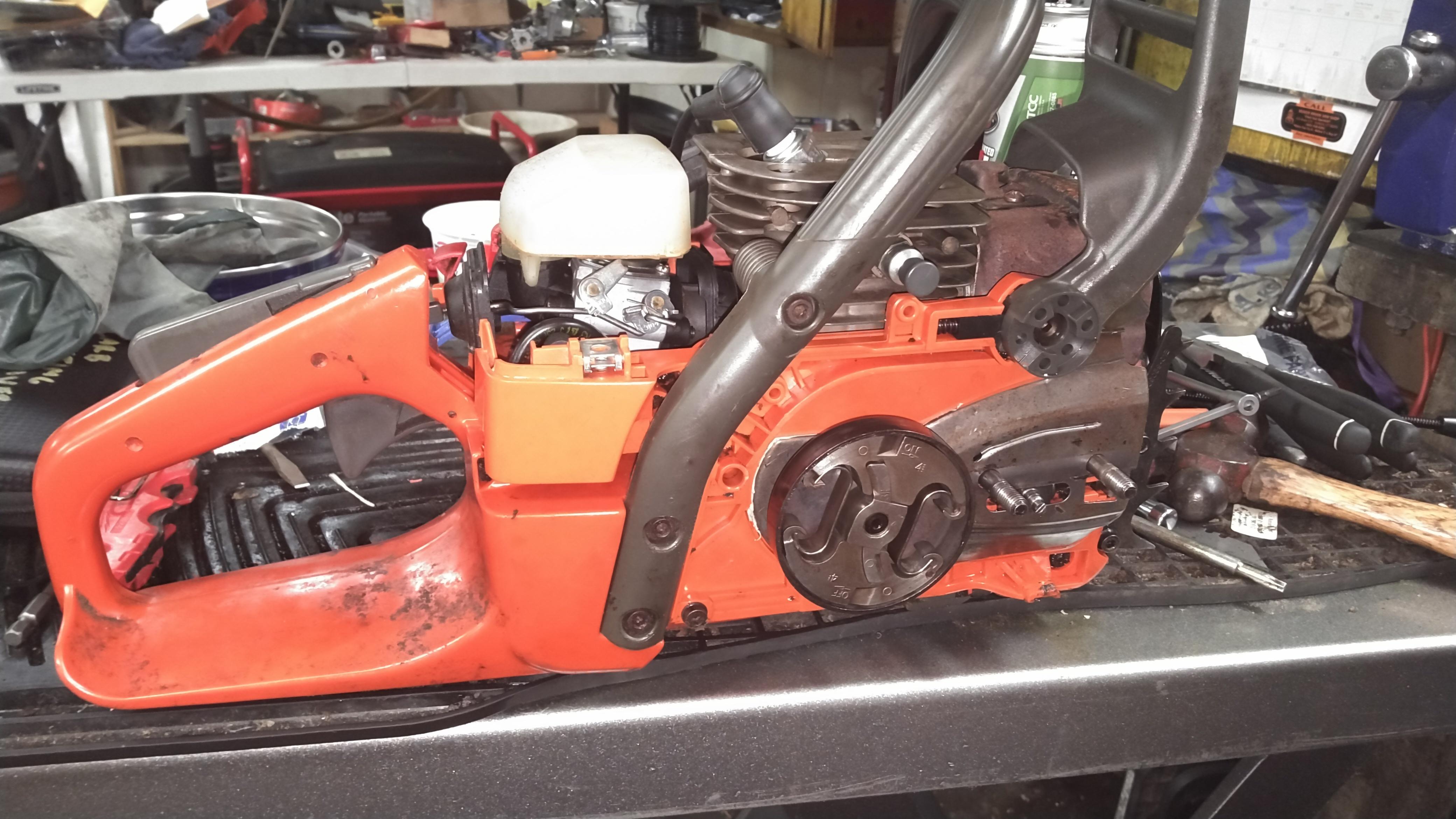

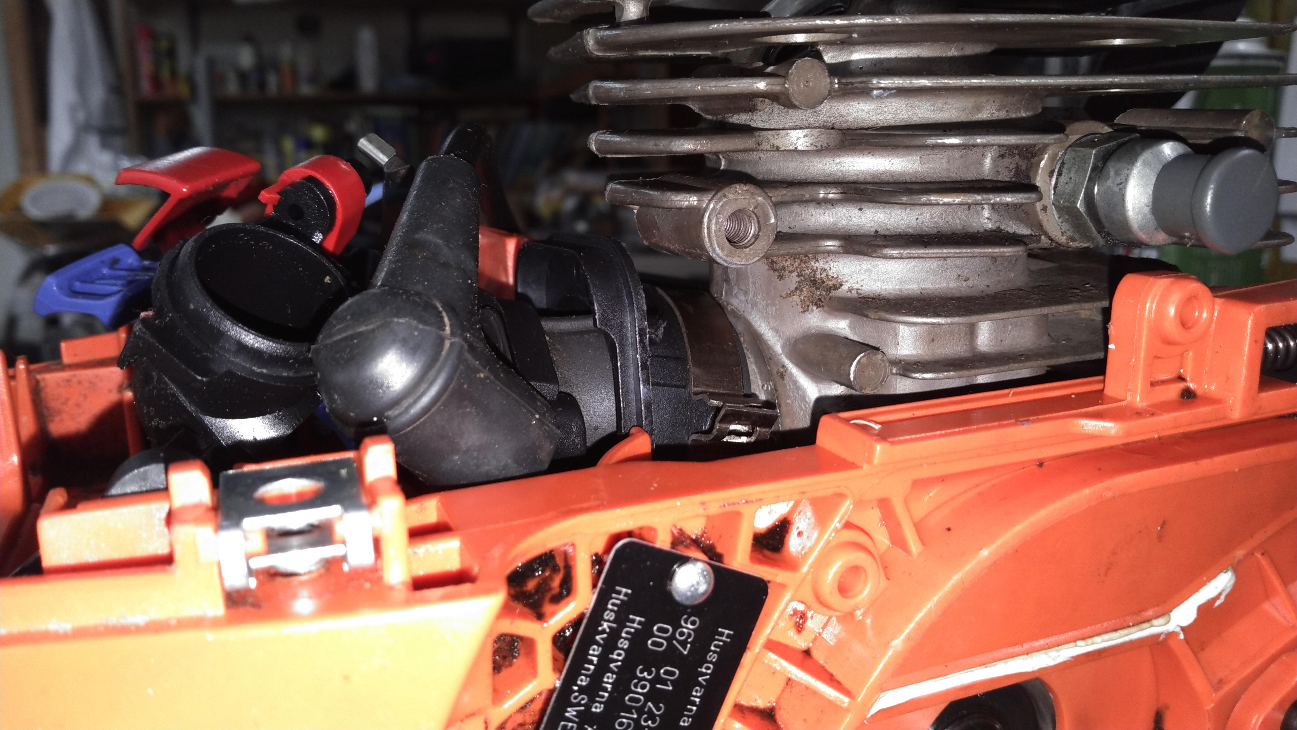

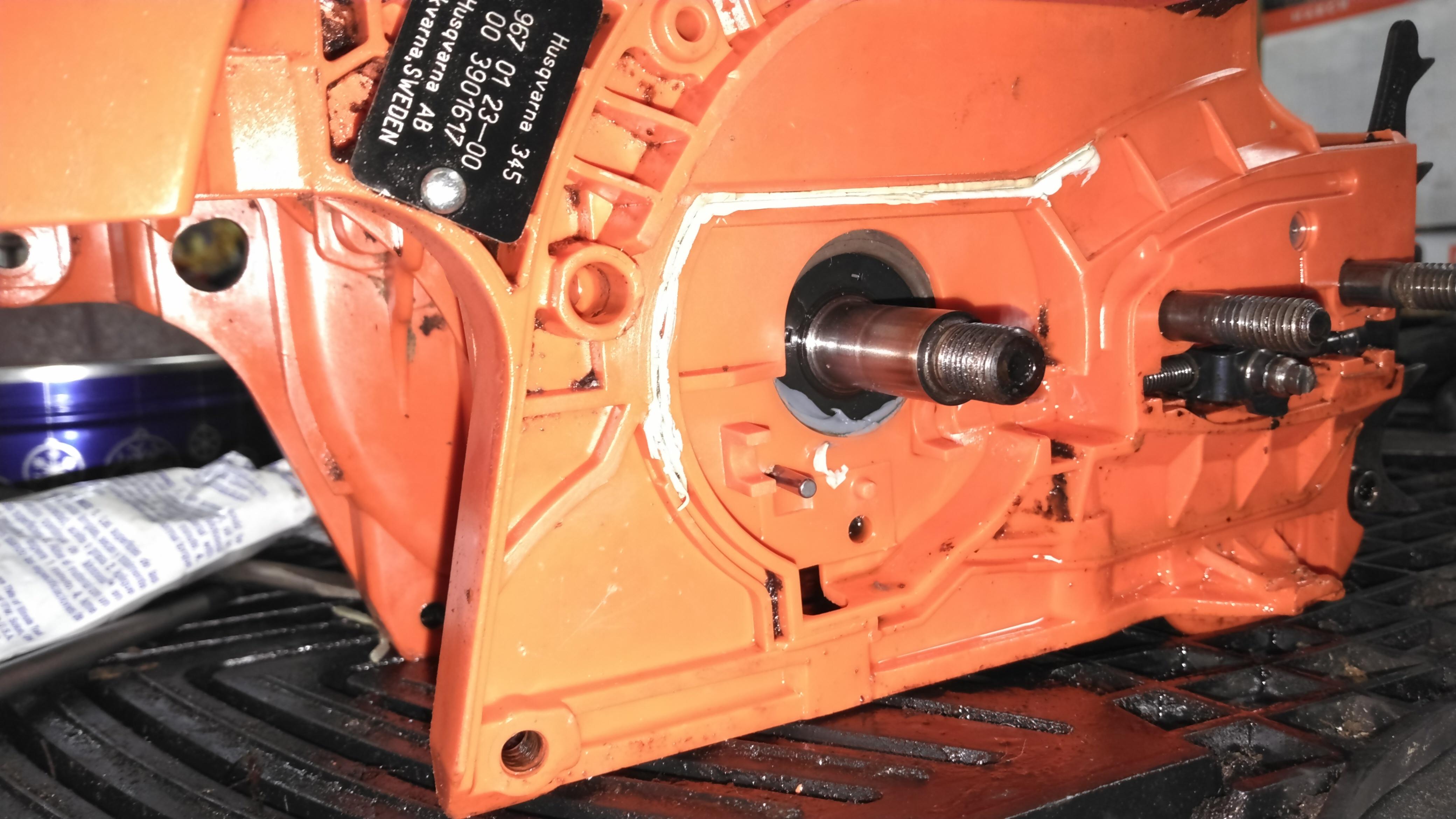

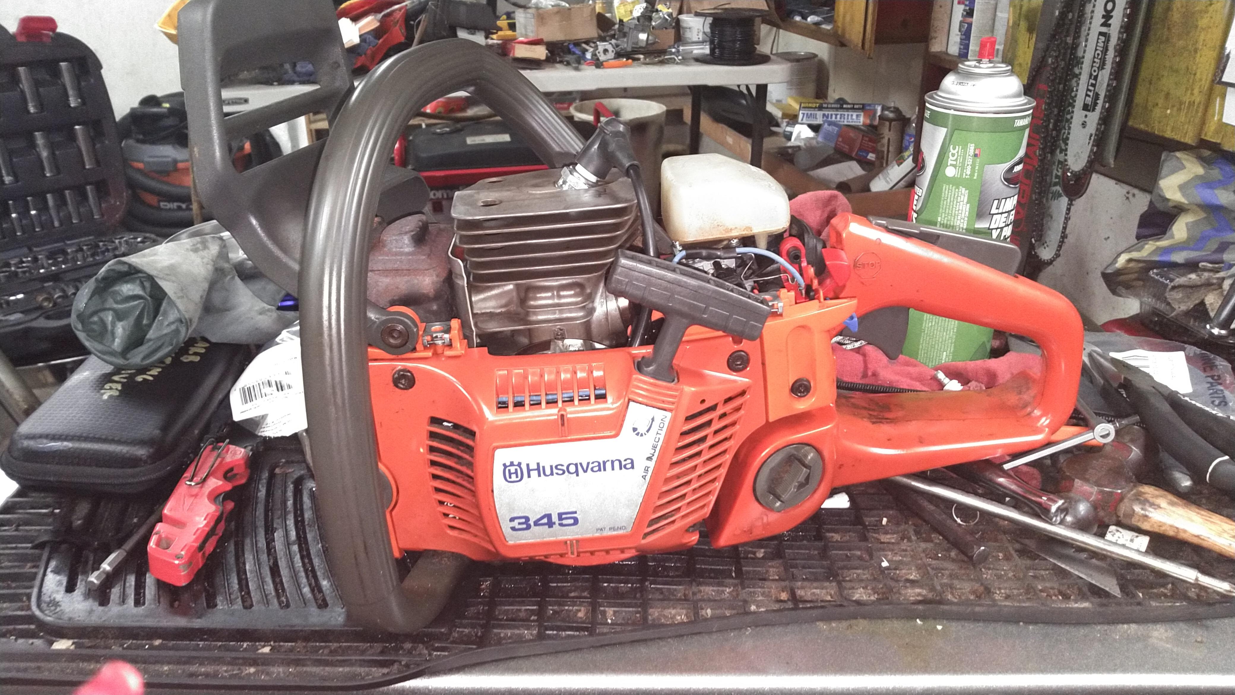

Husky 345 that got a base reseal, metal intake clamp update, muffler support addition, carb kit and service. Also got a complete cleaning. I'll have it running in a day or two. I've had good luck with letting the MotoSeal cure for a day or two before running.

All back together minus top cover and bar/chain. Again, just need to let it sit for a couple days to let the MotoSeal cure fully. I'll post video once it's running.

Nice, what sealant did you use?
I'm using the Permatex Anaerobic Gasket Maker #518 (the large tube is 51813). I would not use it on clamshells, but when your cylinder has a full flat mating surface it is great stuff. Just make sure it is very clean first, I always use some brake cleaner before putting it together.
You don't need much of it, and the excess can be wiped or washed away (it never hardens if it is not compressed).
I know not to use it on clamshell saws due to a video I watched by @Mattyo . I have had good success with MotoSeal.
