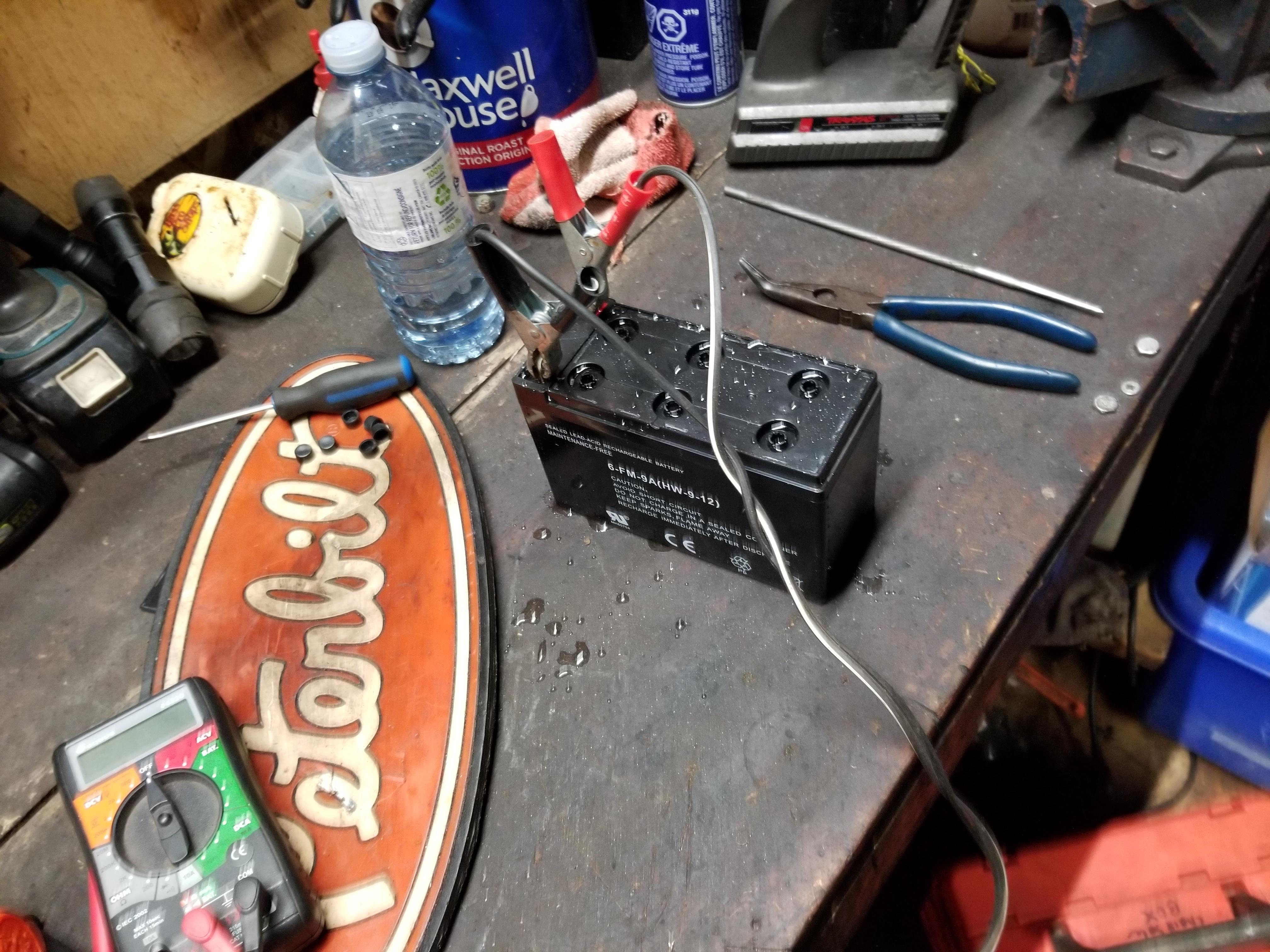

Seeing ifi can bring this generator battery back to life. It was under a year old when it stopped taking a charge.

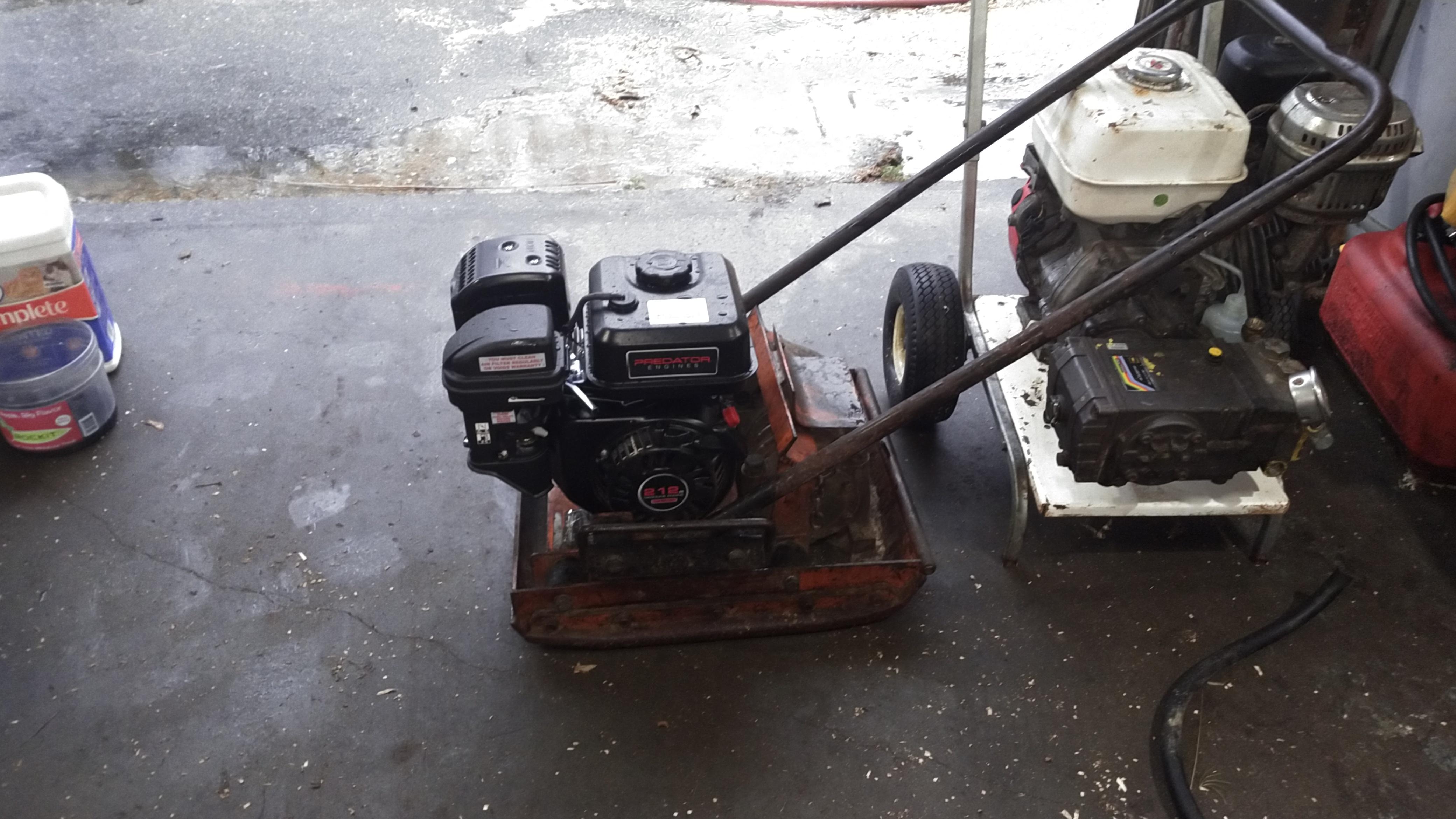

Plate compactor engine replacement complete. Runs sweet! Customer is picking up later tonight.

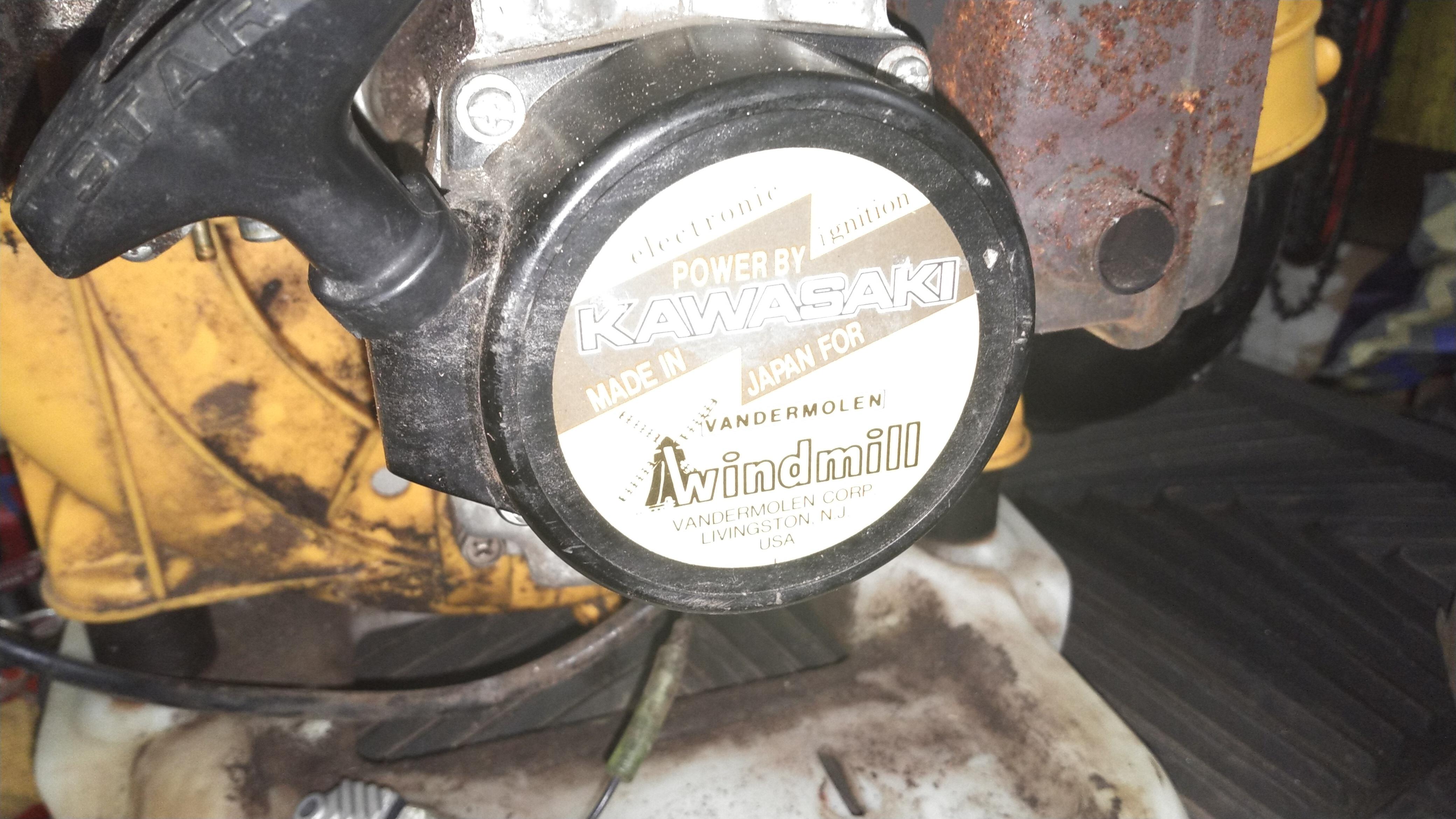

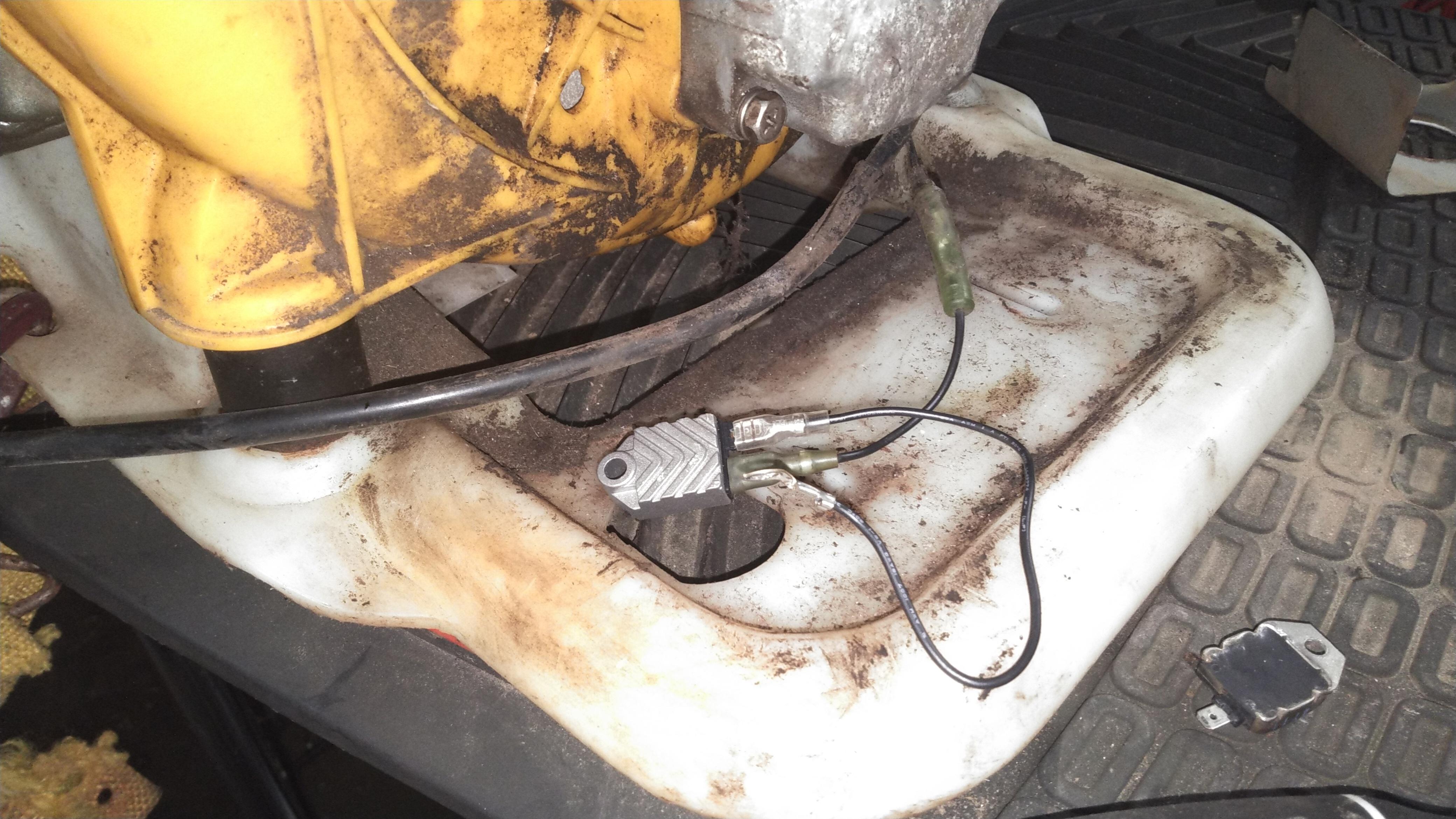

Installed the new ignition module on this old Vandermolen Windmill backpack blower with a Kawasaki 2 stroke. Has spark now. Gonna mount it properly after work tomorrow (need to get a longer screw and it's metric) and toss some fuel in it and see if it'll run!

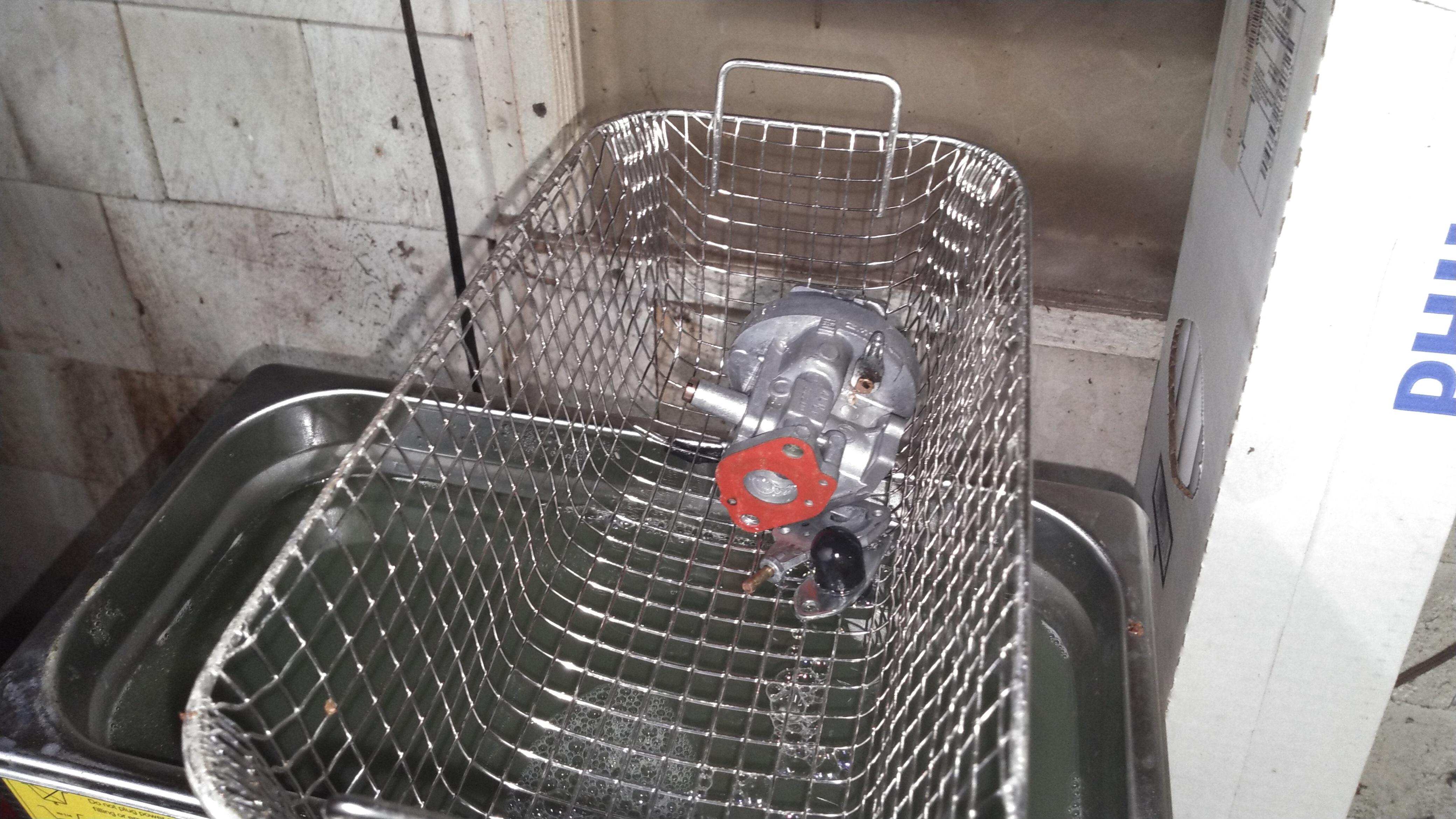

New ignition module mounted in the original spot and she fired on a prime shot. Carb is taking a hot bath and I was able to find a new old stock fuel pump diaphragm and gasket on eBay.
