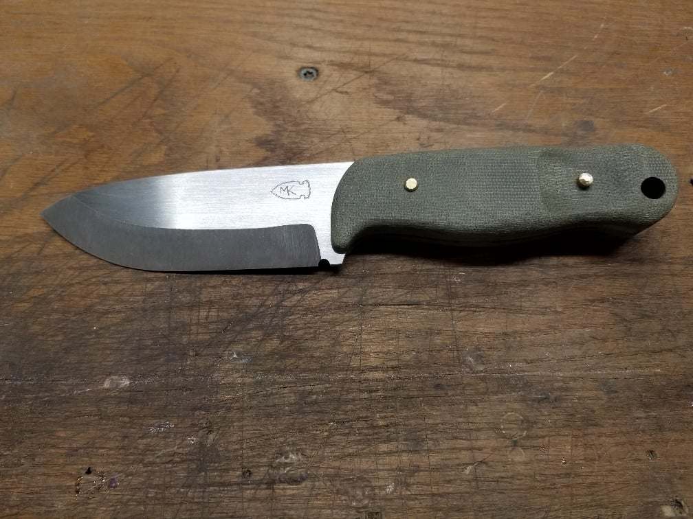

@huskihl knife roughed in
Mmm. Dat’s niice

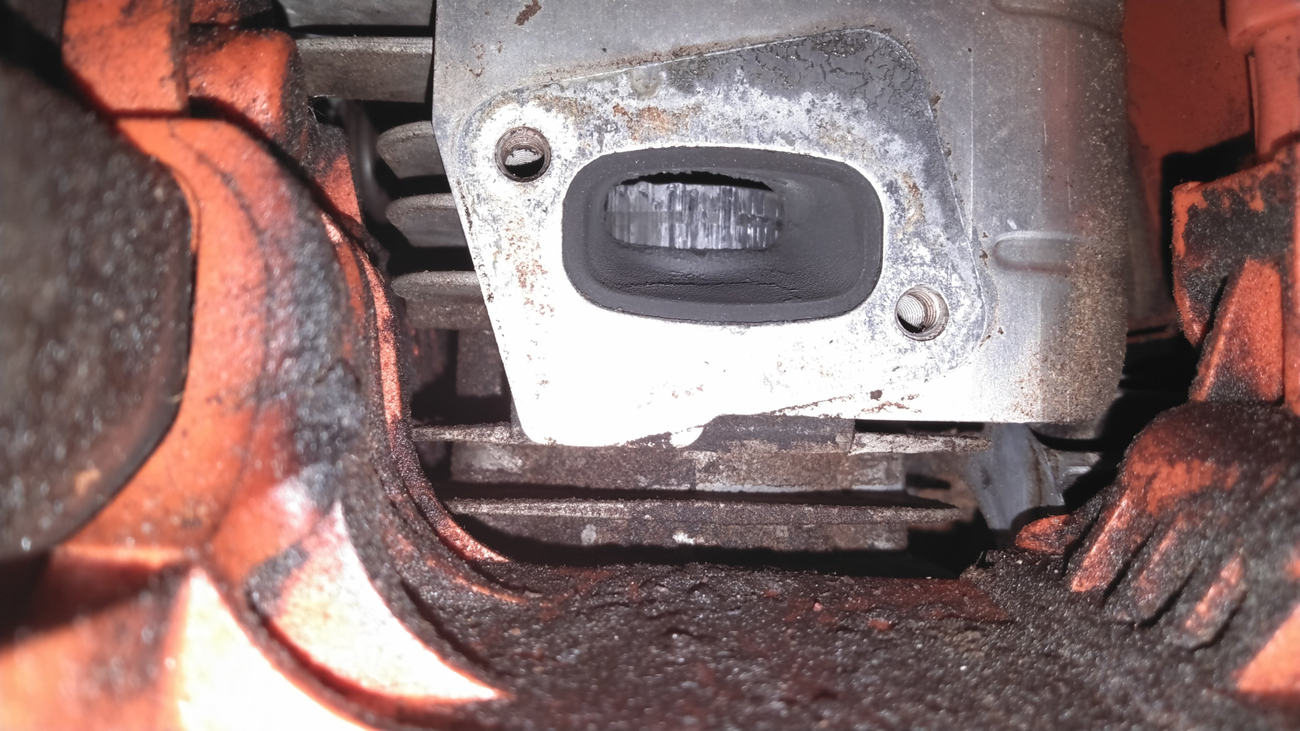

The Unicorn with 13.5 thou off to true up base, which still left a small ear. It’s a head slapper, and not by a little.
Was probably sent to me with a squish of less than 10.

Is their going to be enough meat left in the transfers to raise them back to were they need be?
Honestly, no clue.
The machine work is so off, I just don’t know what to expect.
It’s gonna go on my own saw. Ran out of time yesterday, plus got pissed off.
The only certainty here is uncertainty. Whatever he professed the numbers to be aren’t likely to be anything close.
I’m gonna try a double gasket next, then if I get some squish I will cut band square.
