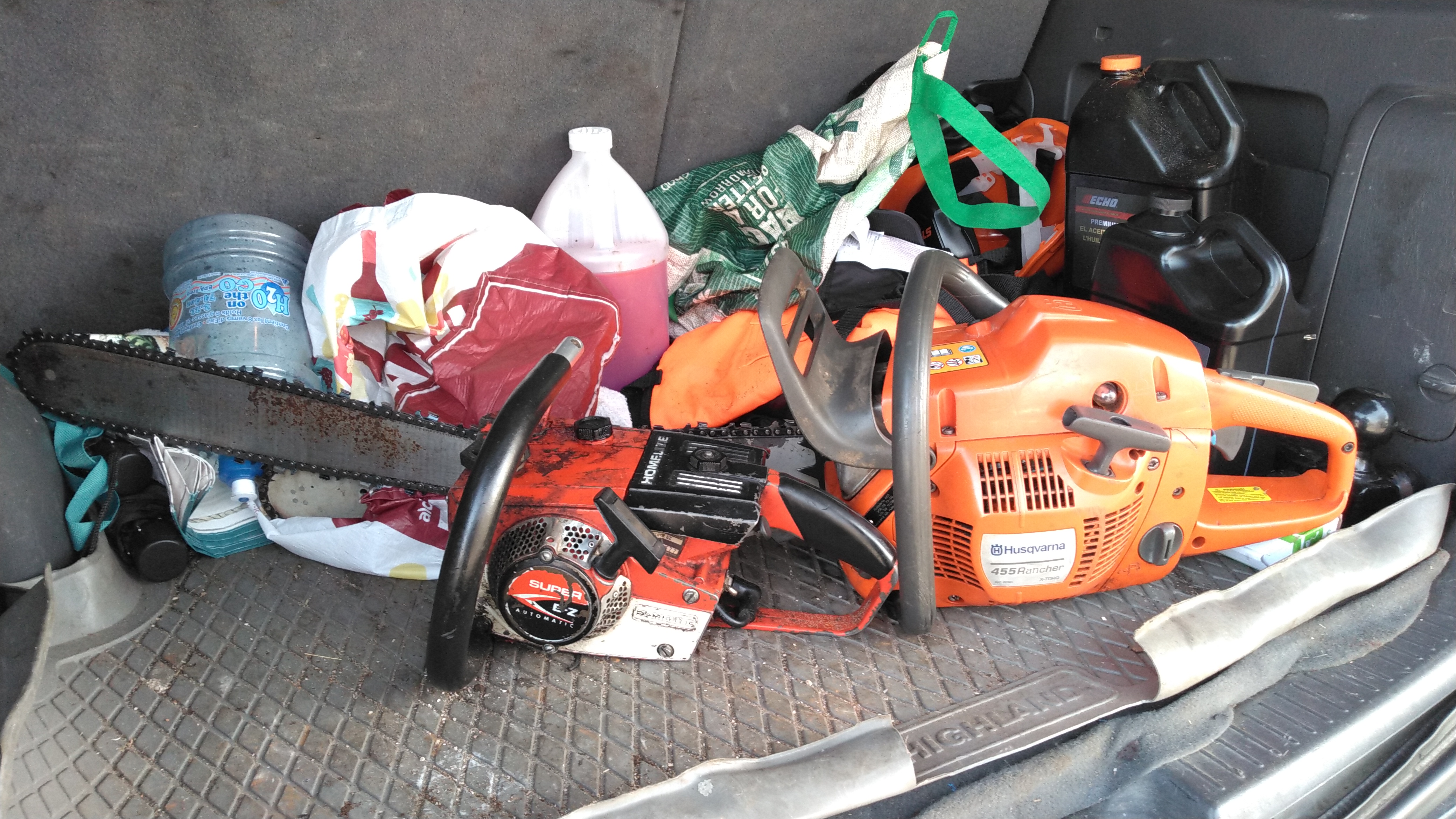

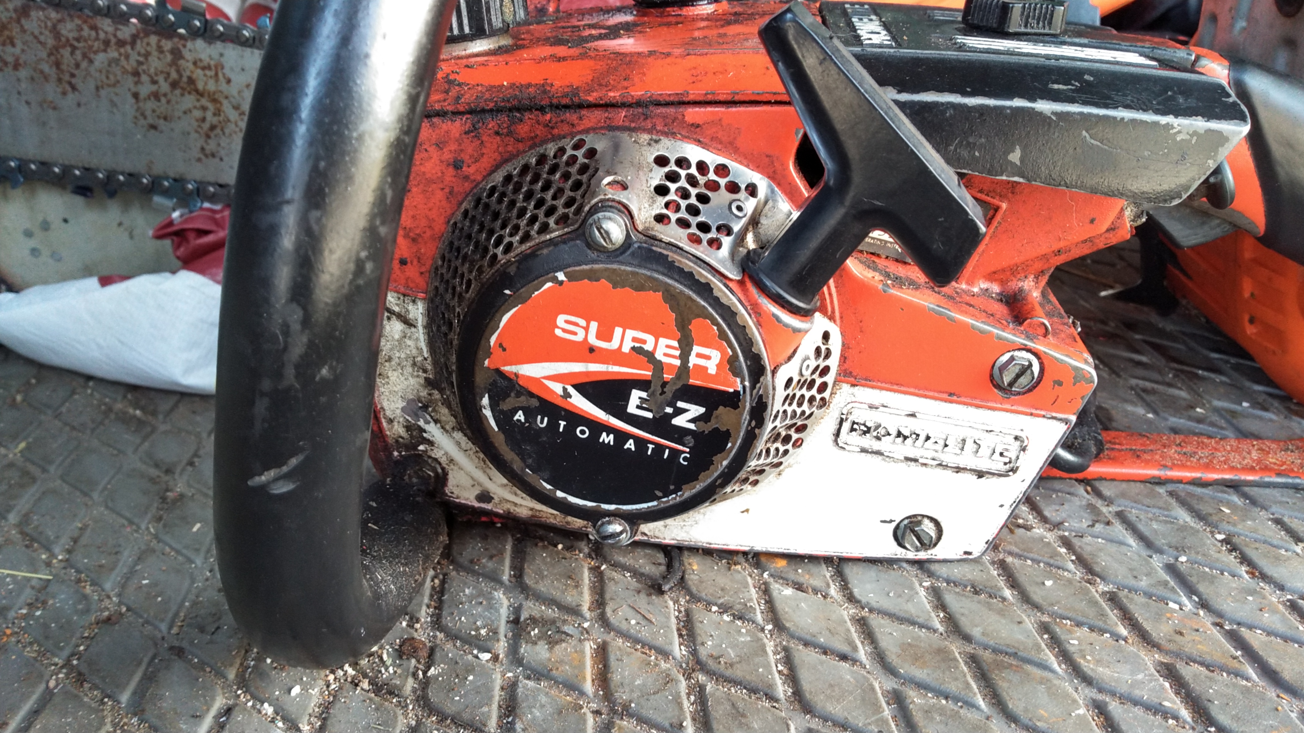

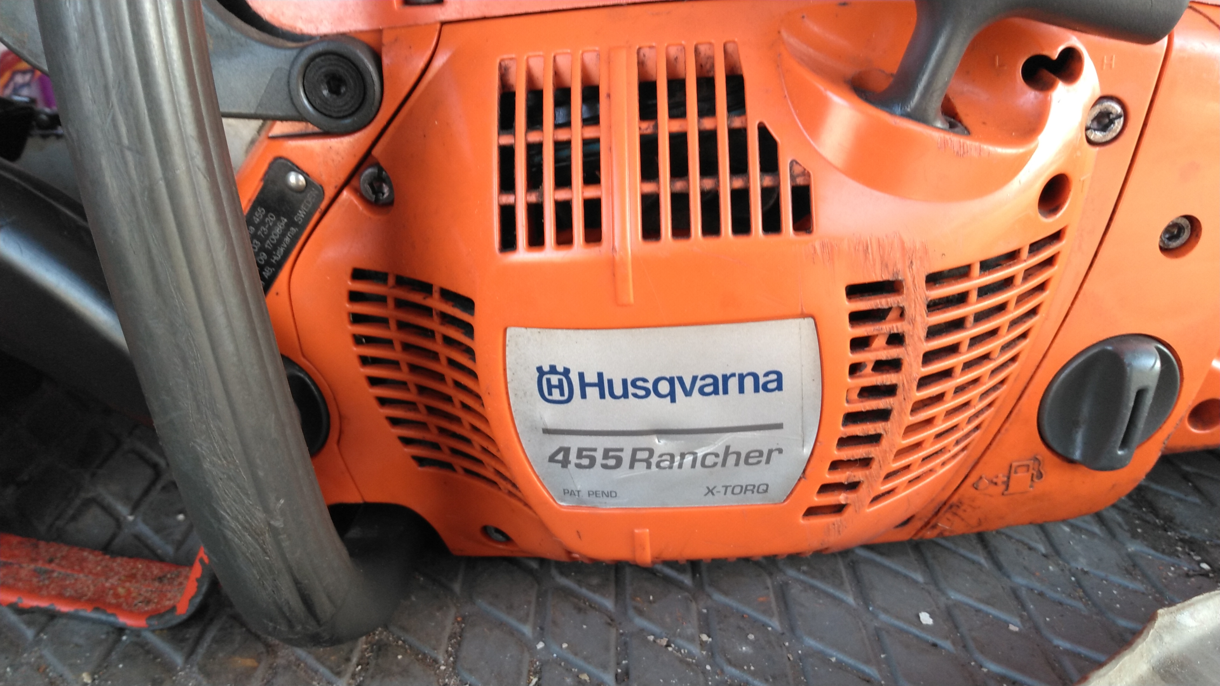

Nothing on the bench today but going to be testing and tuning these: 1974 Homelite Super EZ Auto for my collection and a Husky 455 Rancher I just went through for my buddy's dad.
