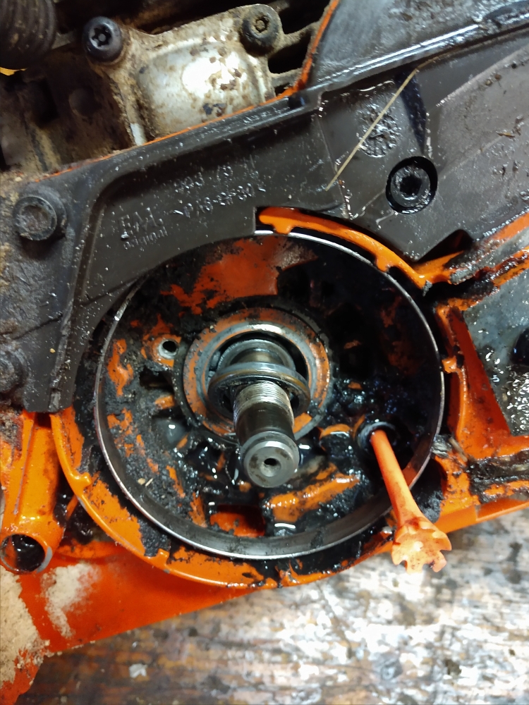

I think this one's danced it's last tango. This things cut a chitload of timber....seal pocket is wallered which means other stuff prolly ain't good.
Some MotoSeal may help with that, seriously. Just smear on the out side of the seal if a new seal will stay put in the bore.
