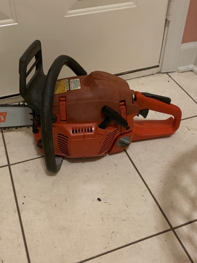

I just finished this Husqvarna 351. Next is fuel lines on a Husqvarna 338xpt, Then fuel line and impulse line an echo CS-440 then refreshing a Husqvarna 261. Then after that a Husqvarna 390 build. I gotta get away from these Husqvarnas.
