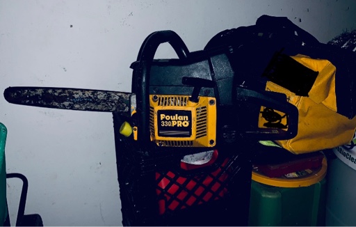

Howdy! I'm new here. This is what's on my bench currently being restored. Got it for free from a junk pile, great compression. Waiting on a new clutch cover [emoji41]

Nice!
And where did you find a cover?
And welcome

Thank you! I found the cover from a parts direct site. It was the last one, $15 free shipping. Chain I'm not sure what to get, I still need to find a cover and refinish that husky bar. Bar is in great shape with no bends or damage. Saw was not stored with any old fuel in it either when I got it!

Damn yous a luck sob finding that cover lol. That saw uses a A041 so a K095 (small husqvarna) will work as long as you have an oiler hole provision made, incase you didn't know that already.
Gonna use .325 or 3/8s?

Yeah I couldn't believe it either! I'm stoked. And no, I didn't know that about the Husqvarna connection, good to know! I'm gonna use .325 with this bar, if memory serves me right it's an 18"? I plan on picking up a 22" bar as well.
