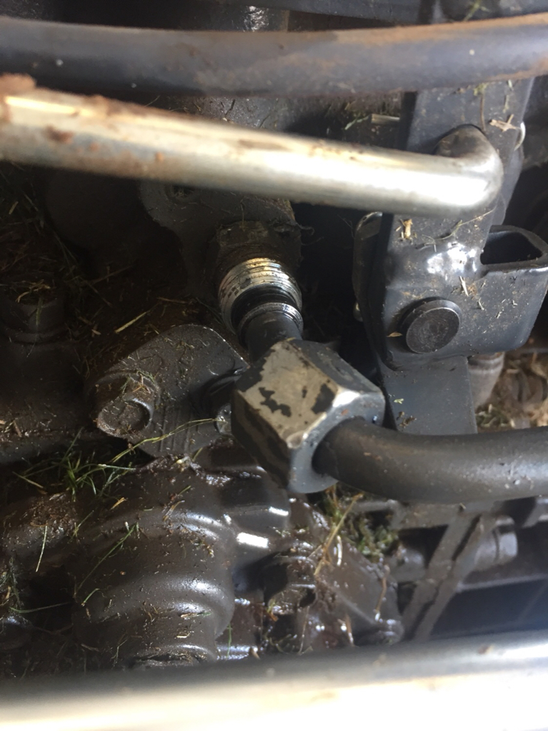

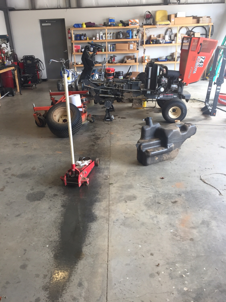

Mower at work had a small leak, figured I’d tighten the fitting. Went to move and shot fluid clear across the shop! 3hrs later the line is off and has a crack just after the flare.
I HATE those things!!!!!!!! The County has four of them, every time I see one the stupid thing needs $2,000.00 worth of work, JUNK!!!!
Do yourself a favor and replace the O Rings at the hydraulic cooler while you have it that far apart. Major pain in the keister to do that much work for a $0.79 part.

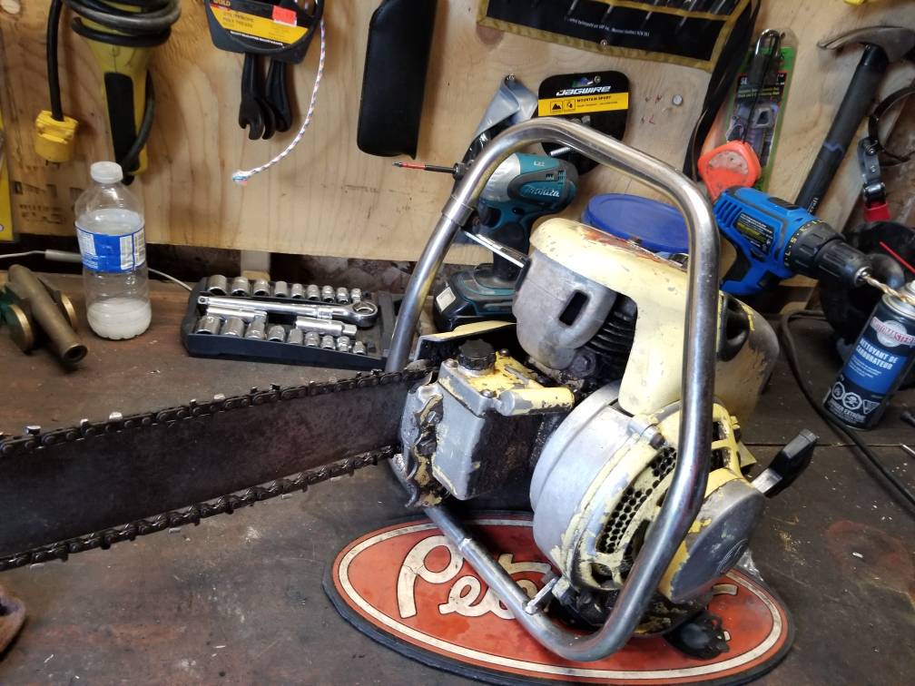

Next in line on bench is the old IEL PIONEER. Need to find a carb kit for it. If anybody happens to know the part number to a diaphram kit that will work please let me know.
That's an IEL model HC.
The carb it came with should be a tilly HL-8A or HL-8AX according to Acres site. Doesn't say which kit it takes
Well i just had a look at it and the carb lower part looks same as the mac D carb. I just ordered another kit to try.
