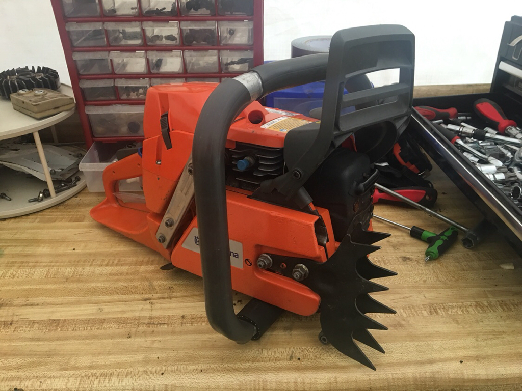

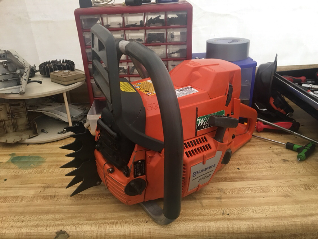

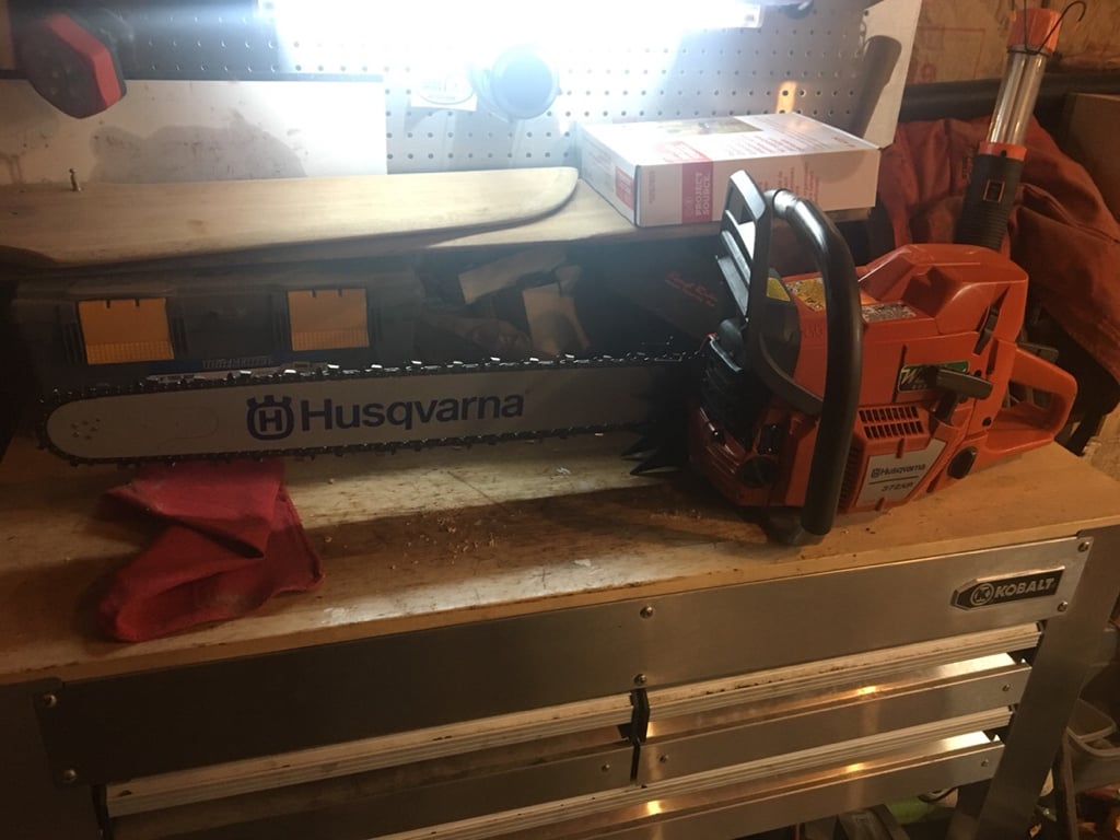

Thought I’d share the dream saw that’s finally on my bench. Behold, the saw built by @Onan18 and @redlight066. I can’t thank you enough for this tremendous gift. By the way, it’s a Husqvarna 372XP OE that’s ported with a muff mod and equipped with a full wrap, west coast dogs, and a 24”bar and chain
Nice runner you had there Bryan
