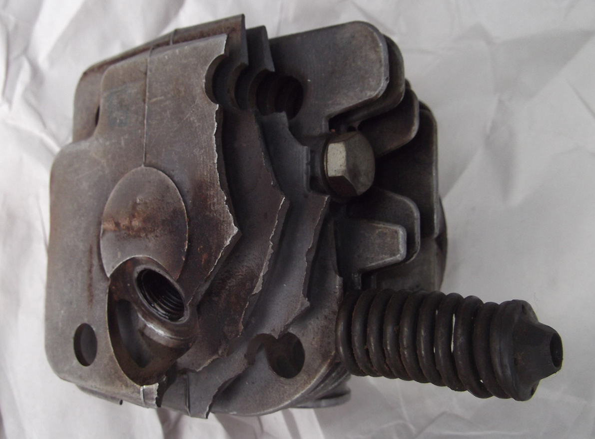

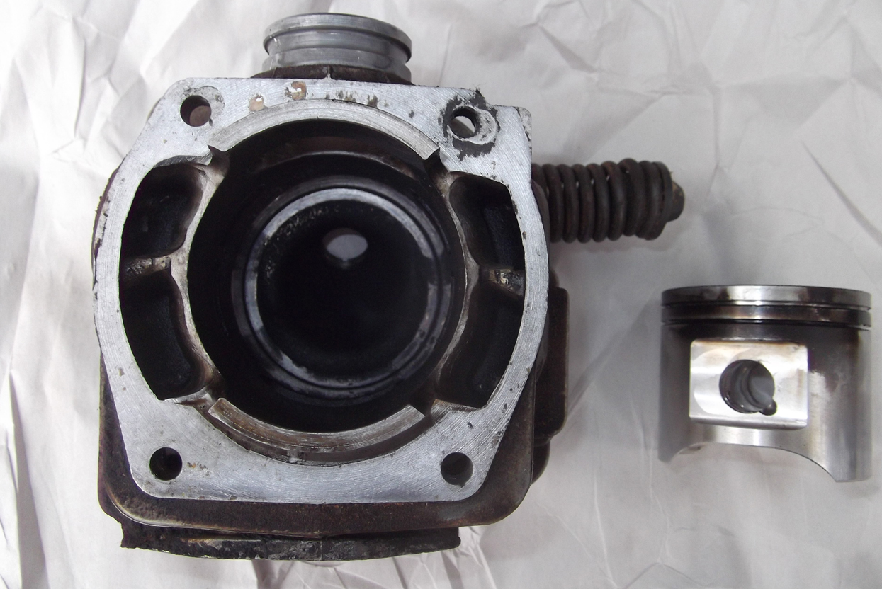

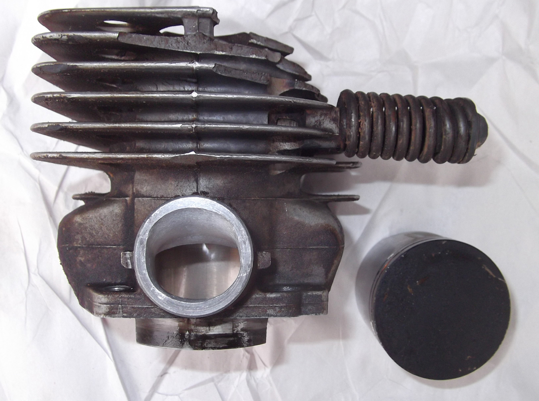

Here's a jug that I believe is from the same builder as Kevin's - it has some exhaust and intake timing and some work to the lower transfers but the uppers are stock.
A Canuckian member gave it to me because the saw it was on was smashed, but I never let a few missing cooling fins bother me. I put about 200 hours on this saw
on a hazard tree falling project I had in the south Cascades on federal ground. I ran a Bailey's dual-ring Wiseco piston in it and it did pretty good.

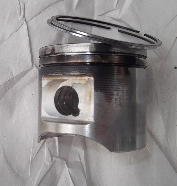

It was fed a steady diet of 89 octane ethanol-free fuel and Stihl Ultra @40:1. There was some blow-by on the Wiseco piston but not too bad.
The ring grooves are clean and free of carbon. The rings show some wear but would likely still be serviceable for another 100-150 hours.
There's perceptible wear on the skirts, but otherwise not too bad for 200 hours of long bar work in dead wood.
Not much to complain about there.

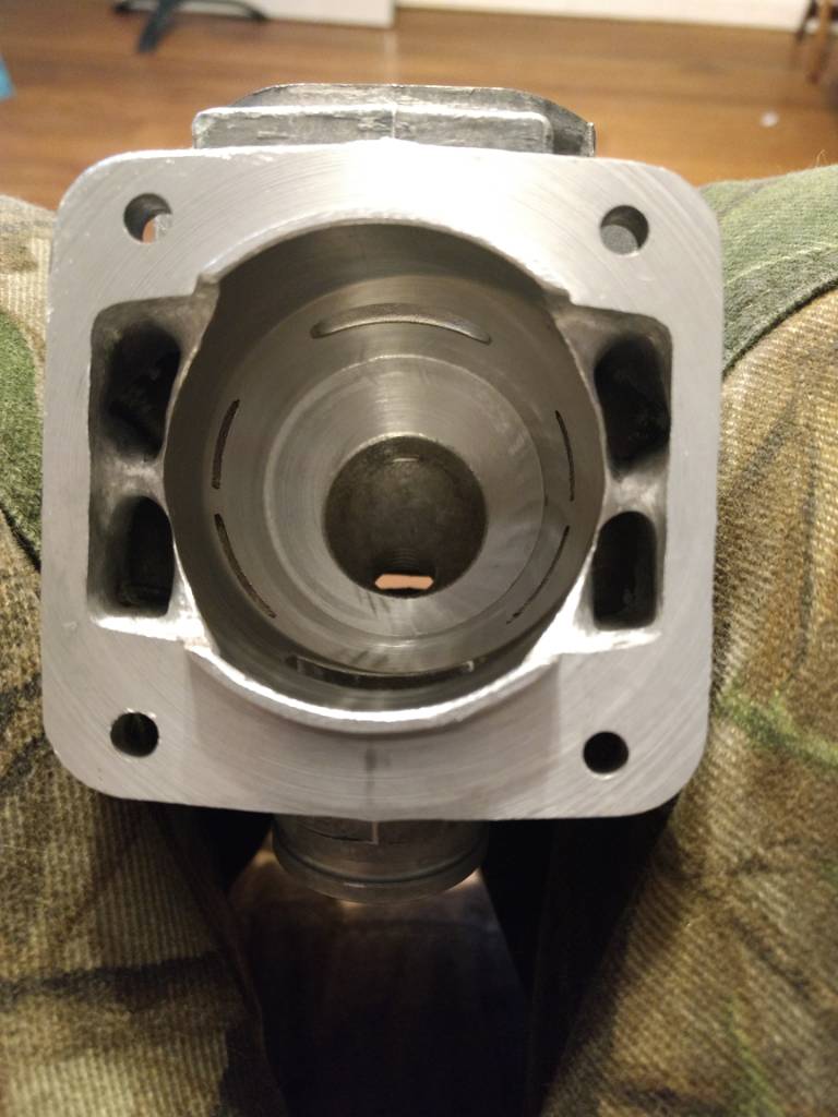

Got a little chatter hand cutting squish, I really need to get set up to cut squish with the lathe..... One of these days....
I had my machinist make up a bunch of these for all my most common sized bores. They help cleanup chatter.
They are cut a couple thou less for a nice slip fit.
