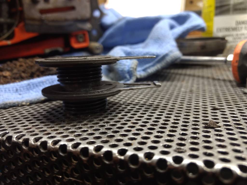

These ended up on the bench last night.

"Won't oil"
No kidding?!
Pile is what I scraped out that didn't blow off with air.
That’s one of the negatives about inboard clutch saws and almost no one cleans them out like they should be regularly. That gunk holds in heat too.
Yeah, tree service saw I sold them a couple months ago, was a total rebuild and spotless when they got it.
576 has the "vented" drum so a quick shot of air at some point could have prevented this. Hard to tell from pics but most of the debris is dirt. Must have been stumping with it, would also explain the brand new bar and chain. [emoji6]
