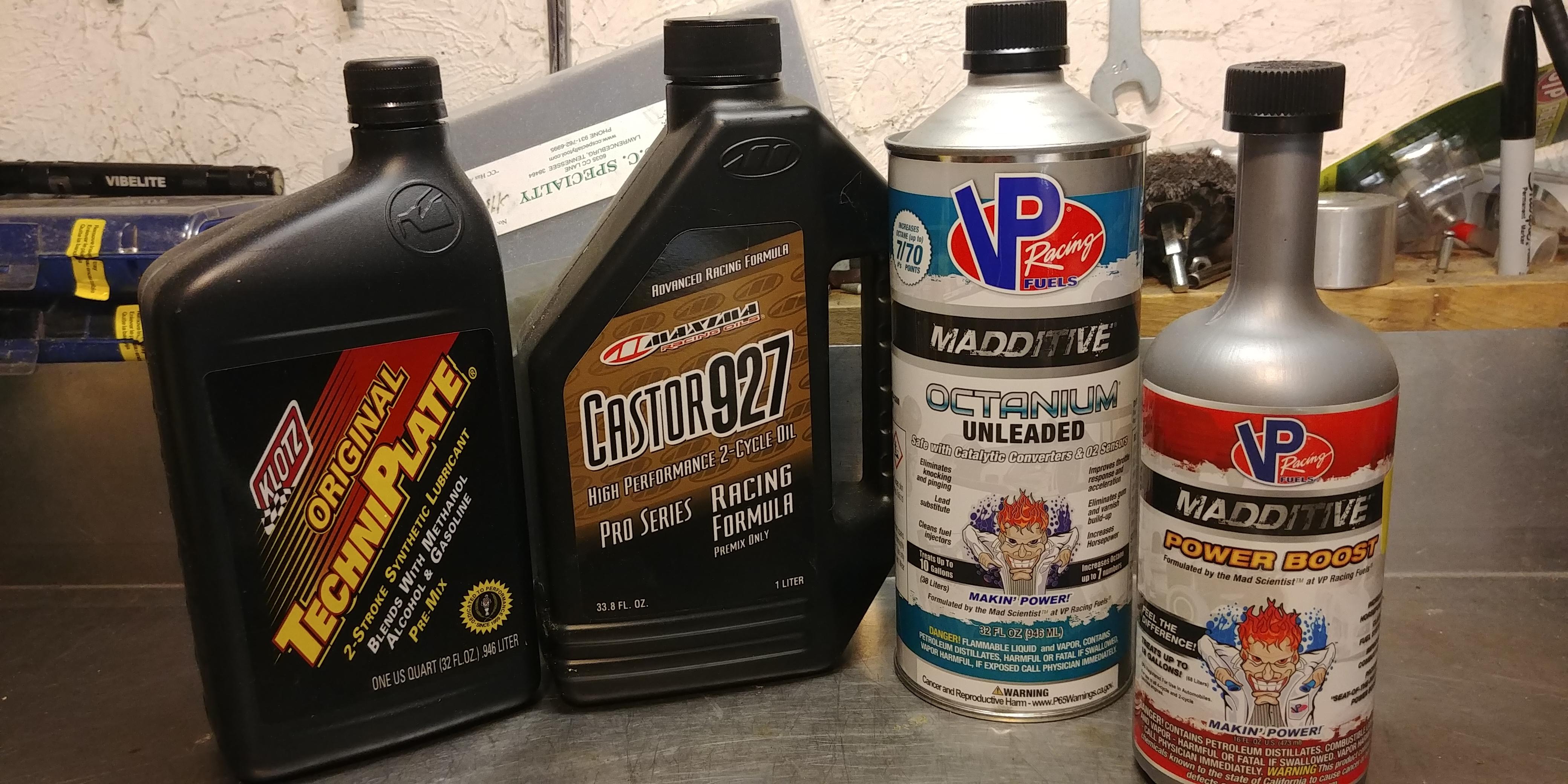

It was oxygenated 110 octane stuff with alcohol in it. That was the only explanation I could find after tear down and then losing compression. Maybe 2 weeks of sitting between uses. Neither were acting like they were tuned lean and one was 1500 under spec milling and the other was auto tune
That makes sense K2 won't mix well with much alcohol, I had a similar thing happen with R50, it too doesn't like alcohol. When I start playing with funny fuel I use 927 or Klotz original techniplate. Had some fuel from Ed Herd that would only stay mixed long enough to make a few cuts, it didn't like the sunlight too much, lots of oxygen in that mix. Few other things I've played around with not in the pic[emoji6], some of it works some makes you slower as you know, and you have to find the right balance.
