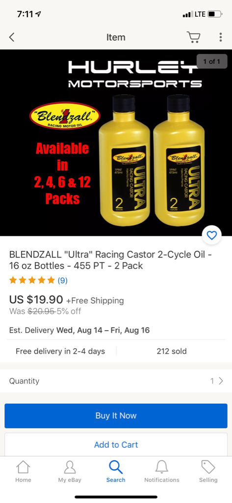

Any thoughts on this stuff at 32:1 in lawn boys?
