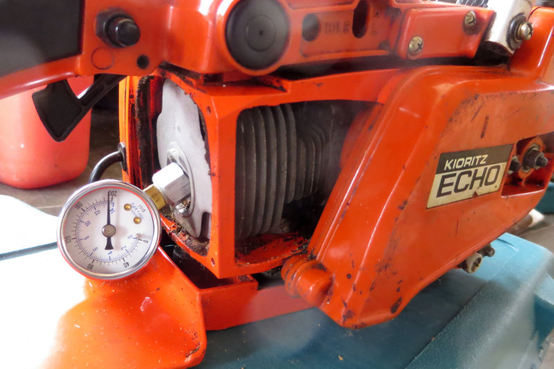

Cranking pressure is pretty meaningless. The calculated compression ratios of even the wildest saws is pretty low.
Unless you have a detonation counter its hard to know if your actually detonating unless its pretty severe. I am a believer that most seizures are causes by detonation that is set in motion by a lean mixture.
Also keep in mind that the combustion chambers of saws are very crude and really limit swirling. The squish clearance in and of itself on many would render even a properly designed chambers ineffective.
I doubt any of us will need a detonation detector to figure out this picture.
The swirling on a 2 stroke starts long before the mix reaches the chamber. Unlike most petrol engines that folks try to describe of as being a pump, a 2 stroke engine actually IS a pump. It pumps the mixture around the case, through the transfers, and then in to the combustion chamber, and this after sucking it in through the intake. No other petrol engine swirls the mixture remotely as much before combustion. A chainsaw is basically supercharged by design.
...if popping (or 4 stroking) out of the cut is in fact detonating
00wyk
5:08 PM
4606
Nov 16, 2017
1,616
9,232
Ireland
Timing advanced too much?
Way too much. Nearly half the keyway. It was a pretty cool day, so it took a while to warm up. But once that thing did, it detonated readily. Pulled it back to 33% or so, and it was fine. Compression on that saw was..uh...lemme find it here... 195psi. But that gauge was always about 8-10 psi on the high side as it has no hose.
