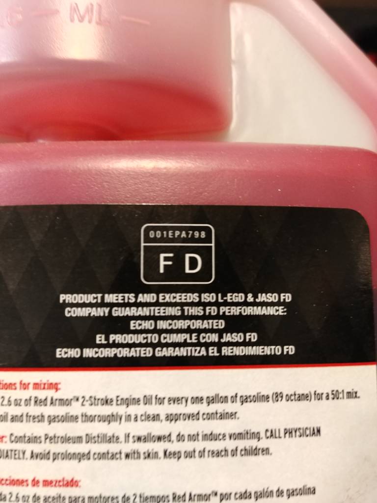

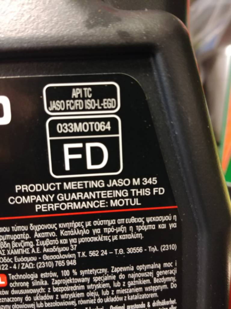

Well I looked all over that Husqvarna XP oil bottle and no sign of any certifacation number.
Only says meets and exceeds JASO FC/FB and API TC. (Sounds like a claim to me)
Along with Redline claiming it's suitable for applications calling for JASO FC and API TC.
Stihl Premium bottle has no mention of JASO but claims it's API TC .
You claim API TC has been extinct since the 1980s:D
But here we have it still as a reference on these 3 different products.
The logo I have 44 years experience with is the Castrol logo on the Stihl Premium bottle. Actually from 1974 to 1980 my mix was Castrol Super 2 Stroke. Started using Stihl Premium Castrol mix in 1980.
Ran the extinct API TC Stihl Premium Castrol mix for 26 years in my 066 Mag and I can show you pics of its P/C from this year still in excellent condition.
So there we go , I like to see some of these certification #'s.
Here you go. This emblem cannot be used on oils that have not passed the test, and you can see the accompanying numbers. The test can be quite expensive for smaller companies, which is often times why they don't have this emblem, this doesn't necessarily mean a particular oil wouldn't pass the test.

Interesting, so API TC is not extinct
What manufacturer is that black bottle in Russian?

It has multiple languages on the information label. And if you read carefully you will see the manufacturer is Motul.
API-TC it's not extinct, just mostly irrelevant.
