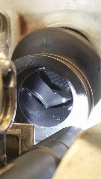

Ben have you ever had experience with Klotz KL198 lite?
Been out since 2003 or around there. Folks say it is like 5wt oil thin wise.
I bet that 661 was all over the place with carb trying to tune with those washers in the intake.
No oil related problems I see there.
Lot of grit of some kind but from where?

Do all these intake boots fail or some?
Mine appears to act normal even with the older coil
Sent from my non internal combustion device.
I put the new coil on it and it didn't run as good. Your boot doesn't have anything in it.
