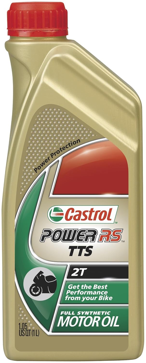

What about Castrol Power RS TTS 2T? I can get it for $14 per liter.
http://www.castrol.com/en_us/united-states/motorcycle-oil/2-stroke-engine-oil/power-rs-tts.html
http://msdspds.castrol.com/bpglis/F...00536DBB/$File/Castrol_Power_RS_TTS_12899.pdf
