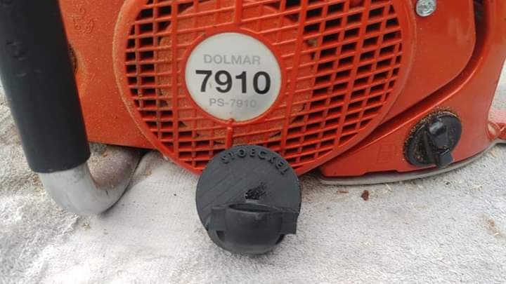

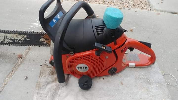

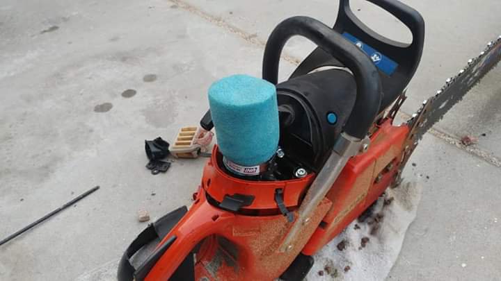

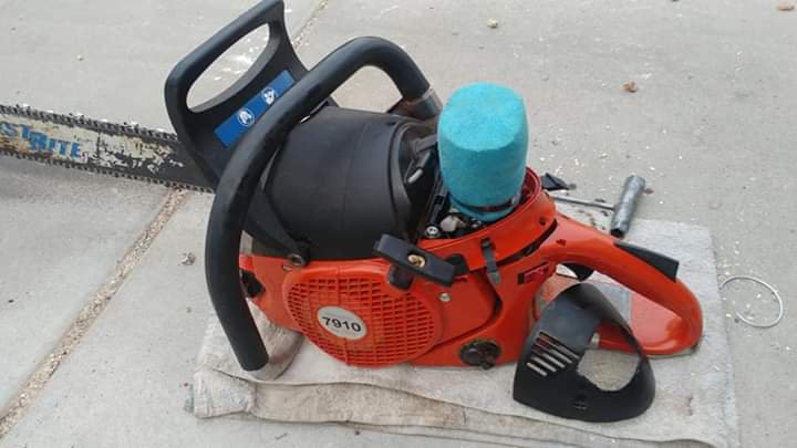

Dolmar 6400 7900 stack is now done.
3120 stack is now done
Working on the 346 etc vstack adapter.

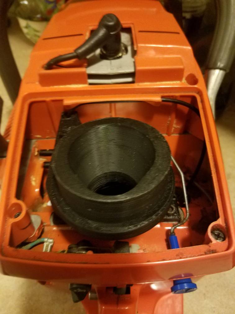

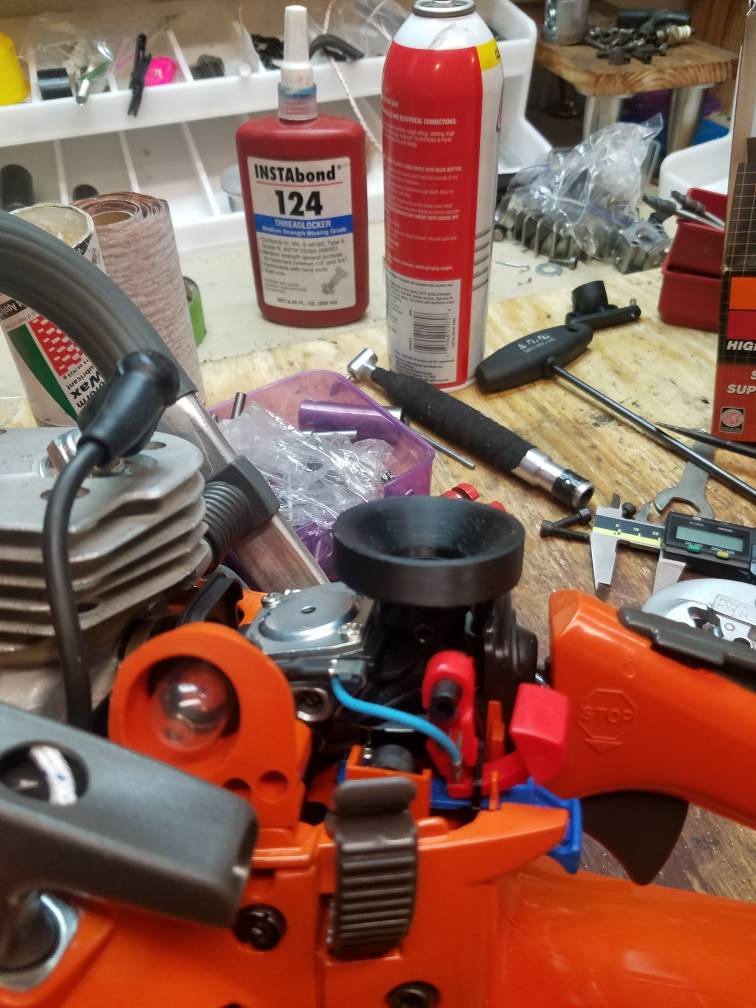

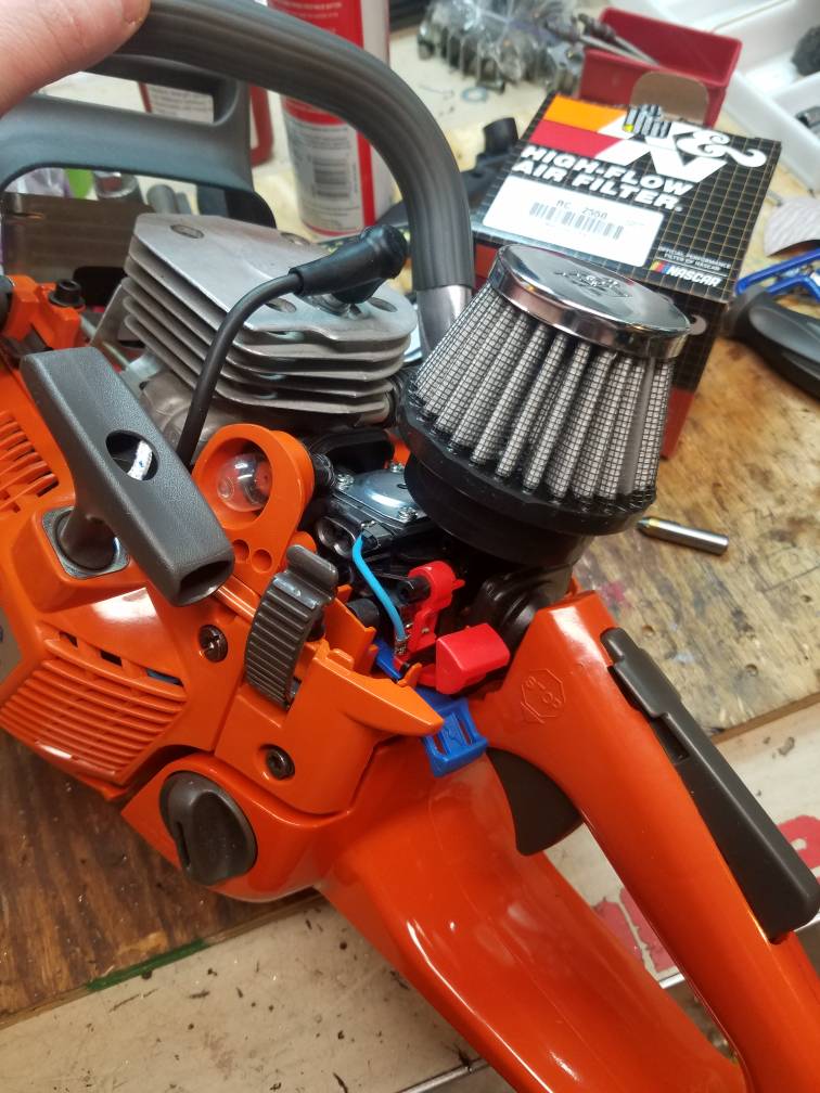

I was going to run a batch of mine here shortly. I havent posted any images of actual parts yet because I have revised the design. I am going to run mine in black delrin and it will fit a K&N RU2550 or RC2550. They drop into the HD housing with no mods and fit under the cover.
I want to get through testing before I post it up.

Ddave has aluminum vstacks that will fit, I think.
Downside is there is no choke function.
He did...
Only listing 088 and large husky in his eBay store. Nothing for 024-066.
I found this on eBay. But, I don’t think the carb studs are long enough to get the nut on.
https://rover.ebay.com/rover/0/0/0?mpre=https://www.ebay.com/ulk/itm/123555882202
Found this too. I think it would mount, but no choke.
https://rover.ebay.com/rover/0/0/0?mpre=https://www.ebay.com/ulk/itm/273663215773
