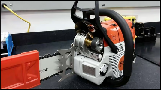

If you are looking for something with more torque vs. RPMs then you might want to look at some older chainsaws like McCullochs, some of those 70 to 80+cc saws top out at 6,000 RPM but have quite a bit of torque. You might be able to pick up a running one for a couple of hundred dollars and then modify it for your needs. That might help you with that part.
There is a Stihl Jet Powered chainsaw (one off):
That felling spike looks like a 2nd-grader's art project...
How amazing! I didn’t realize something like that existed.
