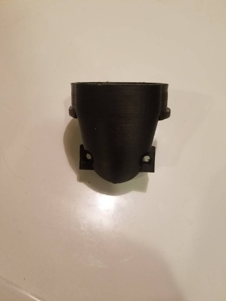

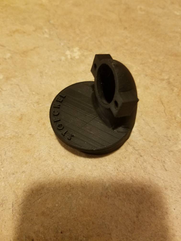

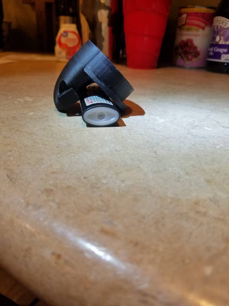

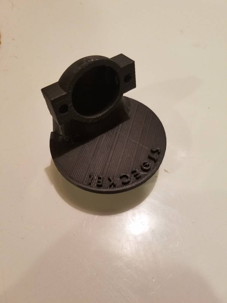

Sweet. Your first link there is what I was going to try to copy for 026/ms260. Would also work on others.
My brother in law wants a setup for his 028, so im thinking about giving it a try sometime.
That 2nd link you posted looks like a nicely made vstack. Very attractive price!!
