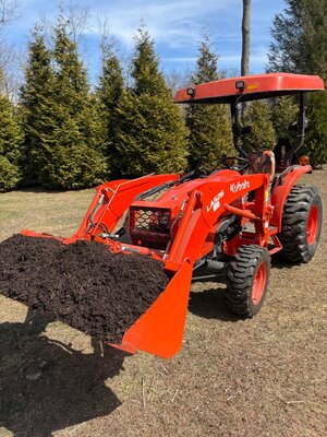

Depending on what your budget is, I highly recommend the flat floored Kubotas. I have a smaller one, but prefer it over the standard models of similar power. (flat floor, hydro steering, quiet hst, quick adjust lower links, cylinder 3pt lift, and a few other niceties) They do draw a bit of a premium.
Why do I freakout over a flat area below operator? I'm on and off the seat quite a bit at times (opening/closing gates, hitching/unhitching logs). Easier to step off/on than 'climb' in/out of. Little things make use more pleasant/efficient for me.
