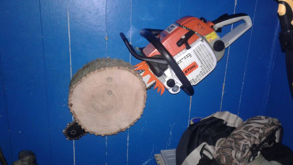

Heres me 038 on display with her new spikes.
