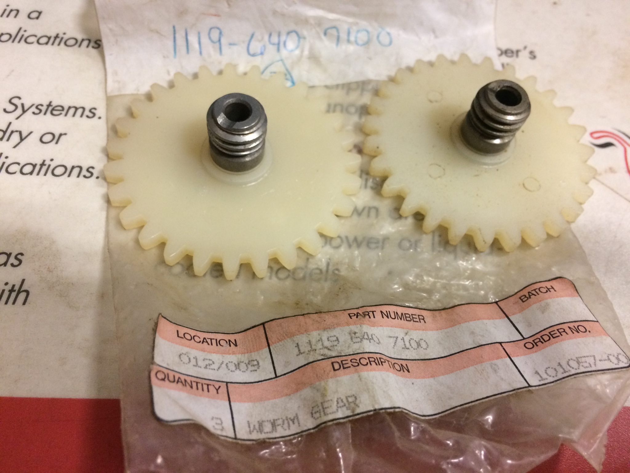

You talking about this one
Why yes I am. Does the oiler itself have a metal gear as well inside? The plastic worm gear inside the oiler is flat and wiped out. Just didn't know if the plastic gear can be swapped out for a metal one.

On that 028,it has the same oiler as an 038 series,042 and 048 .The driven gear is the same,the drive gear could be different depending on the drive system--spur ,rim or replaceable spur .The pump gear as far as I've seen is steel .I've never seen an OEM driven gear with a plastic worm .
With as many aftermarket parts these days a plastic gear wouldn't be out of the question .
