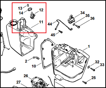

Hi fellas,first time posting in this sticky.I've got an 045 AV Super that just died on my son yesterday - no spark.I suspect it's the switch because it'd been acting funny.The first time I had the saw running a few yrs.back,I went to shut it off & got knocked on my keister.Yesterday we fired it up to go out cutting & it didn't want to shut off.we had to toggle it back & forth & then it shut off.I talked with a guy who runs a local saw shop & he said he worked on an 045 recently & he had to tear the saw down completely just to change the switch.Is there any truth to this? I have a new switch for it,how big of a job is there to changing it out?Seems to me that the top cover comes off & it'll expose the switch.I noticed that the top cover is incorporated into the rear handle.Thanks for any & all input.
Yes, that is what it looks like to me, remove the top cover and then you will have access to the switch (though not 100% sure that the choke lever may be in the way).
The top cover/handle are all one part, just takes a few screws to remove it, possibly need to remove the front handle first.

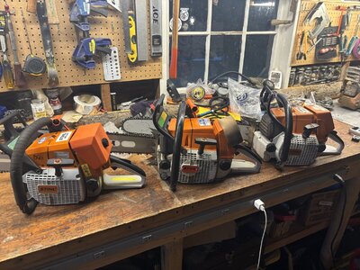

Compared some “working weights” of a few saws just now. Tanks full.
Stock flat top 066 1/2 wrap with 25” rollomatic es b/c: 22.8lbs
064 with 25” Sugi, full wrap, base plate, bare maxflo and scrench holder: 21.4lbs
440/460 hybrid with 28” Tsumura, full wrap, west coast cover, and full maxflo kit: 20.4lbs
