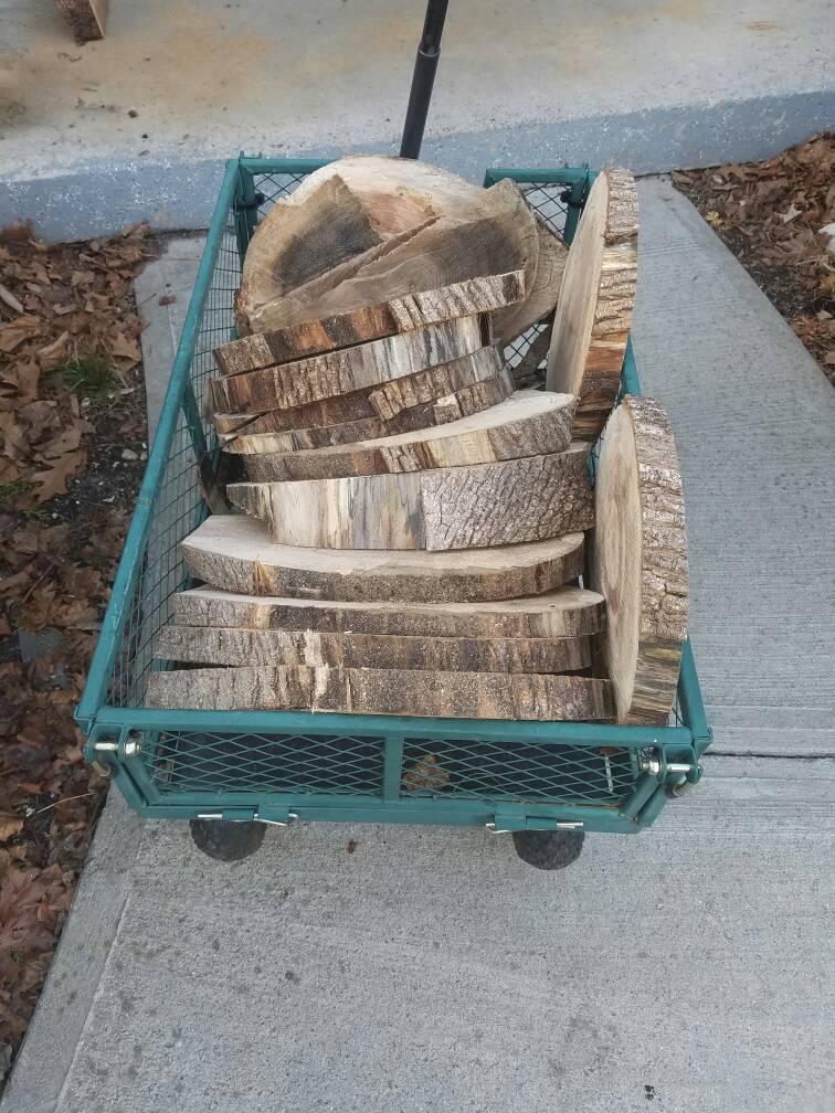

I cut up these today. Ran pretty good for stock.

Lol. All I had left. I am going to try and advance the timing and see how it runs. With just a DP muffler, timing advance and retune. Then go from there.
