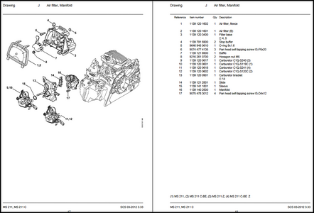

Put an adjustable carb on my ms180 off a 211 or whatever it is that's a size bigger and adjustable. Revving it out of a cut when the H jet is lean it'll bog at WOT, not over accelerate. Tunes out like it should. Why does it do that?

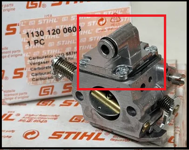

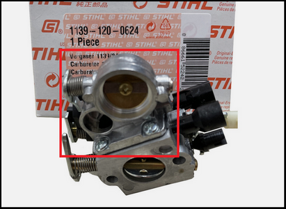

Can't remember if it needed swapped or not, but the one on the right is what's on there. Never seen the left one.
Should be the 021/23/25 ms 250 carb that you used to make a ms 170-180 adjustable
Cool, a quick look shows that the MS 210 also used that carb so maybe that is where the MS 211 confusion comes in here. The 250 carb looks closer to a direct swap version (more so than the 211 carb)!
